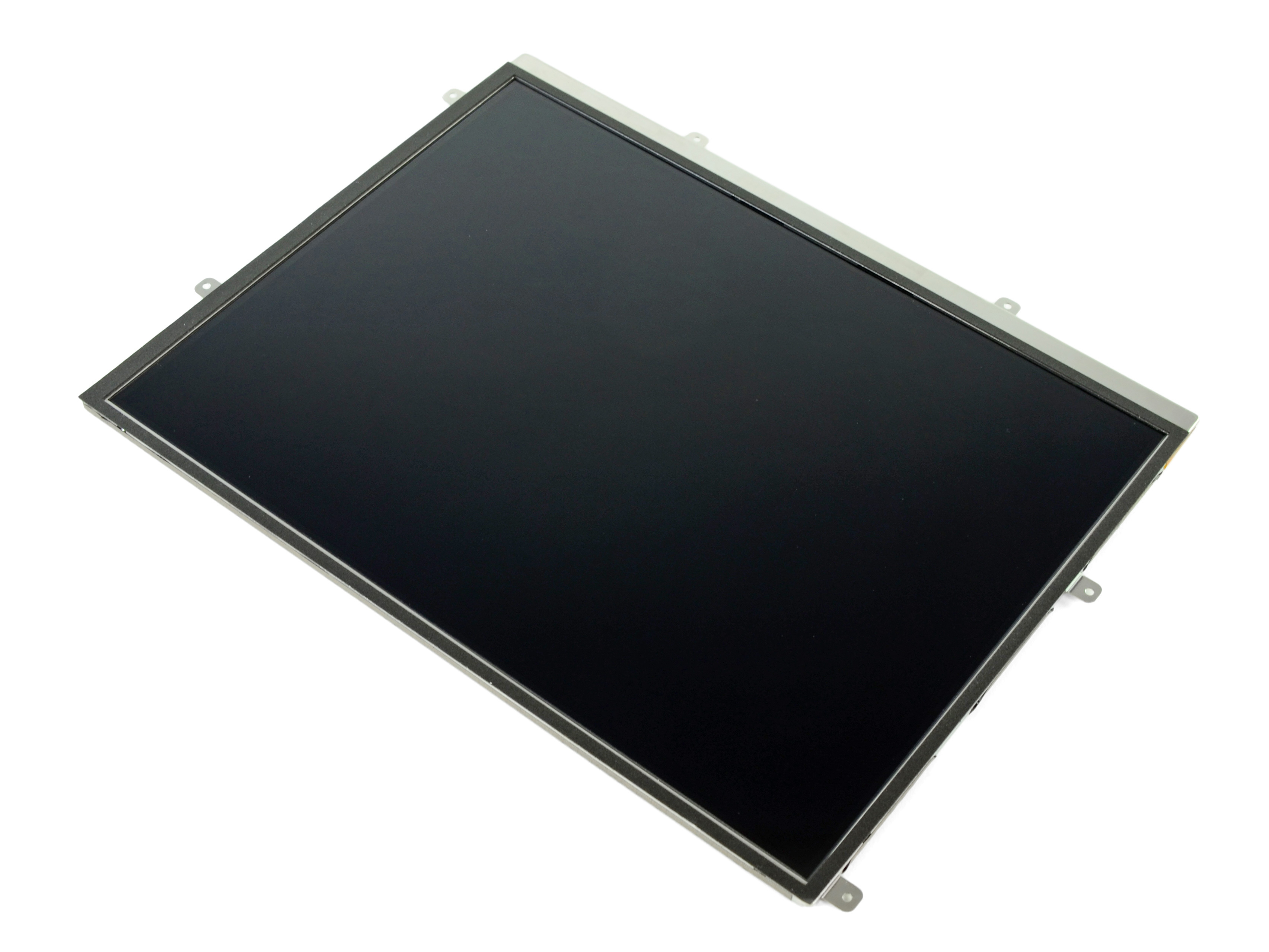

Use this guide to replace a broken LCD.
In the following steps, you will use a metal spudger to lift the front panel out from the rear case of your TouchPad.
Remove the six 2.2 mm Phillips screws securing the LCD to the front panel.
Use the edge of a plastic opening tool to peel up the self-adhesive pull tab stuck to the display data cable.
