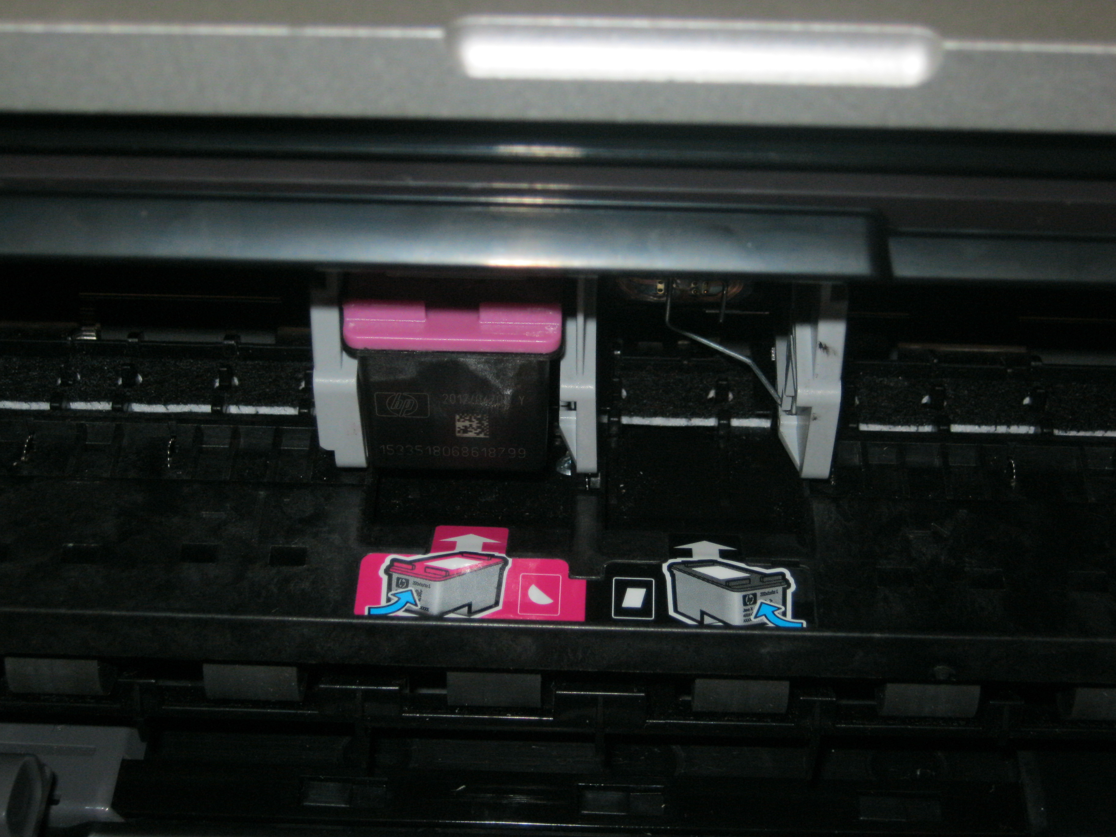

  • Turn on the printer and open up the ink access cover on the front of the printer.
Image #1

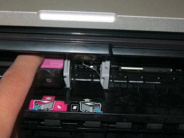

  • Lightly push down on the top of the ink. This should make it come out easily.
  • Be advised that there is a 'key' or groove to stop you installing new cartridges back incorrectly.
Image #1 Image #2 Image #3

  • Now, with the old ink cartridge removed from the printer, push the new cartridge in with the key on the cartridge orientated on the right hand side, otherwise it won't fit correctly.
Image #1
