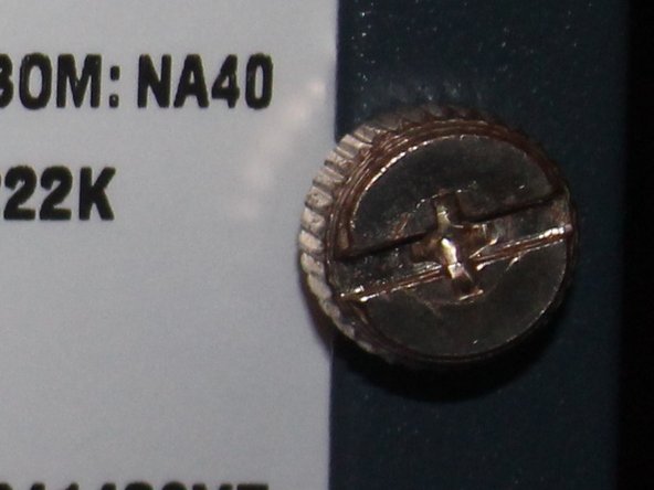

  • When the computer is off, remove the side panel from the computer by undoing the two thumb screws and remove the cover.
  • If the panel does not come off with the thumbscrews, use the Phillips #1 screwdriver in the screw slot on the thumbscrew

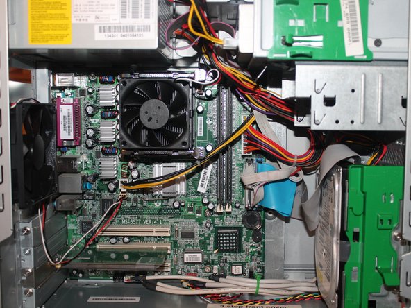

  • After you open the cover, you might see a nice amount of dust after all these years, so now is the time to clean it.
  • To do this take an air compressor, or canned air and spray simply blow the dust out with this OUTSIDE.
  • If you see dust in the heatsink, I'll discuss cleaning this too.
  • Hold the fan blades down if possible, overspinning the fans can wear them out prematurely.

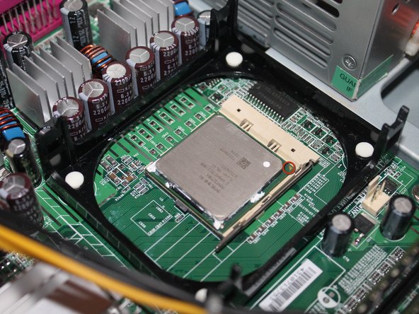

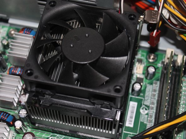

  • Now that the computer is cleaned out, it's time to remove the heatsink.
  • On the mPGA 478 computers, there is 2 clips that hold the heatsink on, simply bend the tab up on the clips and twist the heatsink wile removing the heatsink without pulling the CPU with it.

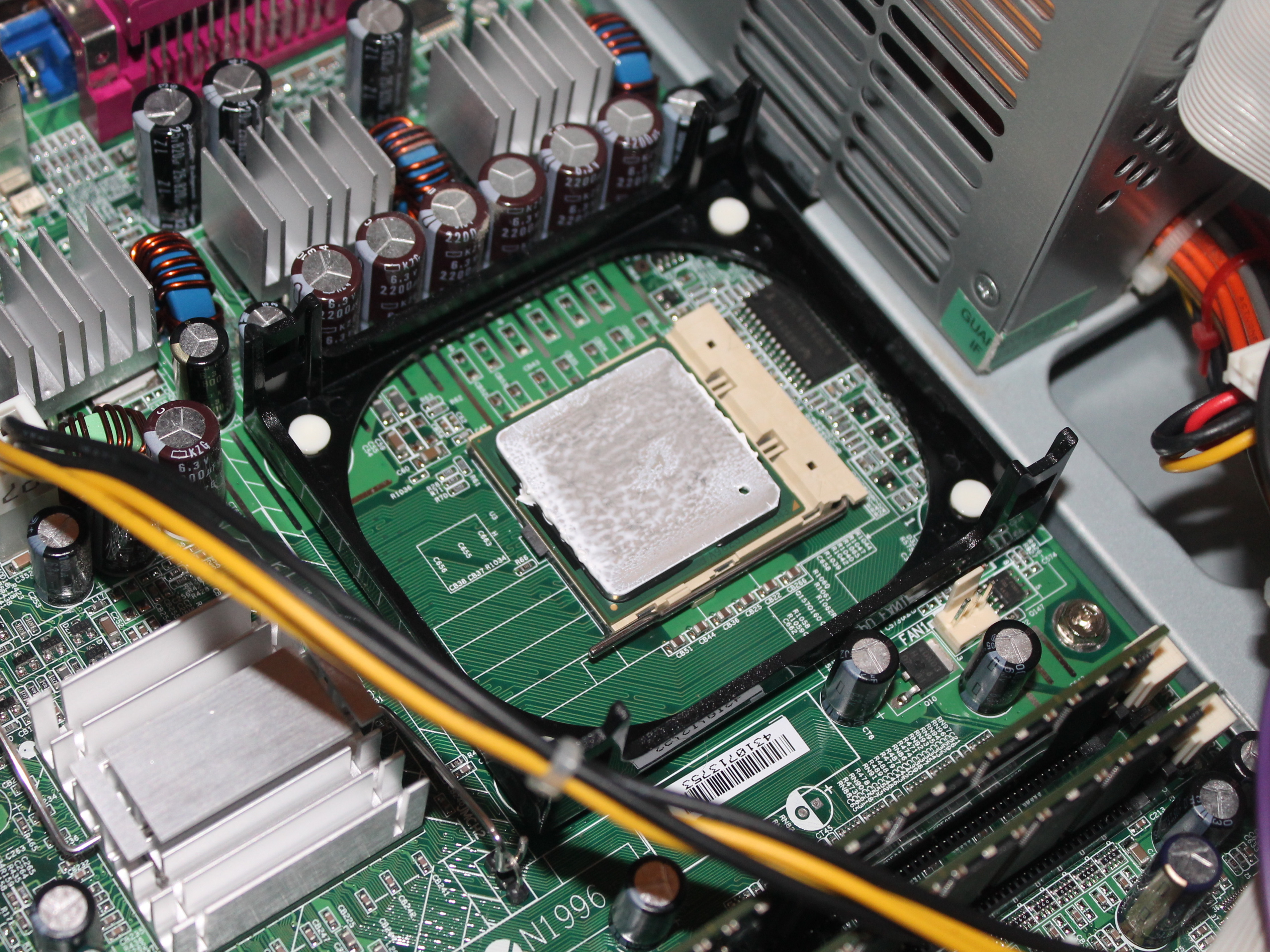

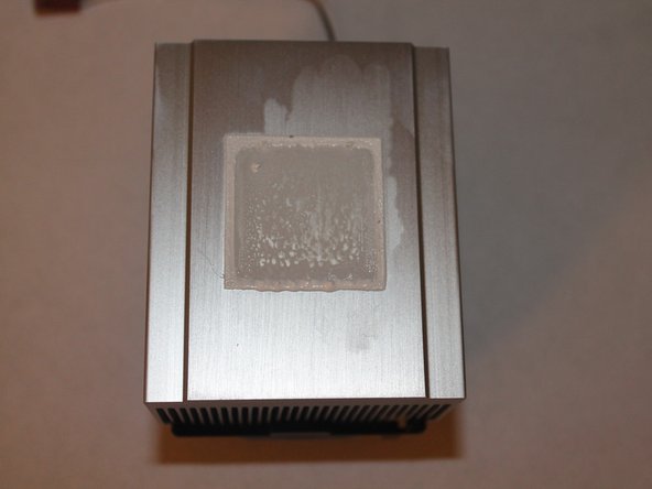

  • With the clips off, remove the heatsink by wiggling it off slowly, the thermal paste should come loose.
  • If you have trouble, replace the clips and run the computer for 15 minutes to make this easier, this will warm the thermal paste up and make it easier to remove the heatsink. Don't run it any longer to be on the safe side.
  • If the CPU sticks as it does in some cases, simply take a small screwdriver to the side of the CPU, but be careful not to drop or let the screwdriver hit the CPU, or you will bend pins!

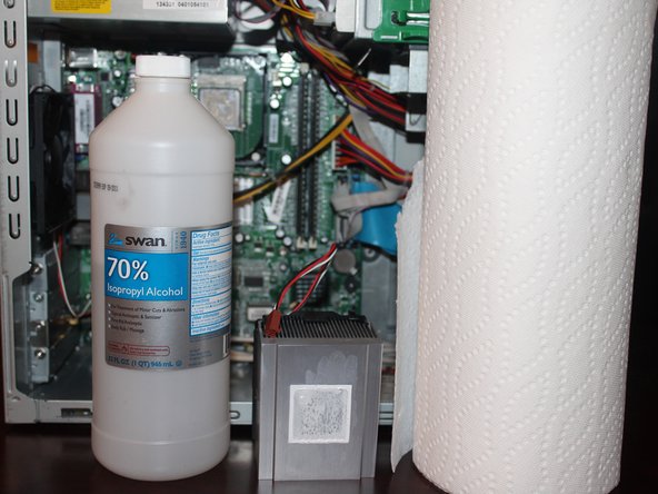

  • Clean the heatsink by rubbing the heatsink with rubbing alcohol.
  • Fold a napkin and put it over the top of the bottle of rubbing alcohol, and as soon as you get enough, lift the bottle and put the cap on, put the alcohol aside.
  • Get a whole roll of napkins, you may need a few napkins; I needed 4 to 5 for cleaning the hatsink alone.
Image #1 Image #2 Image #3

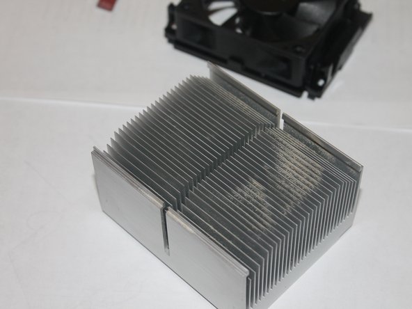

Add Note Edit Step 6  ¶

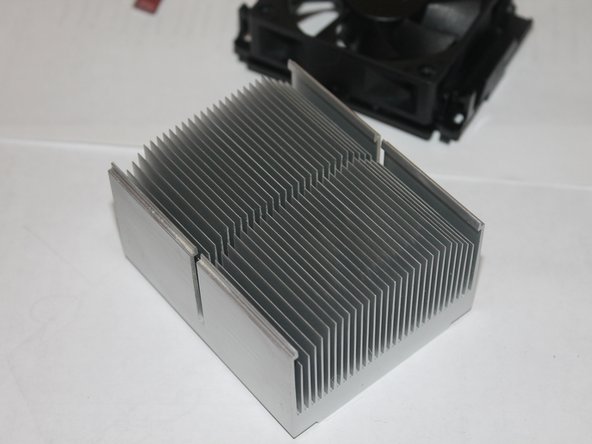

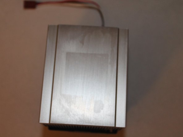

  • Now that the heatsink is out, it's time to clean it up.
  • First have the heatsink on an actual surface where it won't scratch the bottom of the heatsink.
  • Now take the fan bracket off the heatsink sticking a flathead screwdriver or other flat tool to remove the fan bracket.(I only had a screwdriver handy for this)
  • Use a paintbrush through the fins to the heatsink to clean any dust, but do this away from running computers.
  • You may have to clean the dust from the fan with a paintbrush, no need to remove the fan to clean it

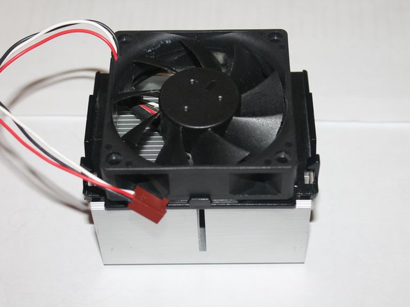

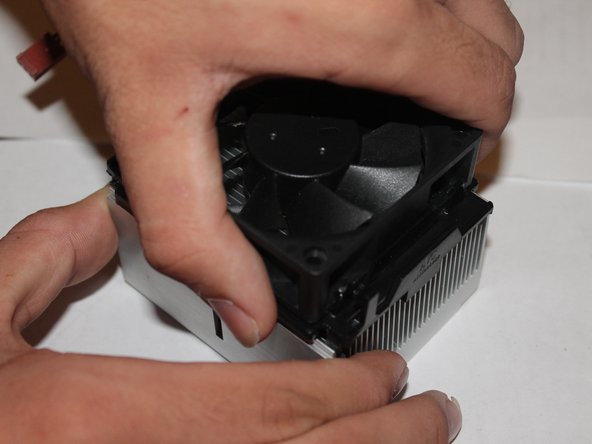

  • Now to replace the fan on the heatsink.
  • First, angle the fan bracket at a 45 degree angle from the back of how you have the heatsink.
  • Push it down till you can push the whole thing down and it should be secure.

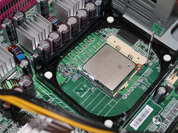

  • Now that that is done, it's time to replace the processor in the computer.
  • you will want to take note of how the processor went in so you replace it properly, if not installed properly, pins will bend and it is useless.
  • Lift the lever holding the CPU and remove the CPU, and lift out, this can be any color or material, it depends on the socket.
  • Replace the CPU with the one you chose, putting it in the way the arrow is pointing.
