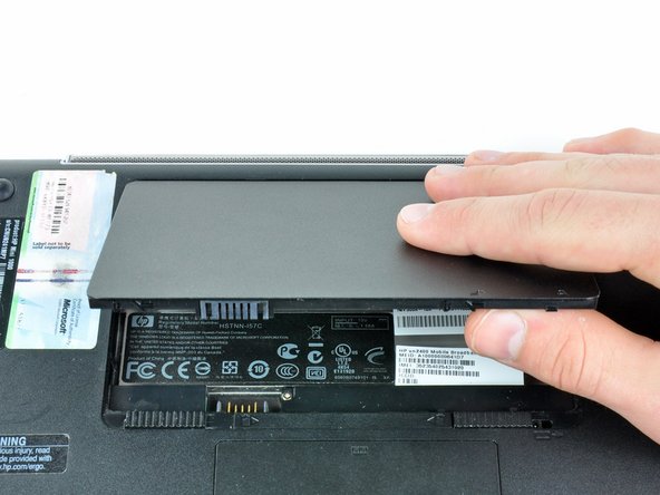

  • With the case closed, place the Mini 1000 top-side down on a flat surface.
  • Push both of the battery release latches toward each other.
Image #1
Add Note Edit Step 2  ¶
  • Lift the battery out of the Mini 1000 from the edge closest to the release latches.

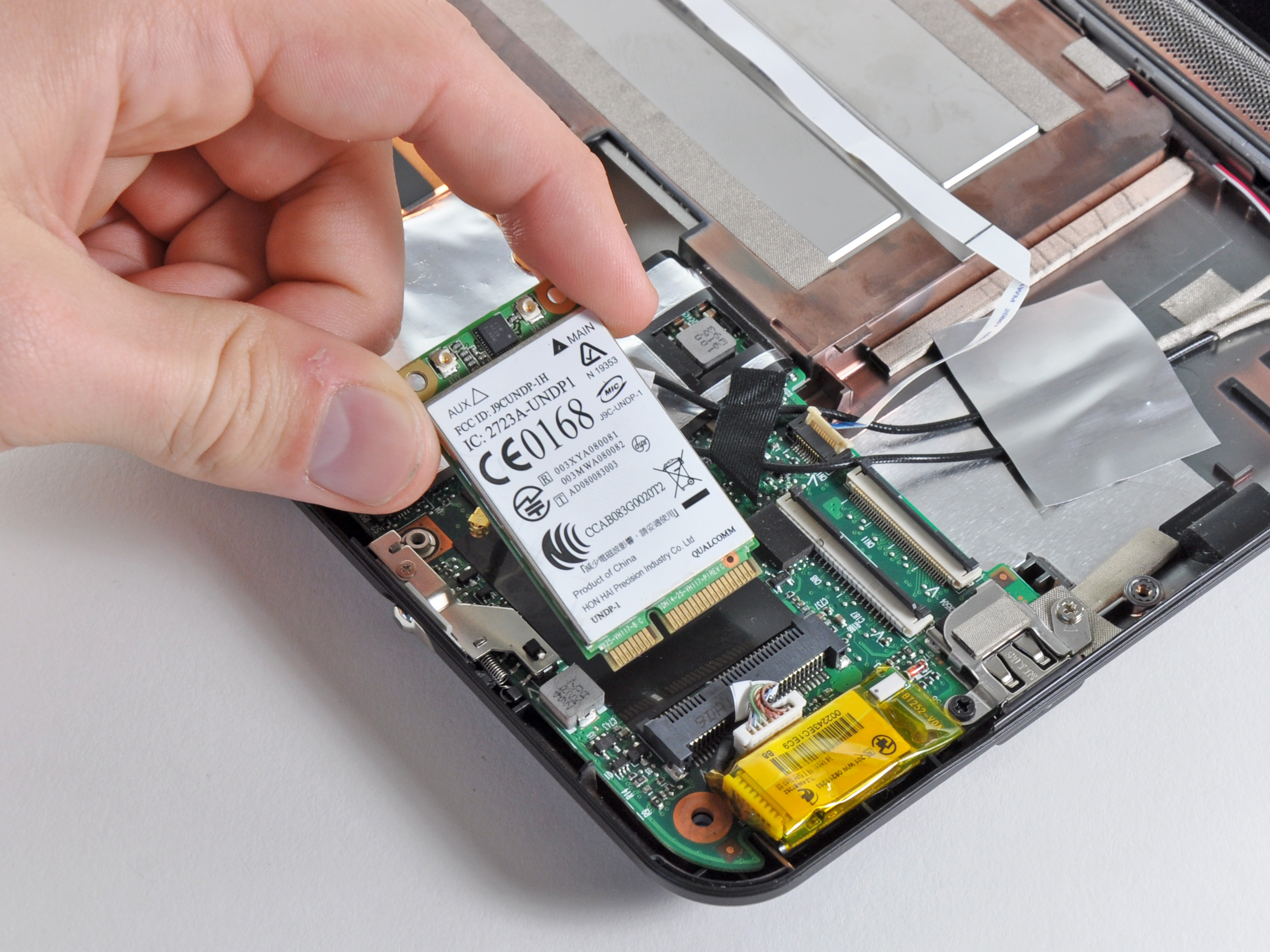

  • Use your fingernail or the flat end of a spudger to flip up the retaining flap on the keyboard cable ZIF socket.
  • Be sure you are prying up on the retaining flap, not the socket itself.
  • Pull the cable out of its socket and remove the keyboard.
Image #1 Image #2
Add Note Edit Step 7 — Hard Drive  ¶
  • Use your fingernail or the flat end of a spudger to flip up the retaining flap on the SIM card ribbon cable ZIF socket.
  • Pull the SIM card ribbon cable out of its socket and peel it off the top of the hard drive enclosure.
Image #1
Add Note Edit Step 8  ¶
  • Use your fingernail or the flat end of a spudger to flip up the retaining flap on the hard drive cable ZIF socket.
