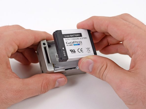

Add Note Edit Step 2 — Battery  ¶
  • Slide a plastic opening tool between the battery and the rear case.
  • Gently pry the battery up and out of the rear case.
Image #1
Add Note Edit Step 3  ¶
  • Remove the battery from the case.

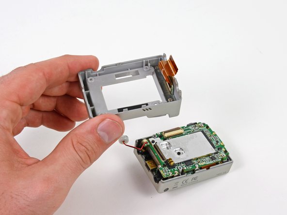

Add Note Edit Step 6  ¶
  • Grasp the rear case and lift it off of the front case.
  • Do not try to completely remove the rear case yet, as it is still attached by the display port ribbon cable.

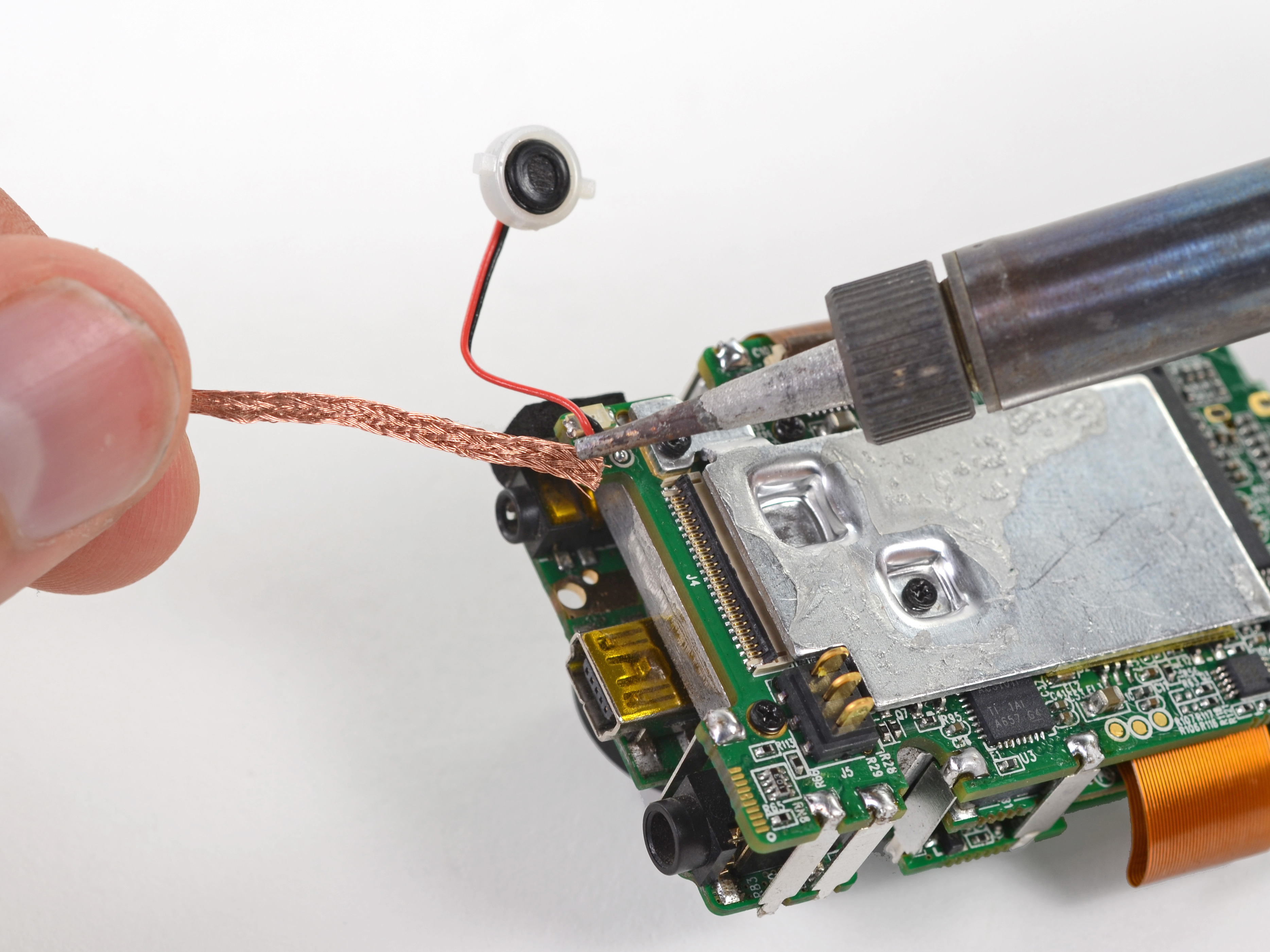

Add Note Edit Step 7  ¶
  • Using a plastic opening tool or your fingernail, flip up the locking tab on the SD board ribbon cable ZIF connector on the motherboard assembly.
    • Be careful that you are prying on the locking tab, and not the connector itself.
  • Use a pair of tweezers to remove the SD board ribbon cable from its connector on the motherboard.
Image #1 Image #2 Image #3

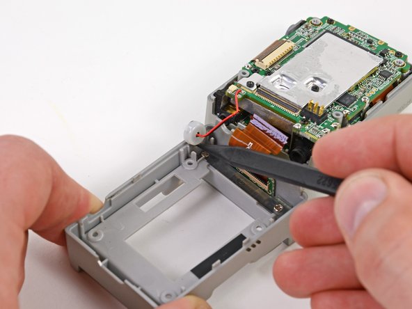

Add Note Edit Step 8  ¶
  • Lift the speaker out of the rear case with the tip of a spudger.
  • Remove the rear case.
