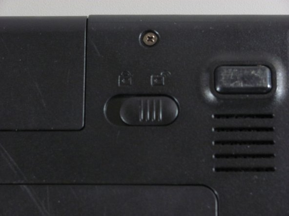

  • Move the latch to unlock the battery
Image #1
Add Note Edit Step 2  ¶
  • Slide the battery latch and pull out the battery as shown.
  • The battery latch needs to be held in position to be able to remove the battery.

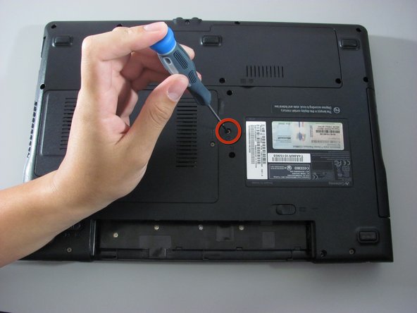

  • Unscrew the indicated 5.9 mm Philips screw.

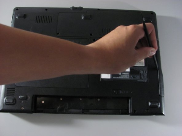

  • Use the spudger to pry out the Disk dive.

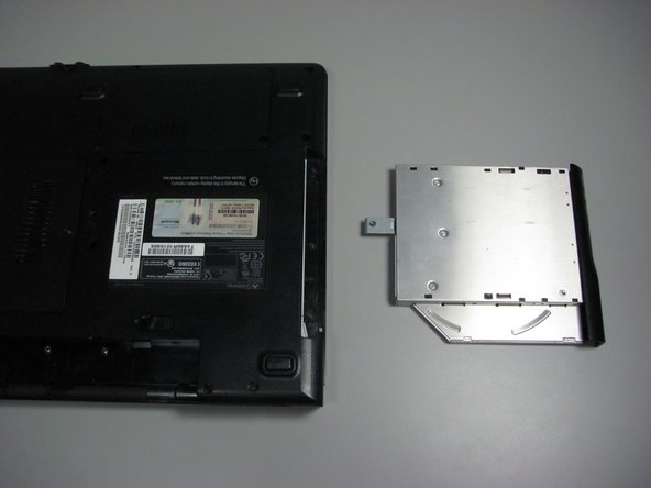

  • Disk drive should easily detach and can now be replaced.
