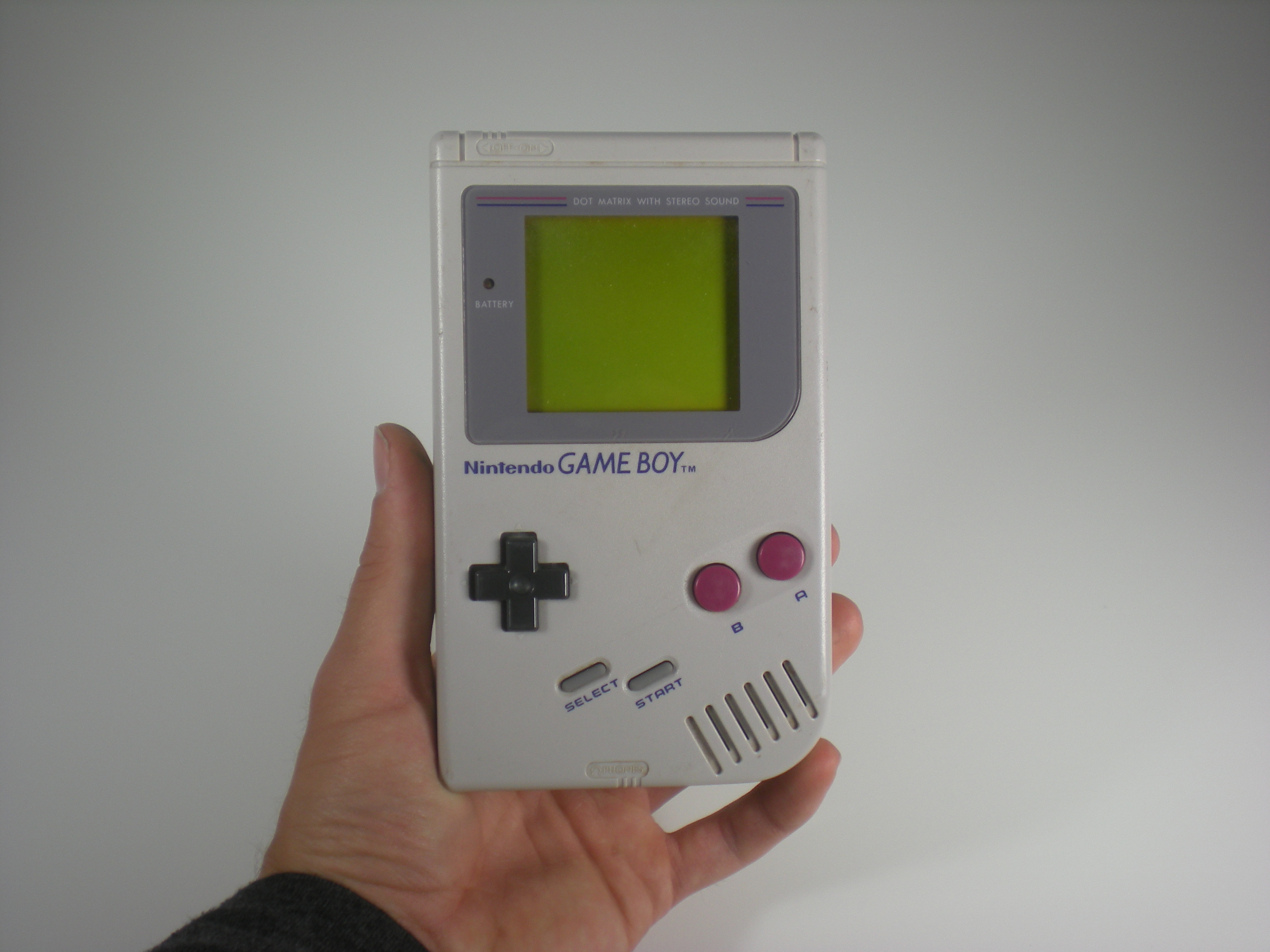

How to install a new Game Boy screen.
  • Author: Andrew Tramposch
  • Time required: 30 to 60 Minutes
  • Difficulty: Very difficult
How to install a replacement Game Boy black and white LCD screen.
Image #1
Add Note Edit Step 1 — Outer Case  ¶
  • Remove the 6 screws on the back of the Game Boy system with a #00 Phillips Screw Driver.
    • Some Game Boys may have tri-wing screws securing the back case, rather than Phillips.
  • Place these screws in a safe place.
  • Be careful with these screws as they are easy to strip, and if this happens, they are almost impossible to remove.
