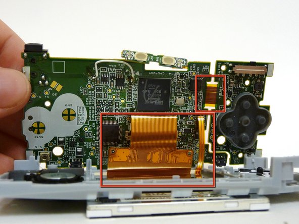

Image #1 Image #2 Image #3
Add Note Edit Step 13  ¶
  • The entire motherboard is now accessible.
  • Take extreme care when working with the motherboard to avoid damaging the device and its components.
  • A small ribbon cable connects the start and select buttons to the motherboard. It can rip very easily so, do not pull on it.
  • Lift the motherboard and front plastic cover assembly off of the front case.
  • Once the front case is removed, the plastic on/off switch will fall out of place.

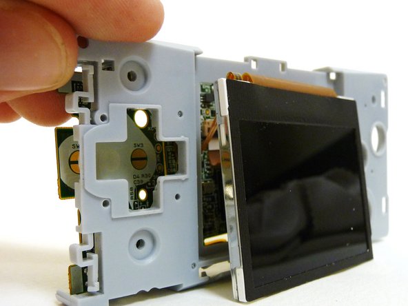

Add Note Edit Step 15  ¶
  • Without the front case, you will be left with the motherboard and the plastic mount. The LCD screen is attached to the motherboard by a ribbon and can fall off the plastic mount.
  • Using metal tweezers, grab the start/select board and slide it out gently.
Image #1 Image #2
Add Note Edit Step 16  ¶
  • Lift the entire motherboard assembly off the plastic guard.
  • Take caution not to damage any of the gold ribbon cables on the motherboard.
  • The LCD screen is the only thing connecting the motherboard and plastic guard.
