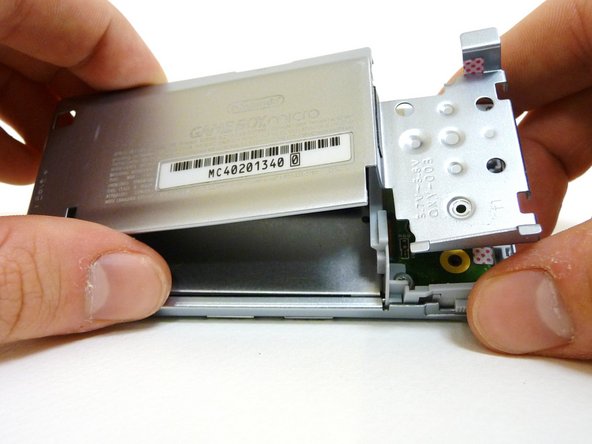

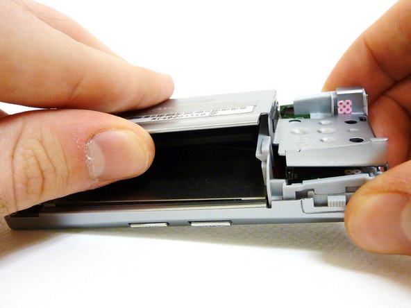

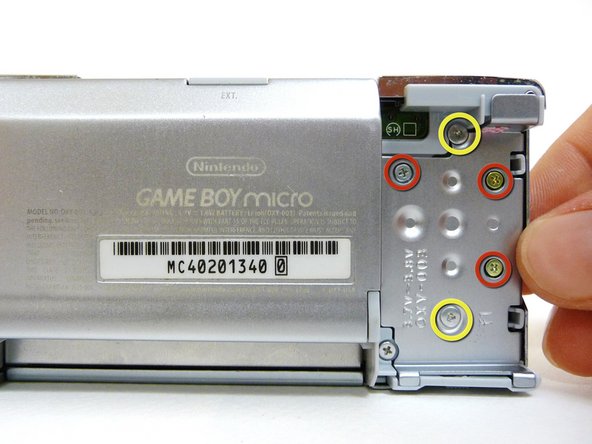

Add Note Edit Step 6 — Buttons  ¶
  • Remove two tri-wing screws on the top of the Game Boy and two more next to the volume/contrast switch.
Image #1 Image #2 Image #3
Add Note Edit Step 7  ¶
  • Remove the three Phillips #00 screws.
  • Remove the two tri-wing screws.
Add Note Edit Step 8  ¶
  • Lift the back cover off the Game Boy.
