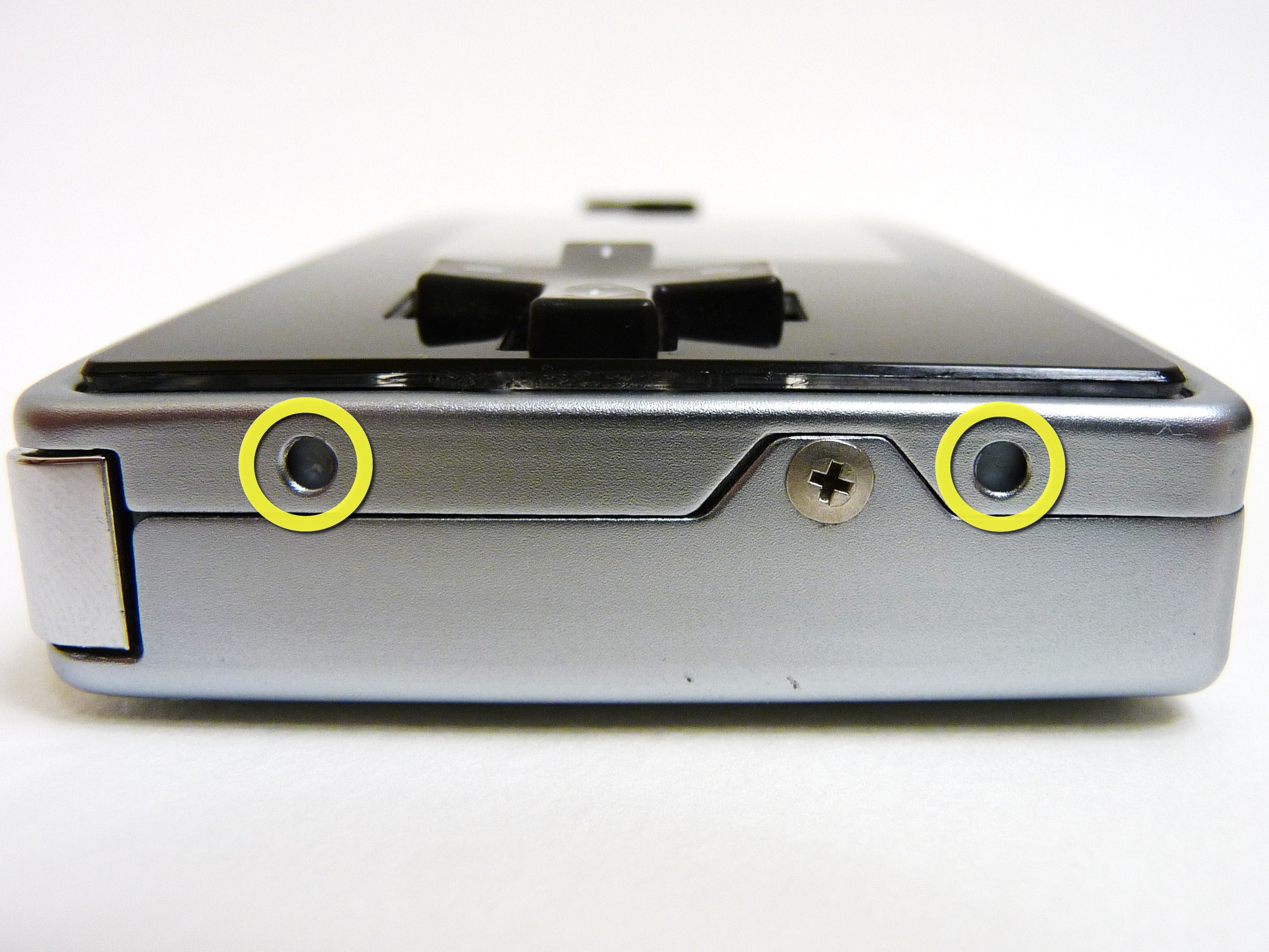

Use this guide to remove and change faceplates.
Tools
Image #1 Image #2
Add Note Edit Step 1 — Faceplate  ¶
  • Locate the two circular holes on the side of the Gameboy nearest to the directional pad.
Image #1 Image #2 Image #3
Add Note Edit Step 2  ¶
  • Straighten the end of a paper clip and push it into each of the circular holes.
  • You may hear a faint click afterwards.
  • Use the paper clip to lever the faceplate off from the unit.
