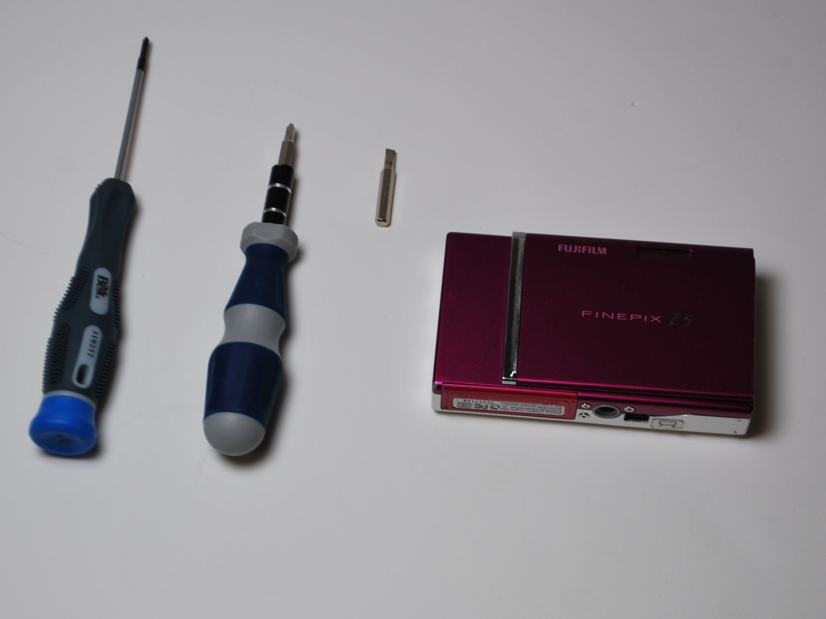

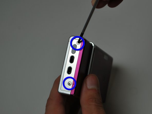

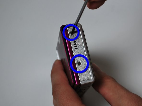

  • Remove the two screws on the right side of the camera and the two screws on the left side.
  • Use a small #00 Phillips flat head screwdriver.
  • Keep all the screws in a container and the two different types separate.

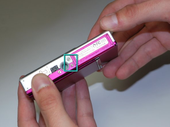

  • Remove the three screws from the bottom of the camera.
  • You need a three-prong screw driver for two of the three screws; keep these screws separate.

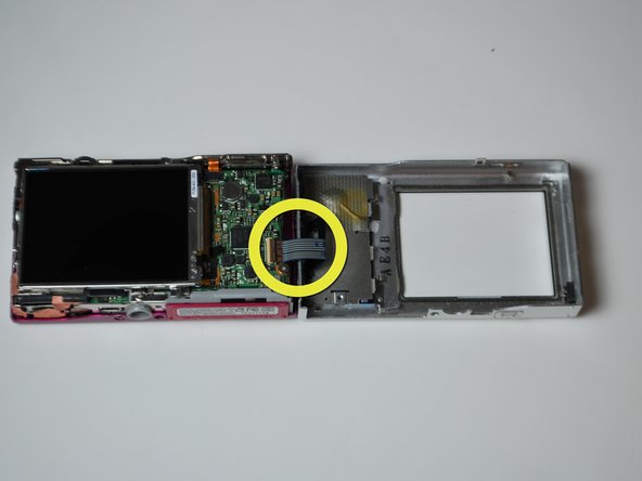

Add Note Edit Step 3  ¶
  • Remove the back of the camera by carefully flipping it open to the right side.
  • There will be a ribbon cable attaching the front panel to the motherboard, be sure not to tear this.
Image #1 Image #2

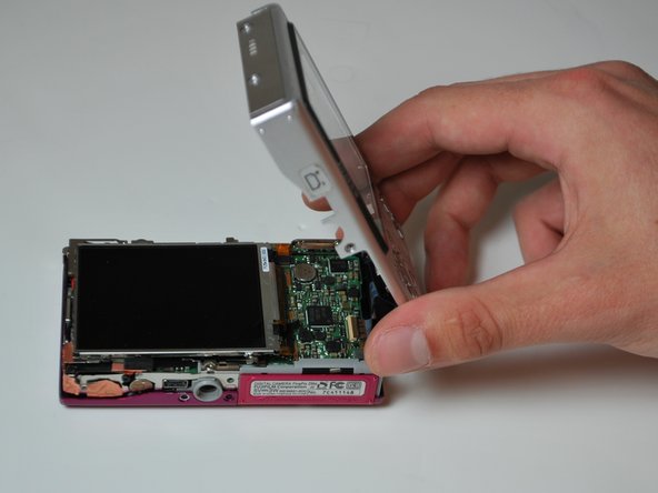

  • Pull the LCD screen to the left slightly, then lift and flip it open to the right.
  • There is also a ribbon cable attaching the LCD screen to the motherboard, be careful not to tear it.

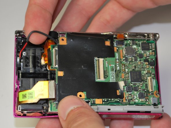

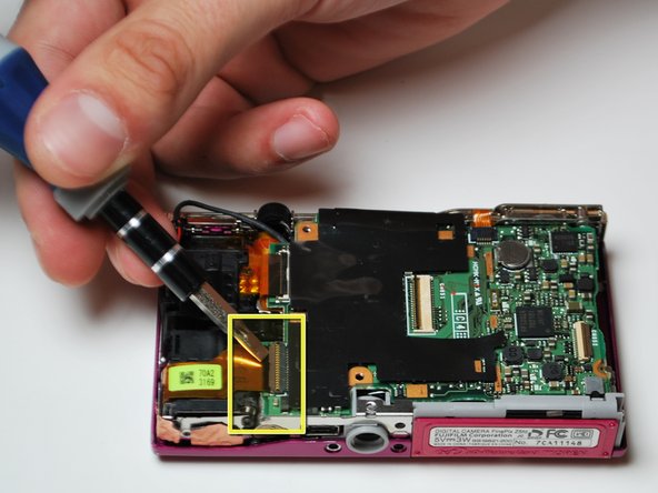

Add Note Edit Step 5  ¶

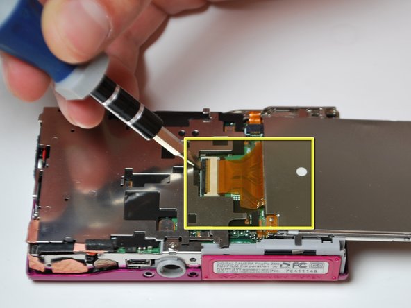

  • Using a plastic opening tool, flip open the black lever to release the ribbon cable.
  • Gently slide the cable out of the lock; the LCD screen is now free to be removed.

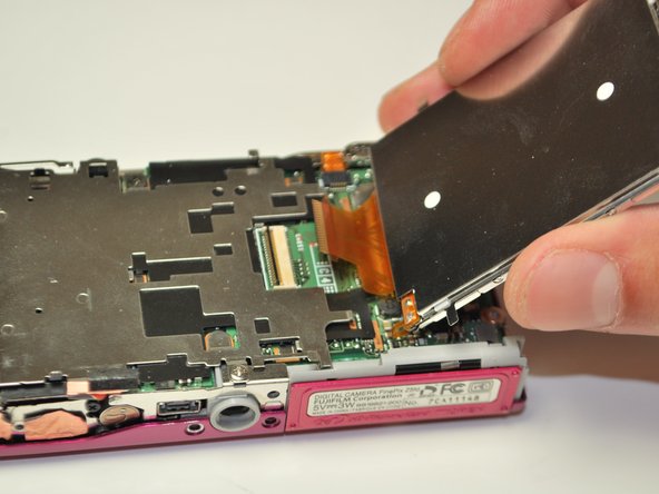

Add Note Edit Step 6  ¶

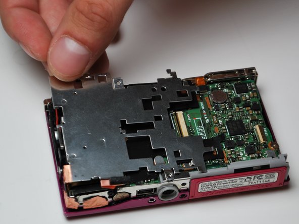

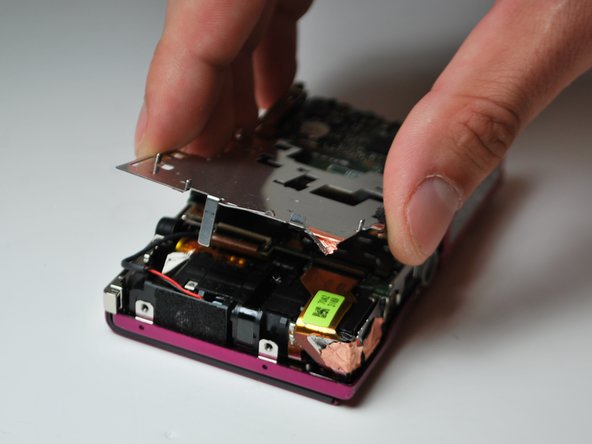

  • Remove the two screws that are holding the silver paneling on.
  • There is a gold ribbon cable which will tear upon removal of the silver paneling, this is normal.
  • Remove the screw on the right side which is anchoring the motherboard.

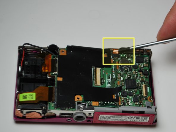

  • Detach the two ribbon cables on the left side of the camera the same way the LCD cable was detached.
  • Detach the gold ribbon cable on the top middle of the camera as well.

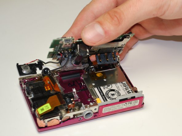

Add Note Edit Step 8  ¶

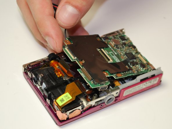

  • Hold wires on the left with an index finger.
  • Carefully wiggle out the motherboard. The flash and the speaker will come with it.
  • Make sure you have a motherboard that includes the flash and the speaker; these items are both soldered onto the motherboard.
