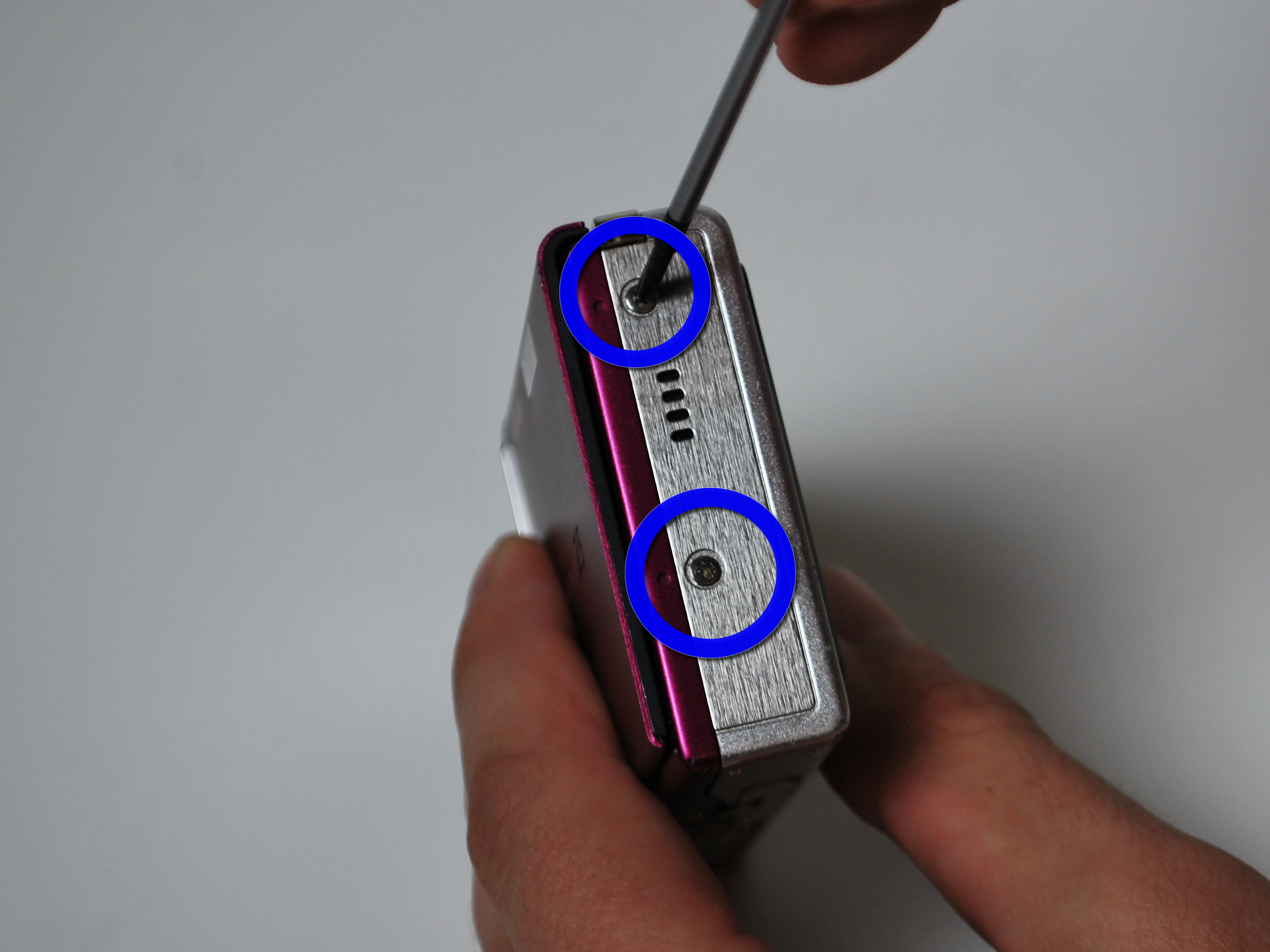

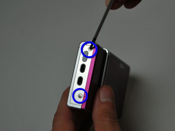

  • Remove the two screws on the right side of the camera and the two screws on the left side.
  • Use a small #00 Phillips flat head screwdriver.
  • Keep all the screws in a container and the two different types separate.

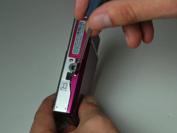

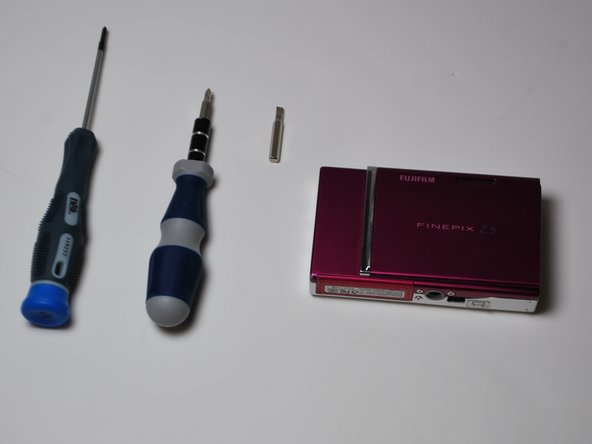

  • Remove the three screws from the bottom of the camera.
  • You need a three-prong screw driver for two of the three screws; keep these screws separate.

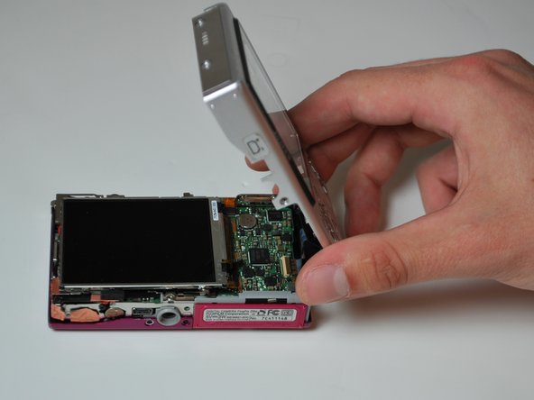

Add Note Step 3  ¶

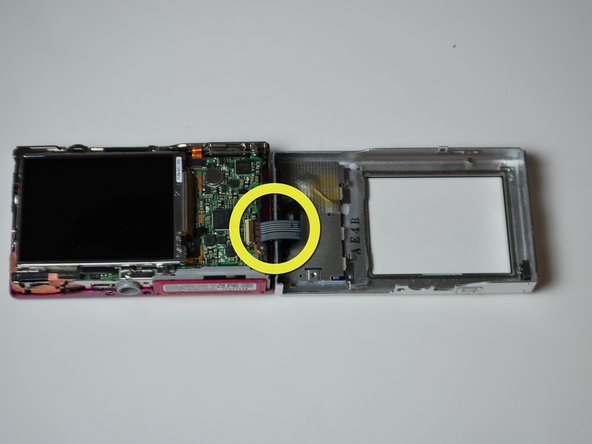

  • Remove the back by carefully flipping it open to the right side.
  • There will be a ribbon cable attaching the front panel to the motherboard, be sure not to tear this.

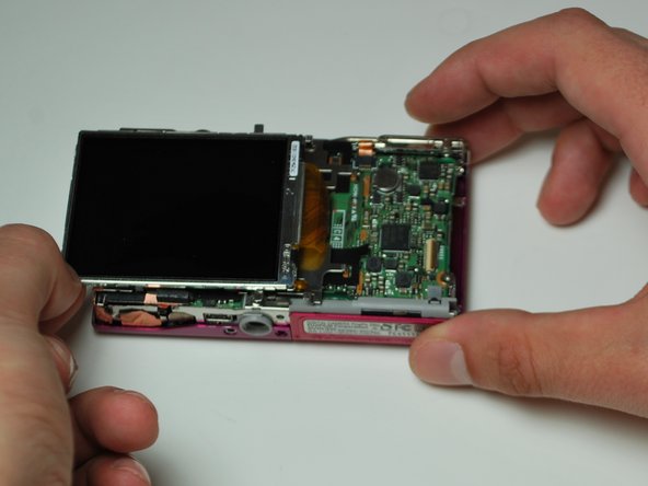

Add Note Step 4  ¶

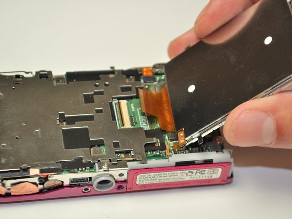

  • Pull the LCD screen to the left slightly, lift it and flip it open to the right.
  • There is also a ribbon cable attaching the LCD screen to the motherboard, be careful not to tear it.

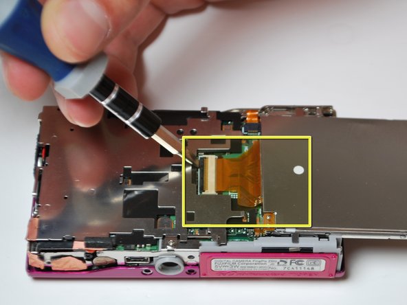

Add Note Step 5  ¶
  • Using a small flat head screw driver, flip open the black lever to release the ribbon cable.
  • Gently slide the cable out of the lock; the LCD screen is now free to be removed.
