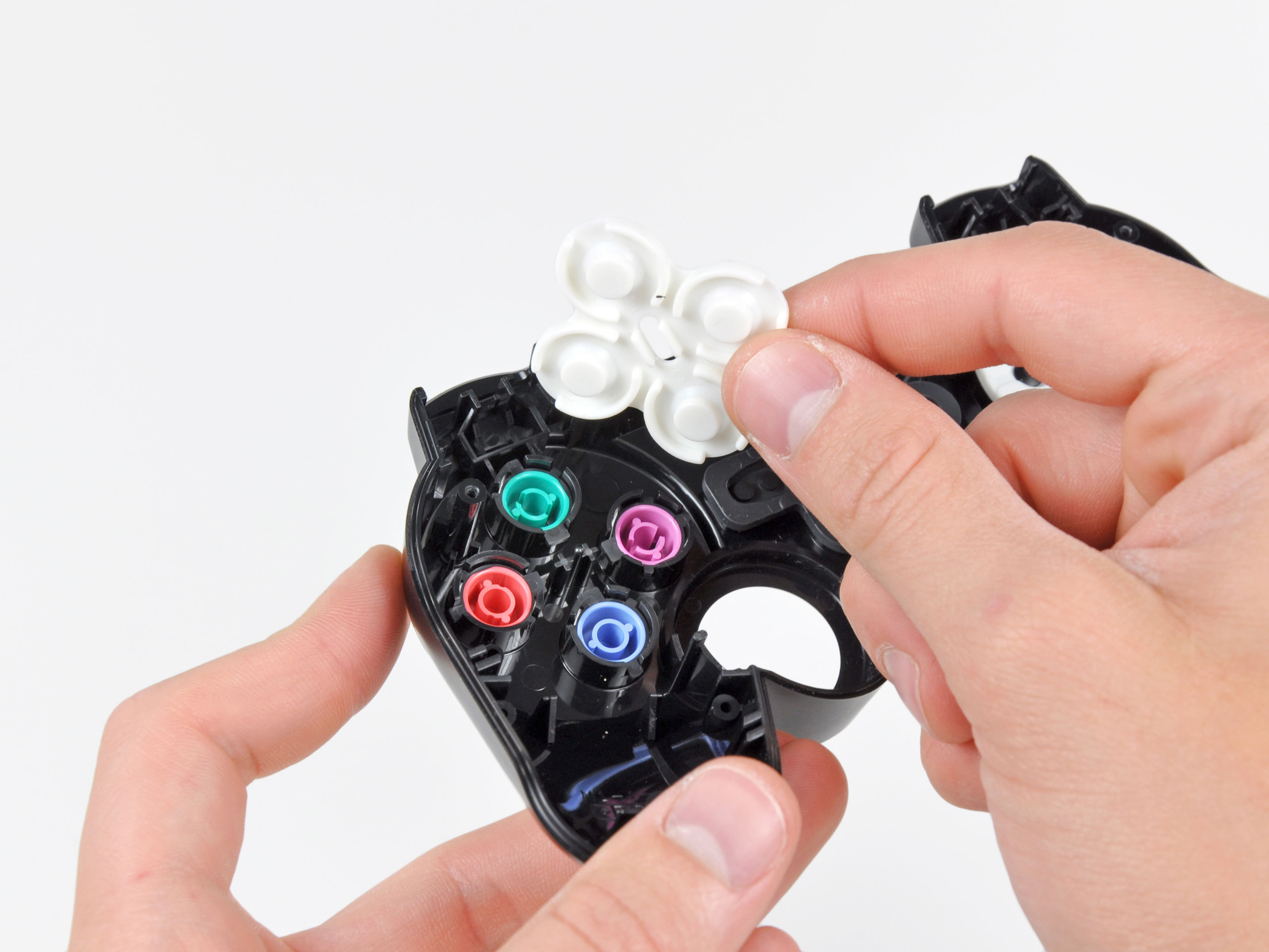

Add Note Edit Step 10 — Buttons  ¶
  • Lift the rubber button contacts off the front controller cover to access the plastic button covers.
  • Lift any damaged plastic button covers out of the controller cover.
Image #1
Add Note Edit Step 11  ¶
  • The D-pad has a three-armed plastic piece that must be installed as shown before installing the rubber button pad for it to work properly.
