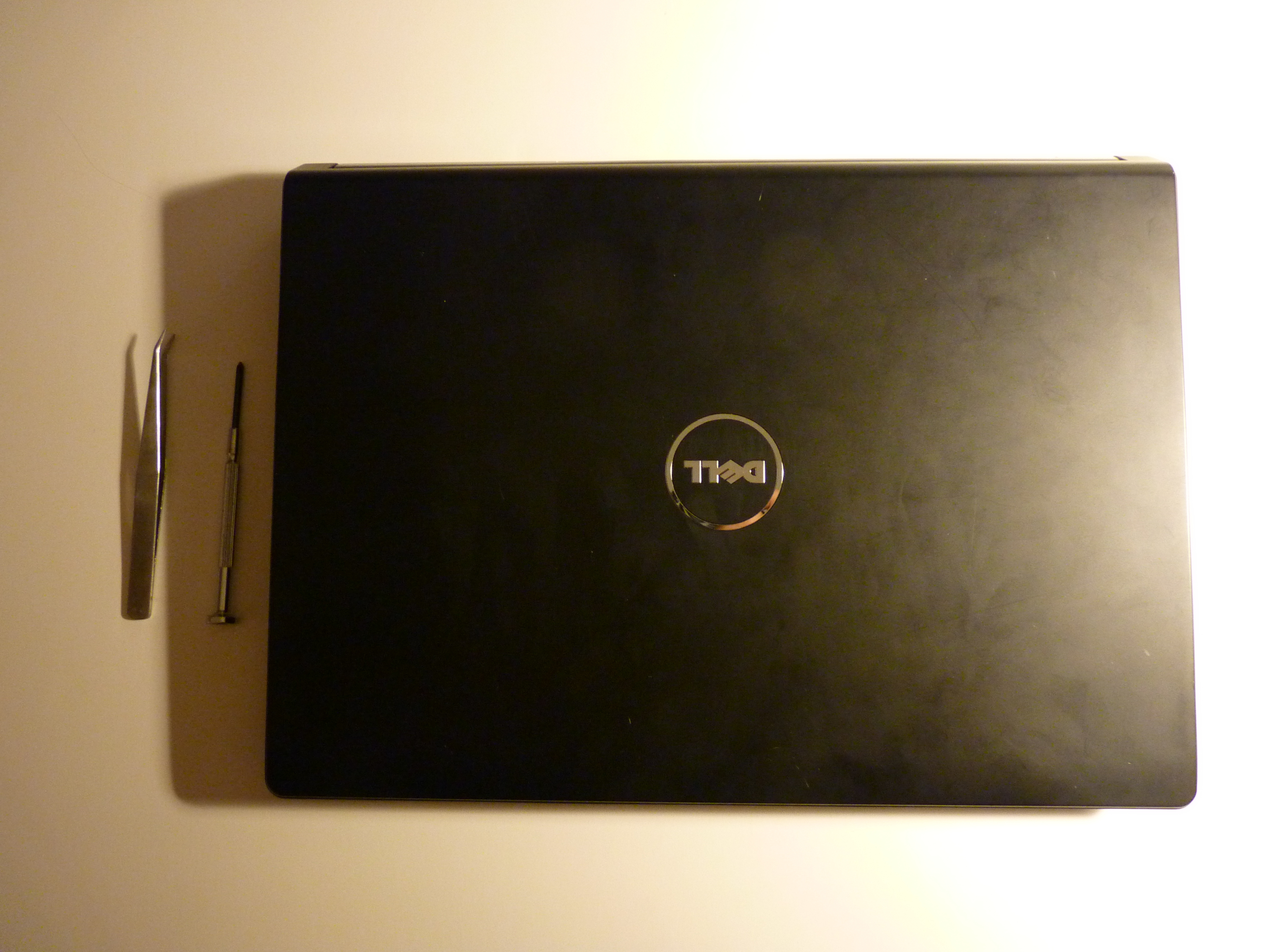

  1. Dell Studio 1535 Hard Drive Replacement, Hard Drive: step 1, image 1 of 3 Dell Studio 1535 Hard Drive Replacement, Hard Drive: step 1, image 2 of 3 Dell Studio 1535 Hard Drive Replacement, Hard Drive: step 1, image 3 of 3
    • Gather tools and materials
    • Flip over laptop, and remove battery as a safety precaution
