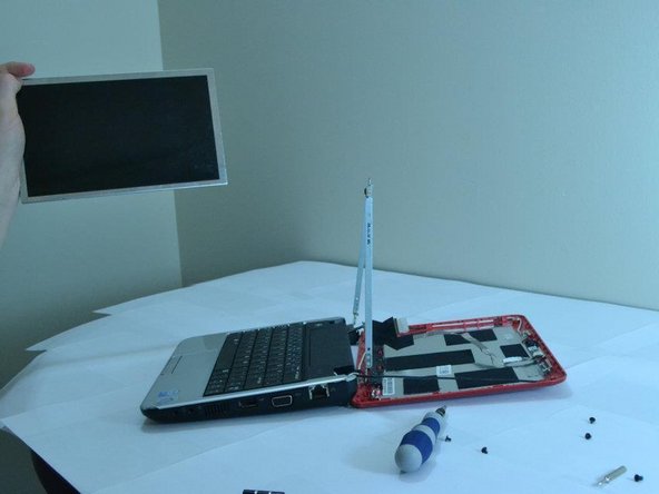

Add Note Edit Step 5  ¶
  • Pull down the laptop's back; the screen should be left upright, held in place by two metal strips going along its sides.
  • On either side of these strips there will be two screws. Unscrew them on both sides. While unscrewing the screws on the second side, make sure to hold the screen so that it doesn't fall when the screws are removed.
Image #1
Add Note Edit Step 6  ¶
  • Pull the screen out. Congratulations! You have removed the screen.

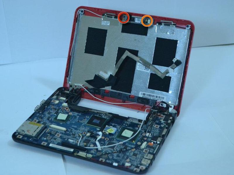

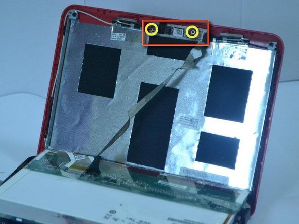

Add Note Edit Step 7 — Web Camera  ¶
  • Remove the 2 small screws above the screen at the center of the lid.
Image #1
Add Note Edit Step 8  ¶
  • Insert the webcam module so that the 2 screw holders match up with the 2 holes in the module
