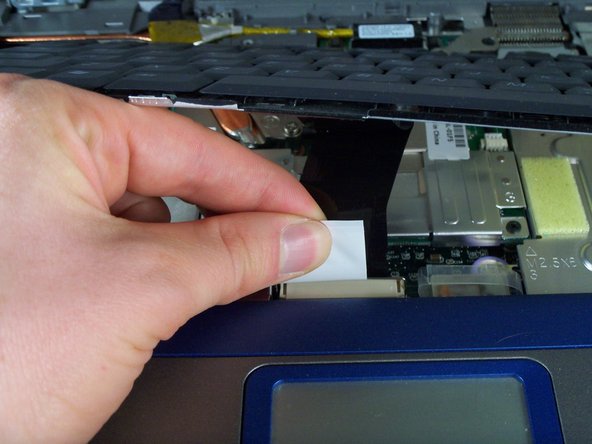

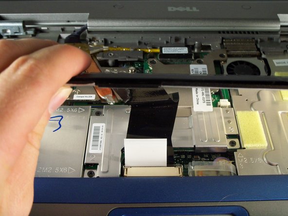

Add Note Edit Step 4 — Keyboard  ¶
  • Remove the screws at the top of the keyboard as indicated indicated.
  • Do not just lift up, there is a tab underneath the keyboard that is still connected to the mother board.
  • You will need to pull out the white tab underneath the keyboard upwards until it pops out of its socket.
  • The keyboard should be easily removable at this point.

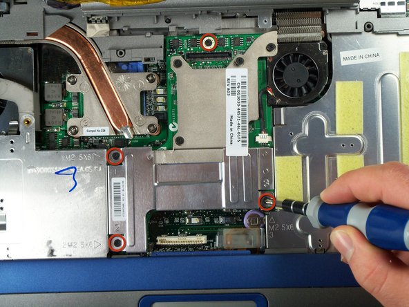

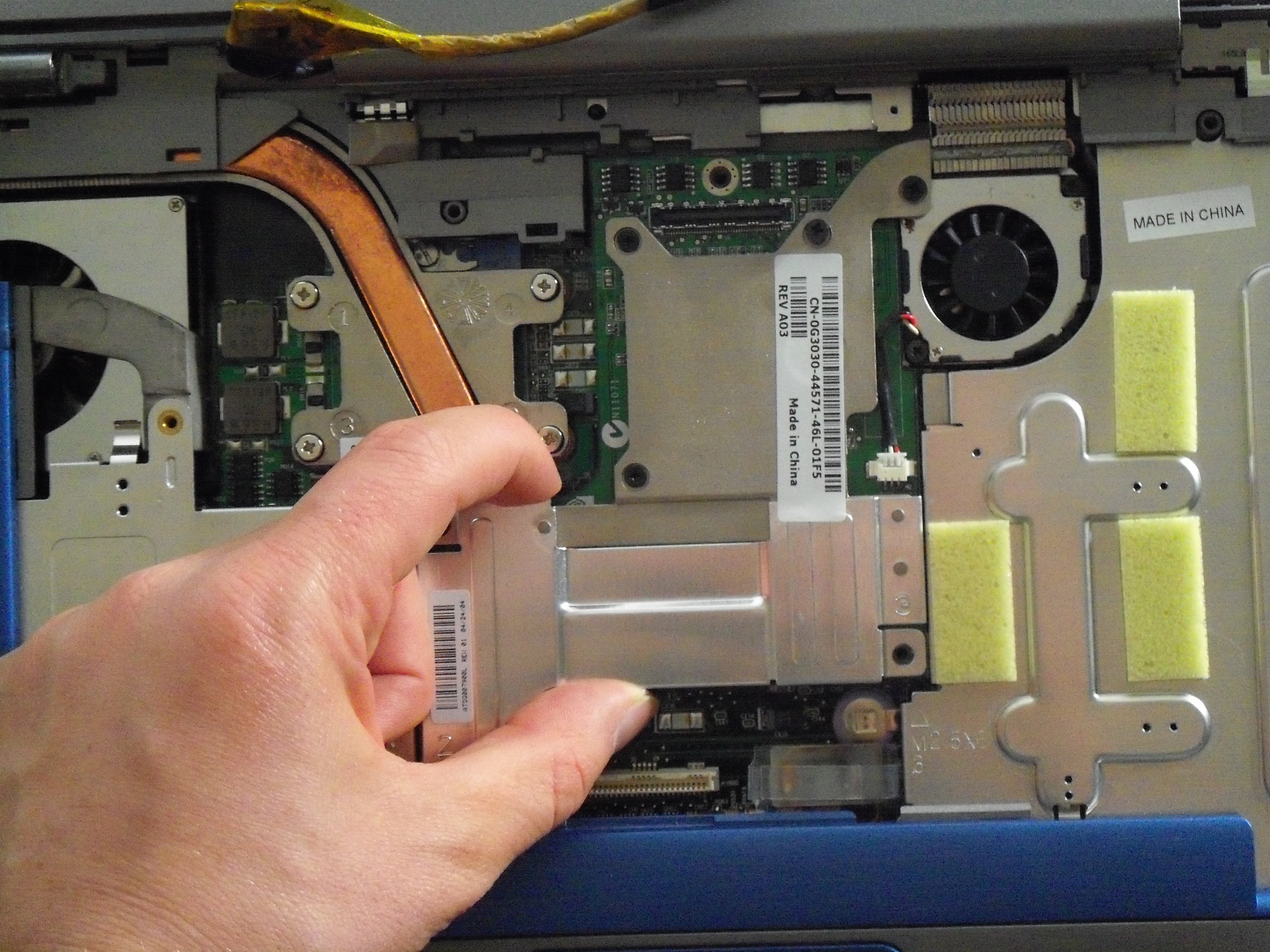

Add Note Edit Step 5 — Video Card  ¶
  • After removing the keyboard, locate and remove the labeled screws.
  • Gently lift the Video Card unit for replacing.
