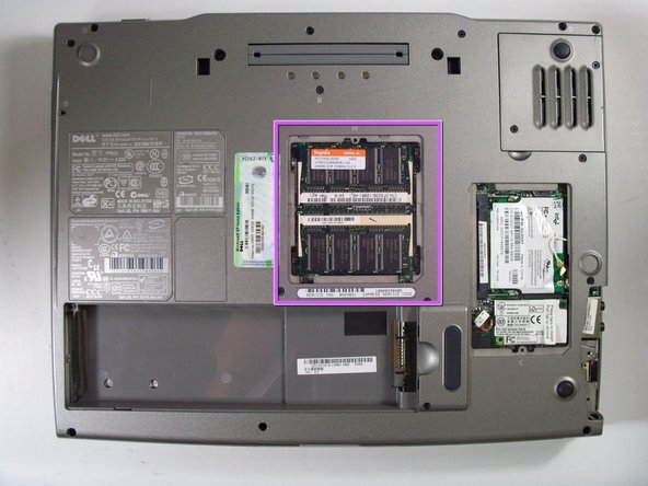

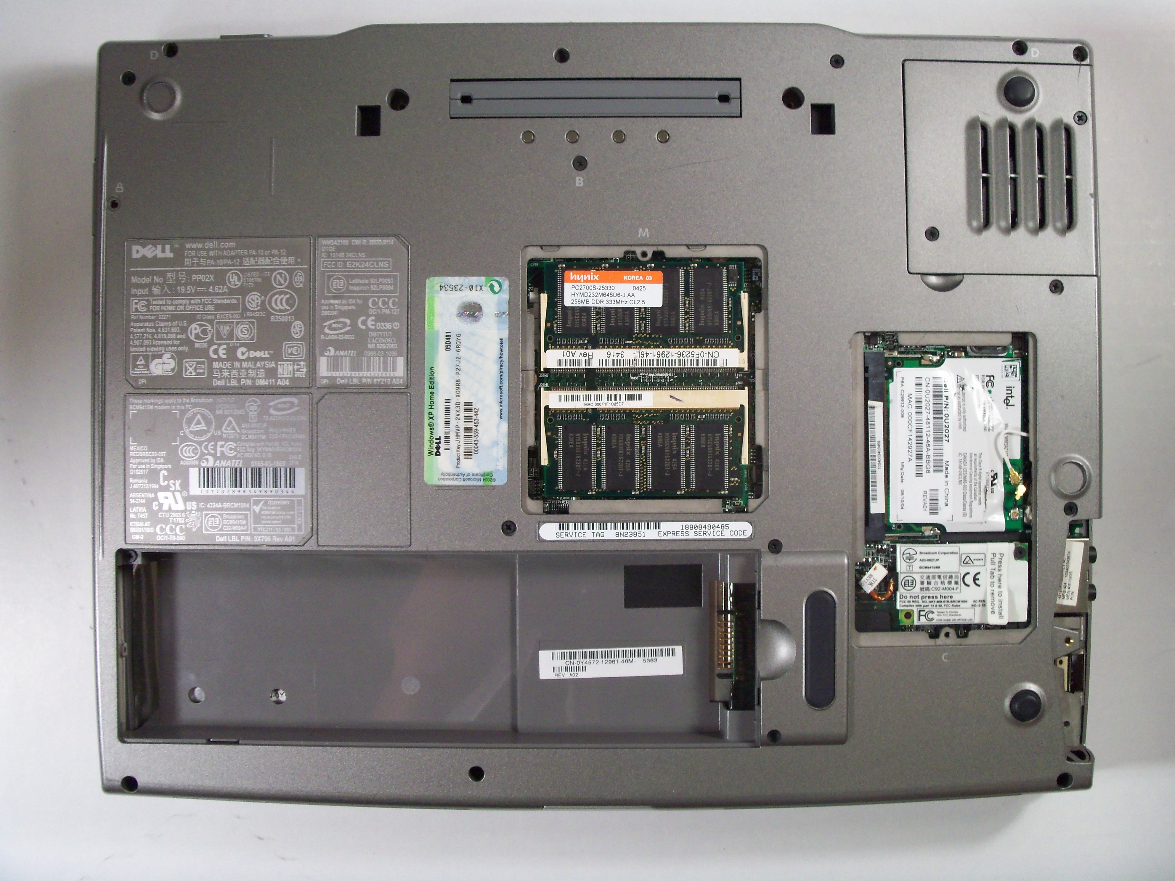

  • Remove battery from the bottom of the laptop.
  • For more complete instruction see, Disassembling Dell Inspiron 9100 Battery.
  • It is important to remove the battery so further disassembly will be safer.

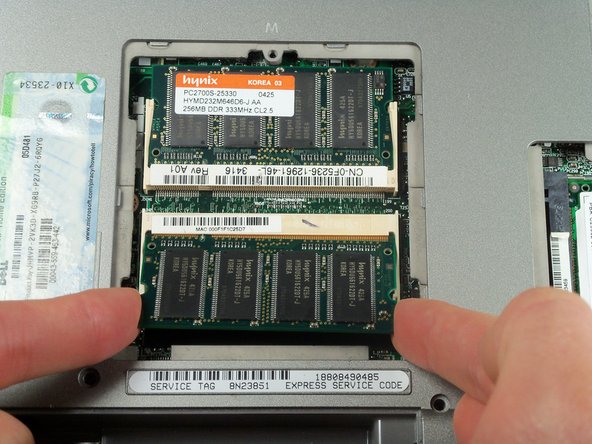

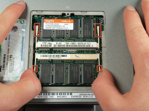

  • Pull apart the white plastic tabs on either side of the RAM which will cause it to rise upwards.
  • Gently remove the RAM, only touching the edges of the component.
