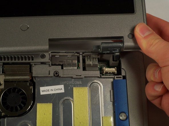

Add Note Edit Step 2 — Hinge Cover  ¶
  • Insert a spludger into the notch at the far left side of the top blue panel and pry hinge cover off.
  • Note: You may need to pry the other side off by inserting the spludger between the hinge and the top cover.
  • Be careful of wire attached to underside of the hinge cover.

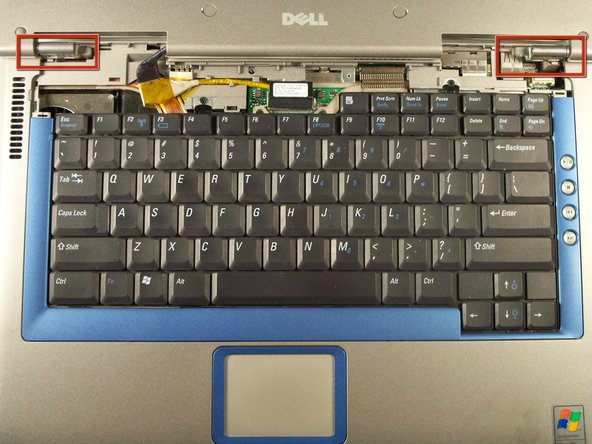

Add Note Edit Step 3  ¶
  • Pull the small black tab on the right hand side of the laptop.
  • The hinge cover has now been removed.

Add Note Edit Step 4 — Display Module  ¶
  • Flip the laptop over and remove indicated screws.
  • Flip the laptop back over.
  • Find the two places where the display module is attached to the base of the computer.

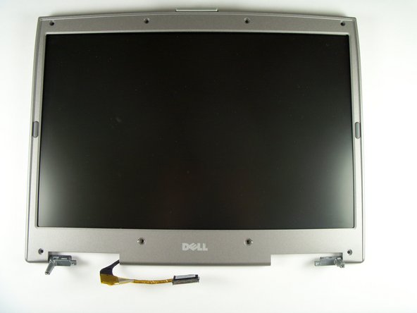

Add Note Edit Step 6  ¶
  • Lift the display module directly upwards.
first image
Add Note Edit Step 7  ¶
  • The display module has been removed.
first image

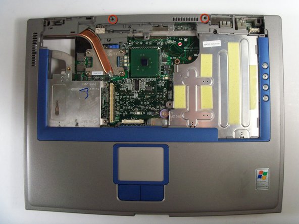

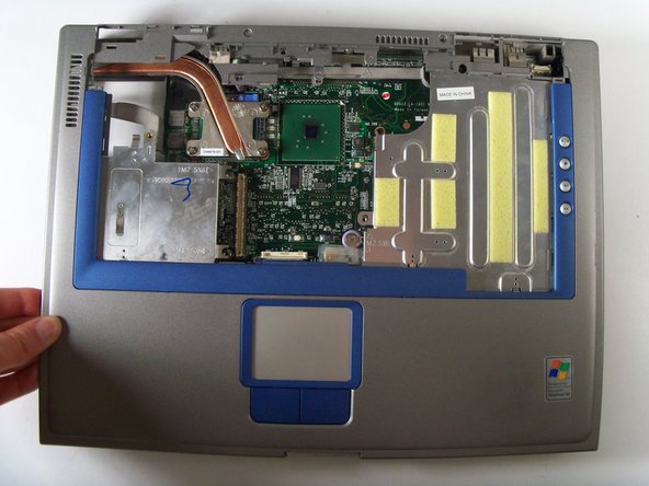

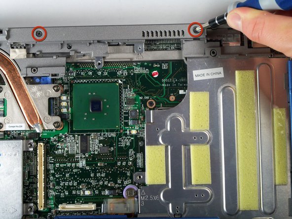

Add Note Edit Step 8 — Proccessor (CPU)  ¶
  • Locate and remove the top two screws holding the top case down.
  • Gently pop off the top plastic case from the unit.

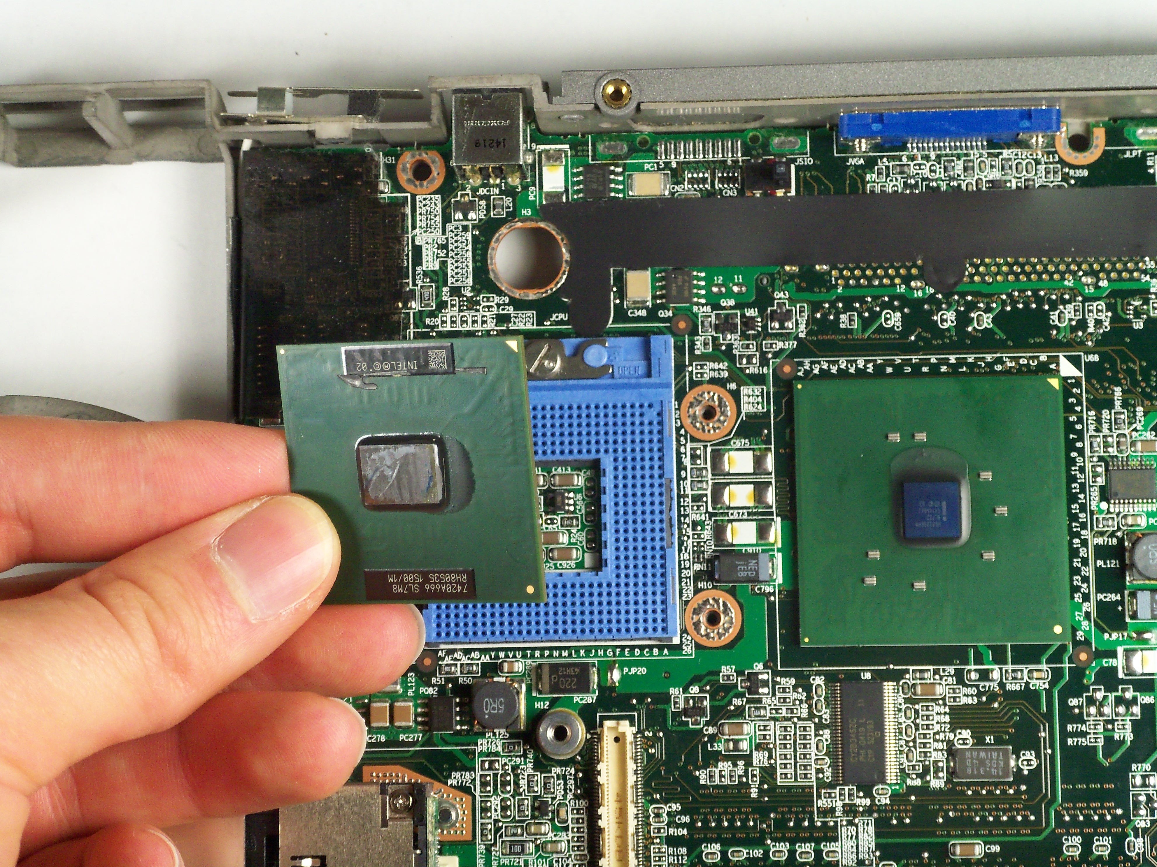

Add Note Edit Step 10  ¶
  • Gently loosen but do not remove the screw, and lift the CPU.
  • You will have to remove and replace the Applying Thermal Paste on the CPU base.
  • You may now replace the CPU.
