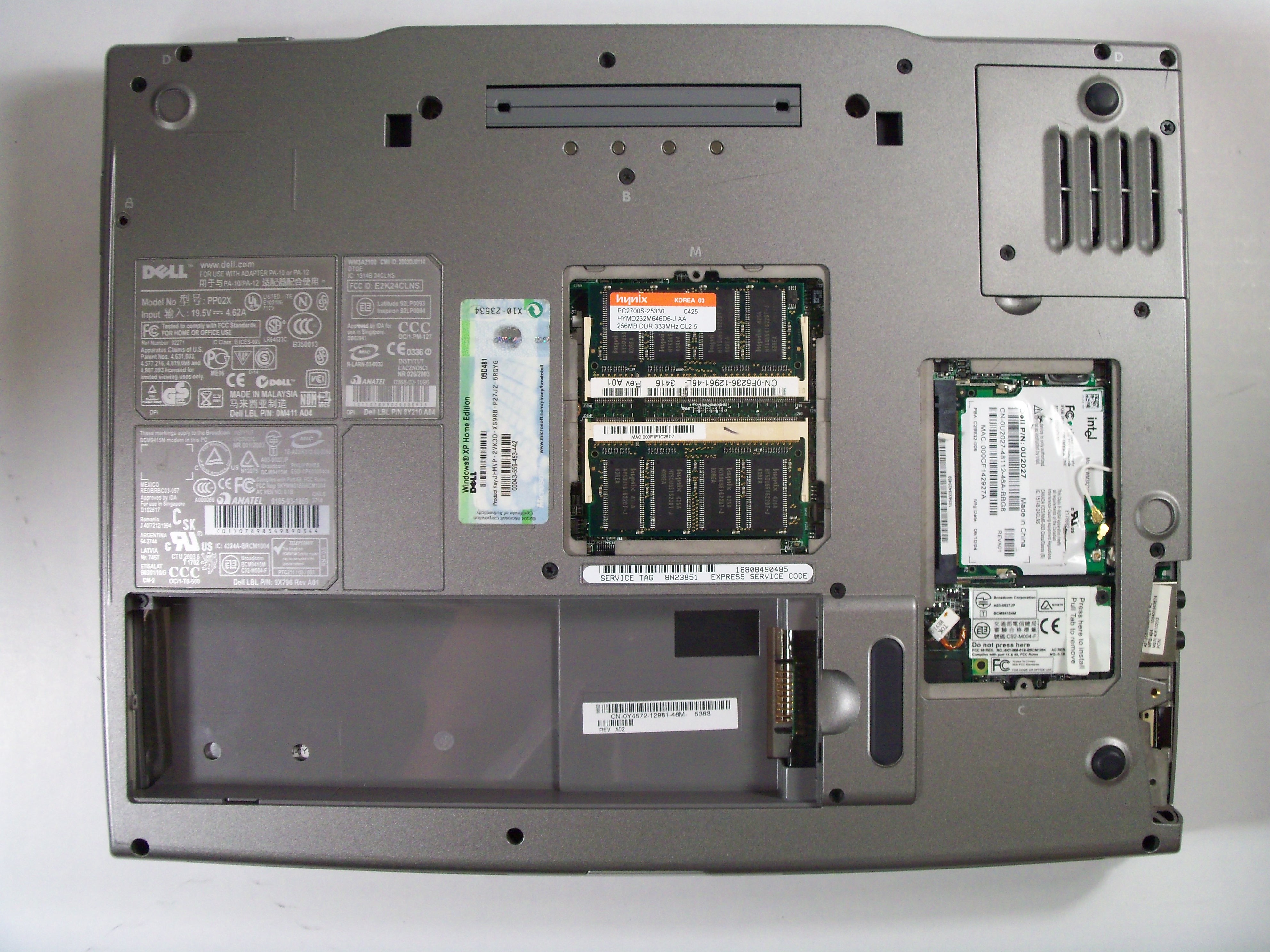

Image #1
  • Remove battery from the bottom of the laptop.
  • For more complete instruction see, Installing Dell Inspiron 9100 Battery.
  • It is important to remove the battery so further disassembly will be safer.

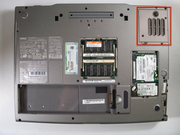

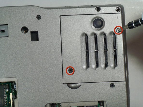

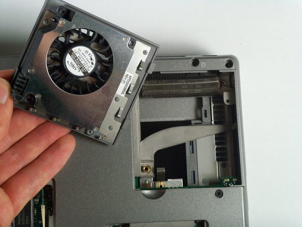

  • Remove the screws on the top right of the bottom of the laptop.
  • Once screws are removed, the fan can easily be slid out of its position.
