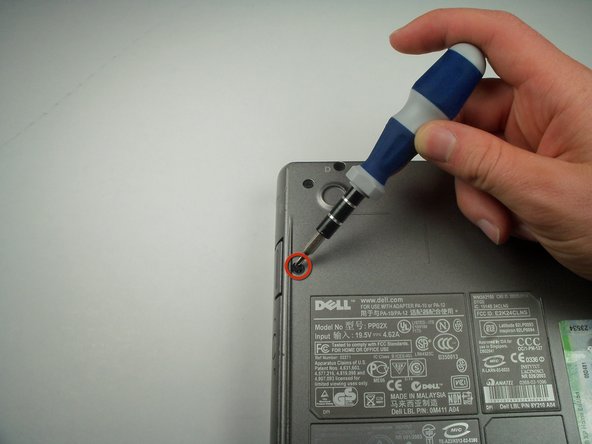

Add Note Edit Step 2 — CD-Rom Drive  ¶
  • Locate and remove the screw that secures the CD-Rom Drive.

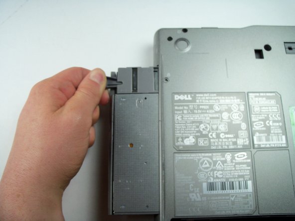

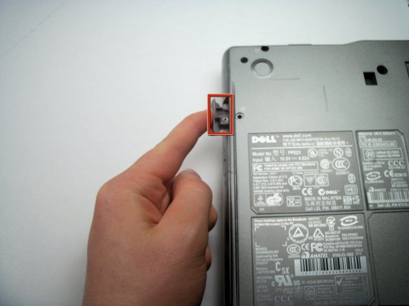

Add Note Edit Step 3  ¶
  • Push the button on the lower right hand side of the CD-Rom drive component.
  • The button should pop out.
  • Then pull out the CD-Rom Drive from there.
