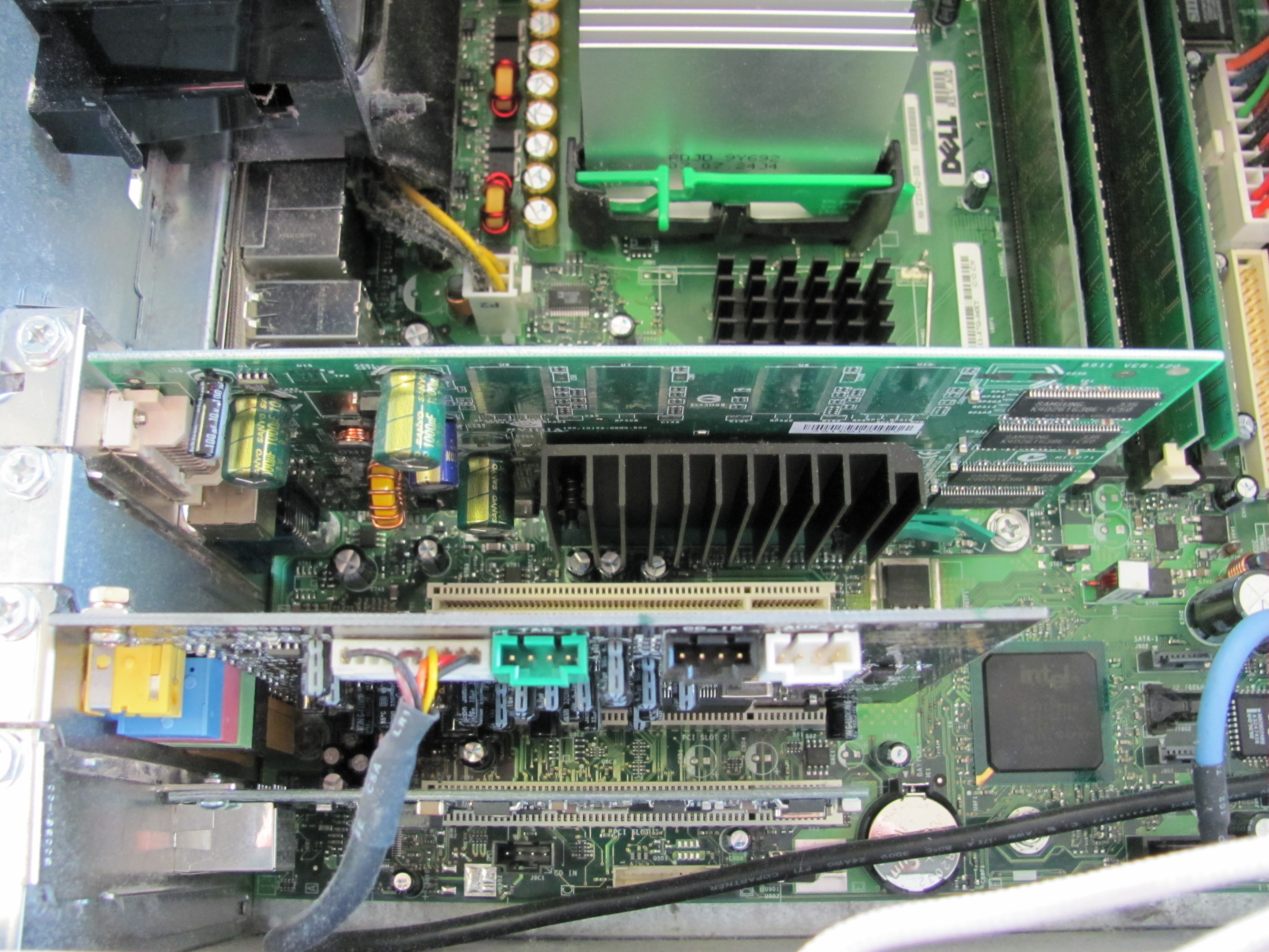

Add Note Edit Step 5  ¶
  • Locate the Sound Card and the screw attached to the Sound Card as shown in the picture.
Image #1
Add Note Edit Step 6  ¶
  • Remove the 8.9 mm screw by using a Phillips #2 screw-driver.

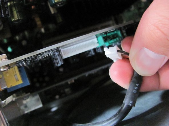

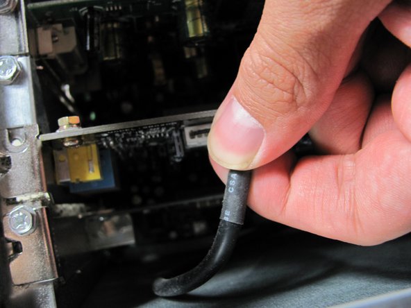

Add Note Edit Step 7  ¶
  • Locate and remove the white connector on the sound card by pulling on the black cable.

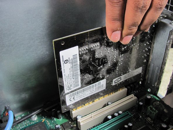

Add Note Edit Step 8  ¶
  • Grasp the Sound Card and pull it up and out of it's slot.
