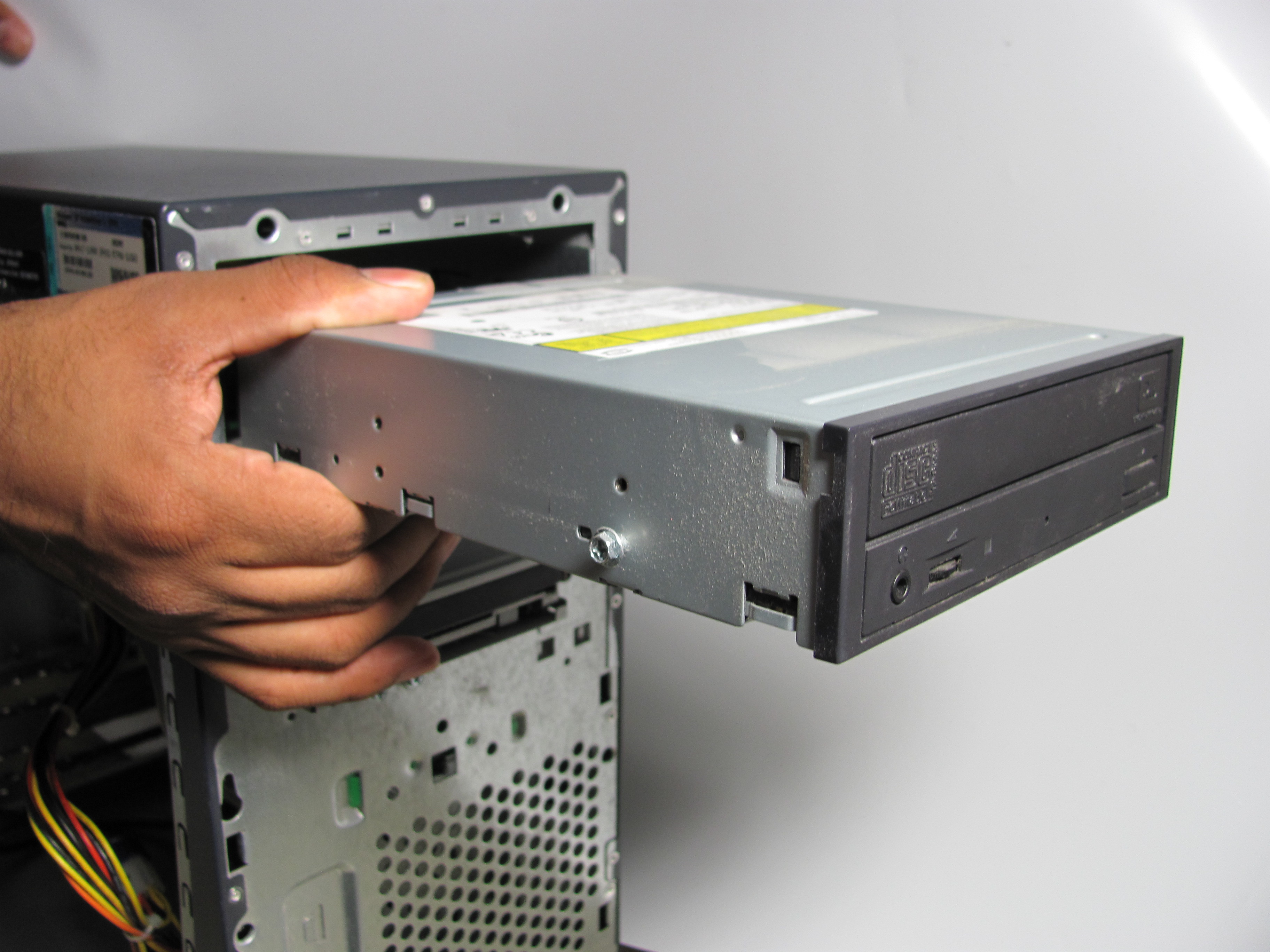

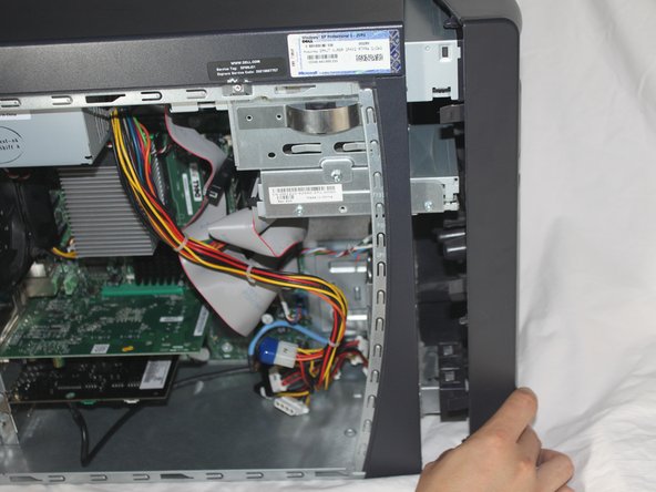

  • Press and hold the two levers located behind the front panel.
  • While holding the levers down, swing open the front panel.
Image #1
Add Note Edit Step 6  ¶
  • Swing the front of the case open until it separates from the main case.

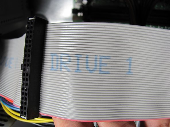

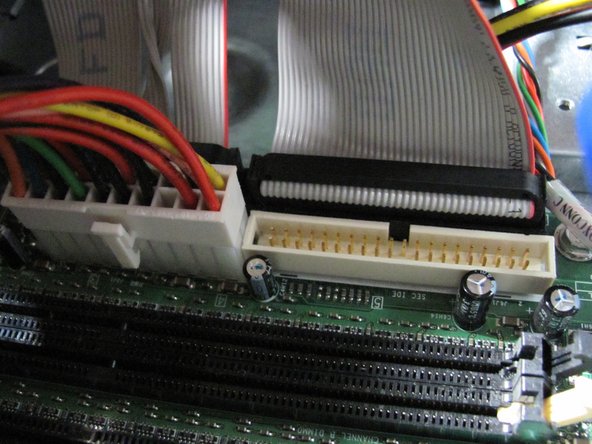

  • Locate the Drive 1 cable and where it is connected to the motherboard.
Image #1
Add Note Edit Step 8  ¶
  • Grasp the end of the Drive 1 cable connected to the motherboard and firmly pull upwards until it is removed.
