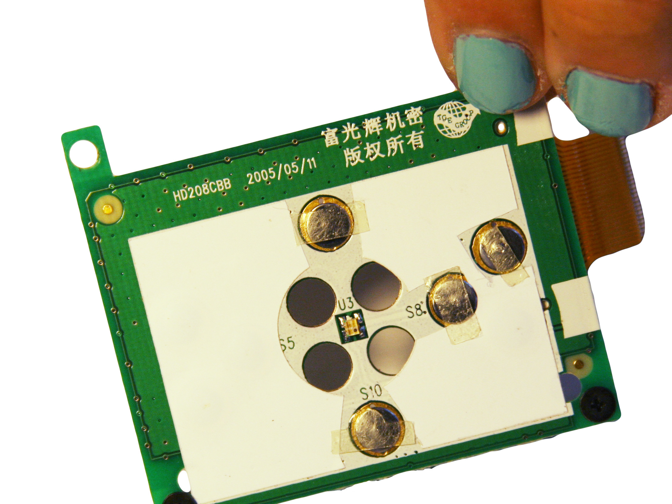

This guide shows how to install the button module.
  • Author: Ryan Sutardji
  • Time required: 30 to 40 minutes
  • Difficulty: Moderate

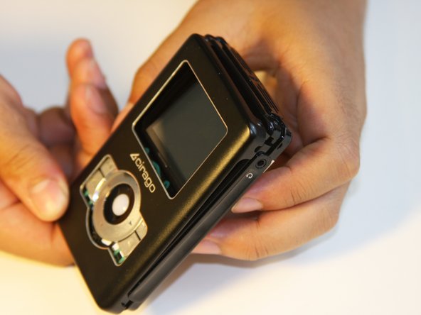

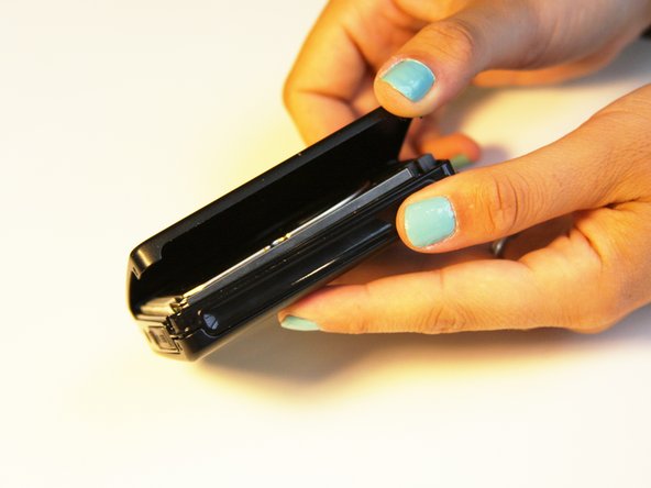

Image #1 Image #2
Add Note Edit Step 3  ¶
  • Gently lift off the back and front casing.
  • The outer shell should easily come apart.

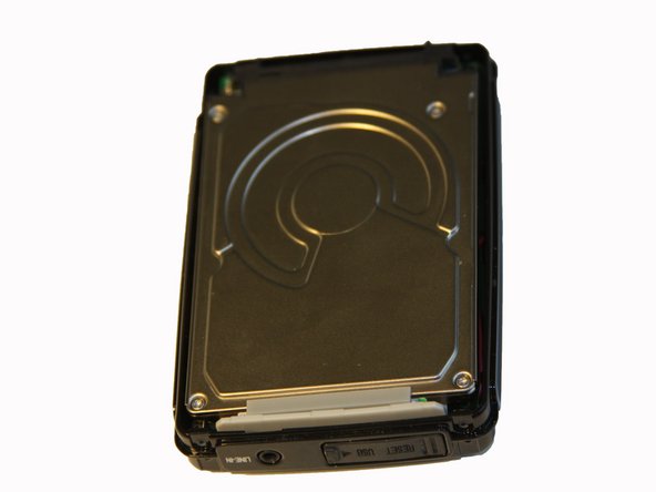

Add Note Edit Step 4 — Hard Drive  ¶
  • Make sure the device screen is face down.
Image #1 Image #2 Image #3
Add Note Edit Step 5  ¶
  • Using the plastic opening tool, wedge the tool underneath the bottom left edge of the hard drive.
  • Raise the bottom edge of the hard drive 15 degrees up from the device.
Add Note Edit Step 6  ¶
  • Place fingers on the IDE connectors and gently slide the hard drive out from the IDE module.
Image #1 Image #2

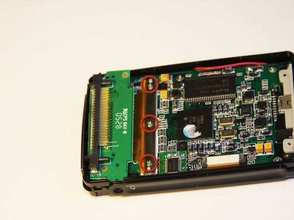

Add Note Edit Step 7 — IDE Connector  ¶
  • Using the Phillips #00 screwdriver, unscrew the two 1.5mm long screws holding the IDE connector to the motherboard.
Image #1
Add Note Edit Step 8  ¶
  • Using the Phillips #00 screwdriver, unscrew the three 1.5mm long screws on the metal bracket.
