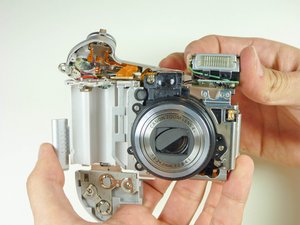

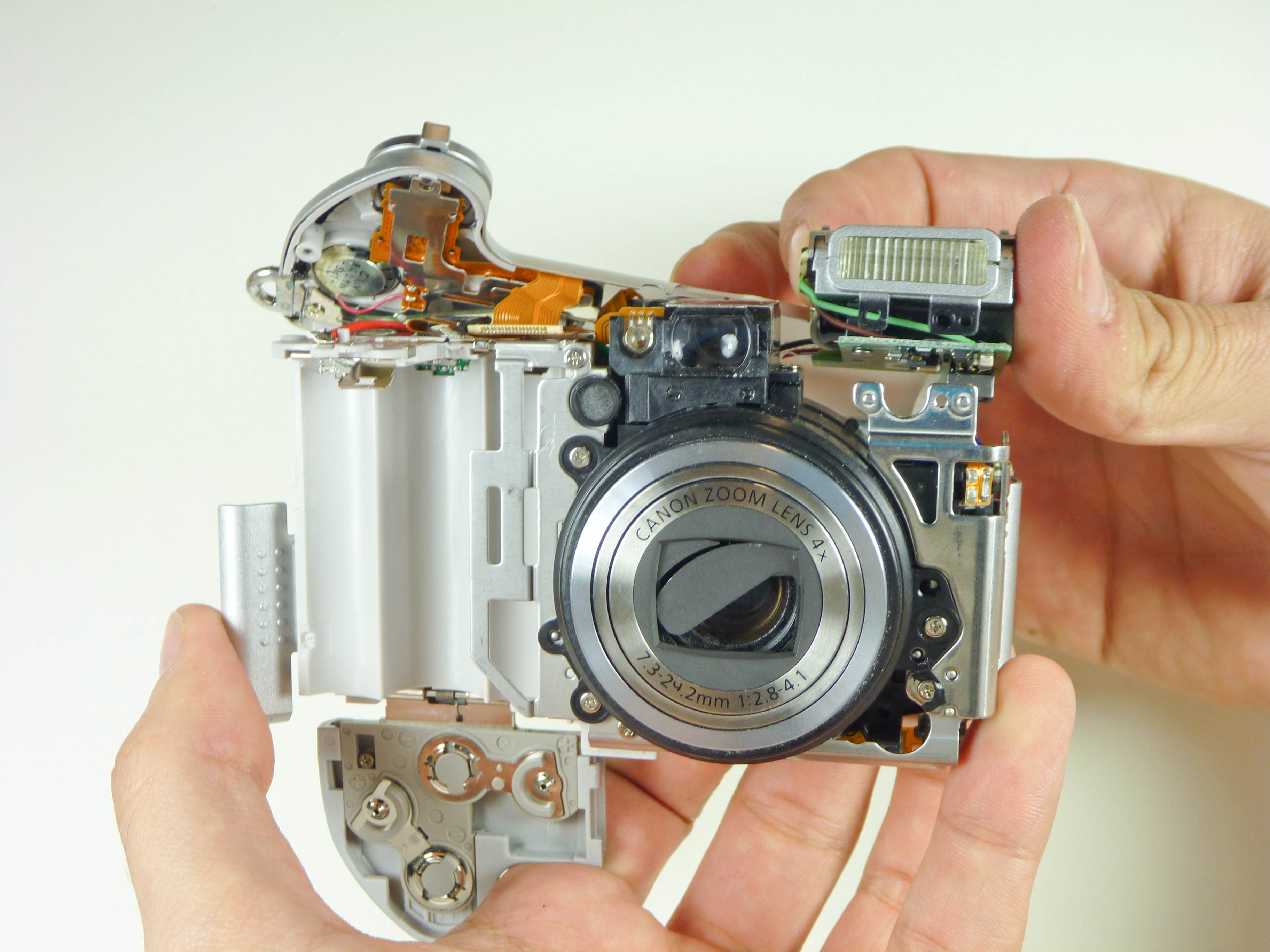

This will guide you through the removal and re-installation of a new flash bulb unit.
You will have to get into the inside of the camera before removing the flash bulb is possible. Some soldering may be required to completely remove the flash unit from the camera.

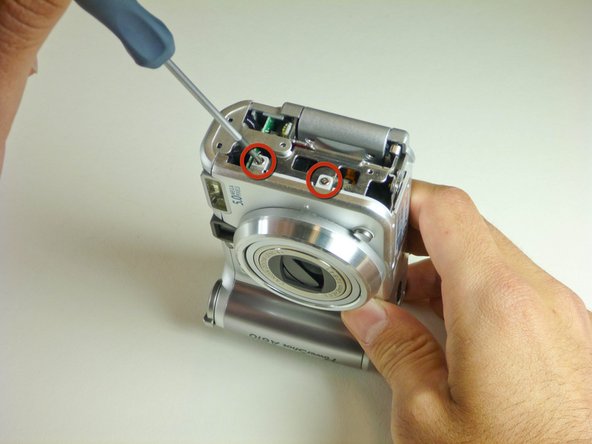

  • Remove the two remaining 2mm screws attached to the frame of the camera.

Add Note Edit Step 4  ¶
  • Remove the 3mm screw closest to the lens of the camera and the 4mm screw near the back of the camera.

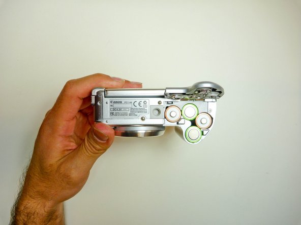

Add Note Edit Step 5  ¶
  • Open the battery door.
  • Locate and remove the four screws inside.
  • One 5mm screw is located on the top side of the bottom cover.
  • The other three 6mm screws are located at the bottom of the battery compartment.
  • Close battery door.

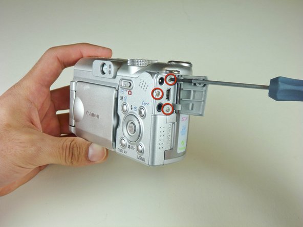

Add Note Edit Step 6  ¶
  • Open the 'DIGITAL AV OUT' door on the camera.
  • Remove the three 4mm screws.
  • Detach the 'DIGITAL AV OUT' door and its cover.
  • When putting the camera back together, leave the topmost screw out until AFTER the top casing has been put back on.

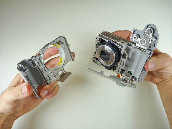

Add Note Edit Step 8  ¶
  • With the shutter and bottom facing towards you, pull the right side of the front casing out and towards your body.
  • This may require some force but be careful not to break the plastic.
