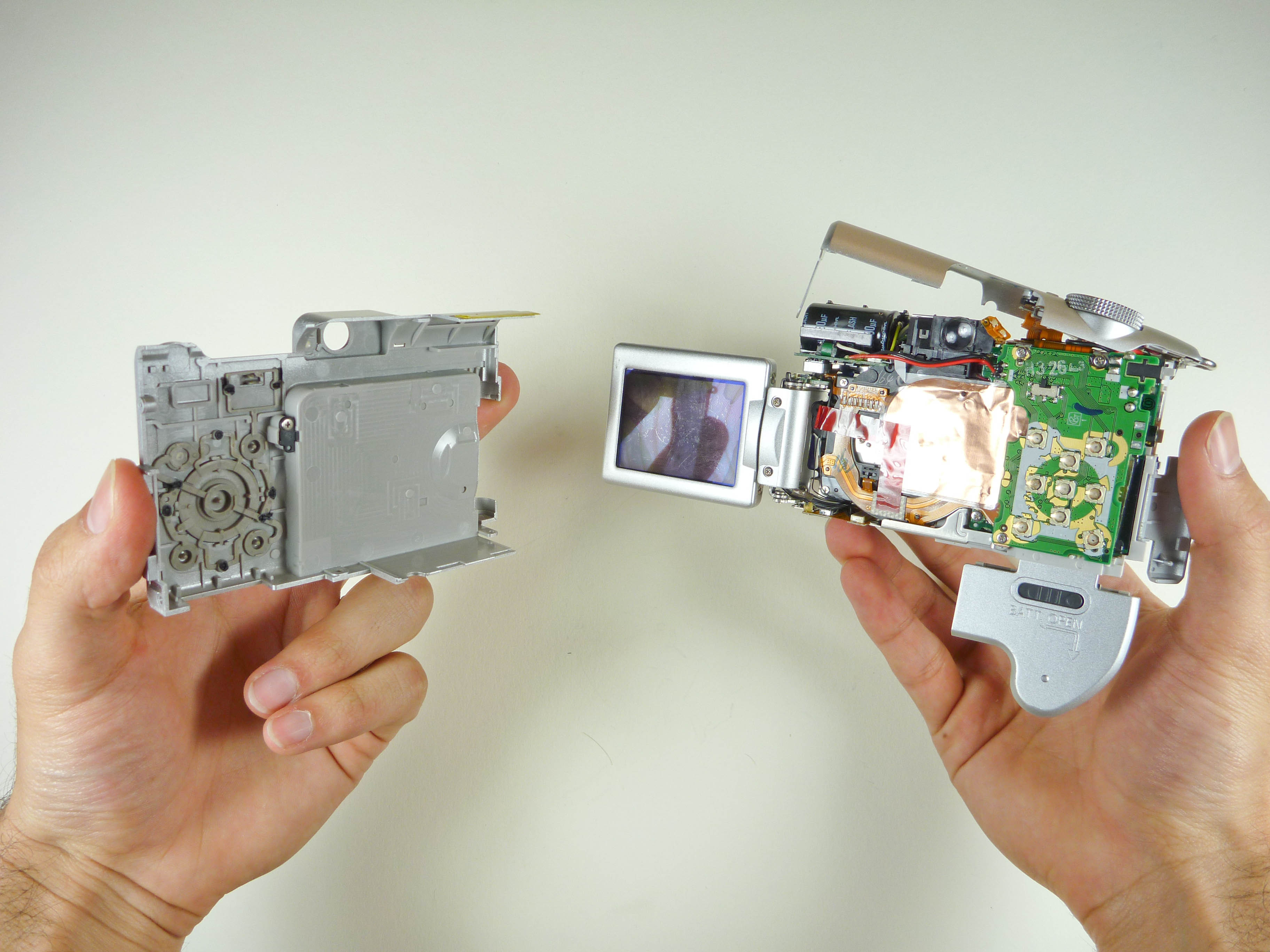

Removal of the Canon A610 front, back and side cover.
In order to get to the internals of the Canon A610, we first have to remove the plastic casing around the camera.
Image #1 Image #2

Add Note Edit Step 7  ¶
  • Grip the sides of the top cover and gently pull up until the top cover comes off.
  • The top cover does not completely detach.
Image #1 Image #2
Add Note Edit Step 8  ¶
  • Open the battery door.
  • With the shutter and bottom facing towards you, pull the right side of the front casing out and towards your body.
  • This may require some force but be careful not to break the plastic.
