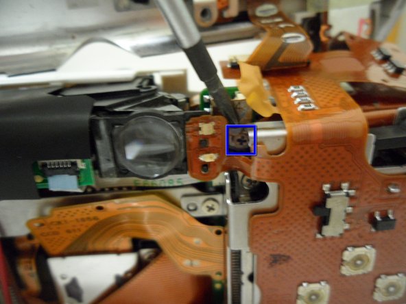

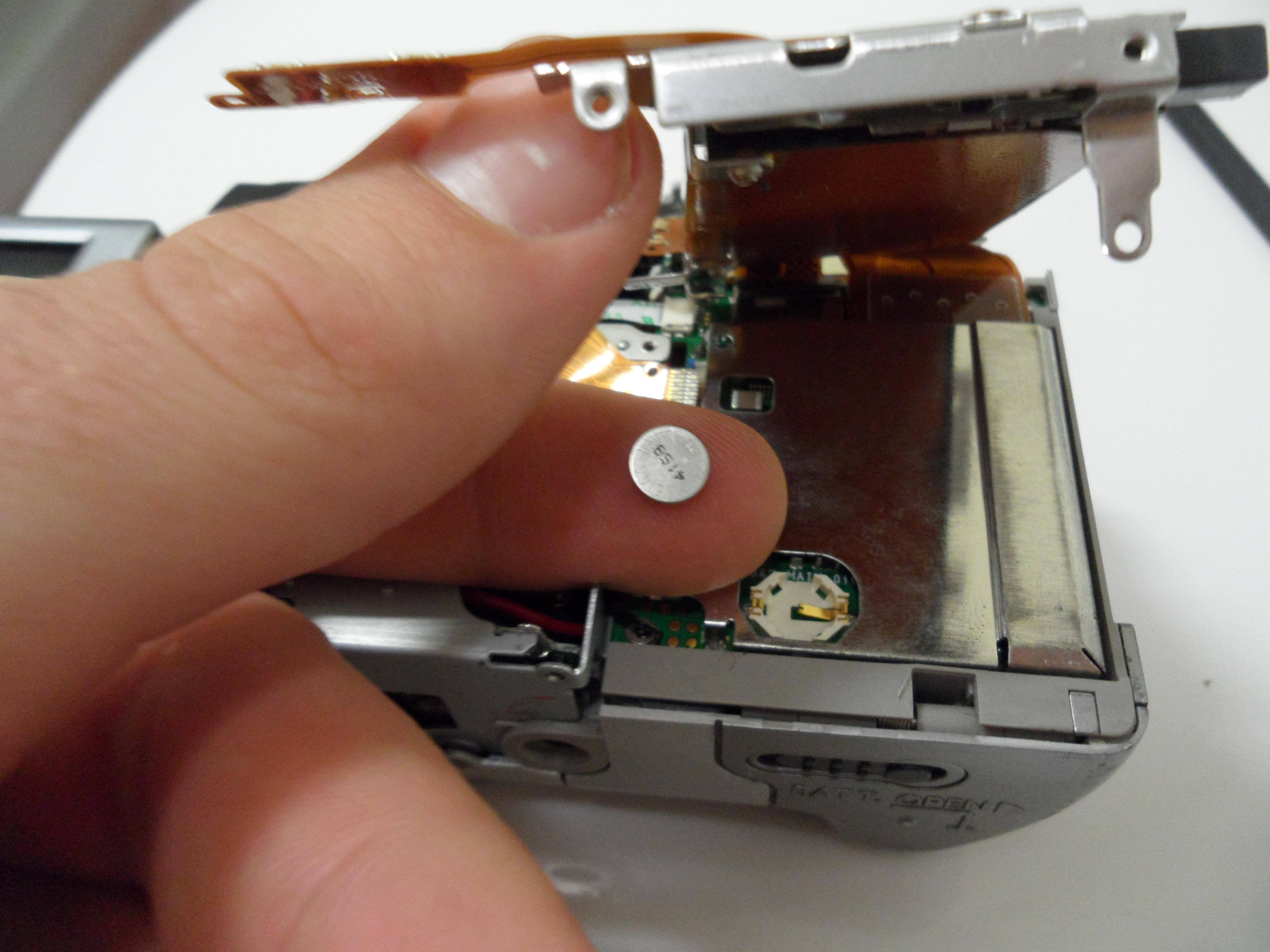

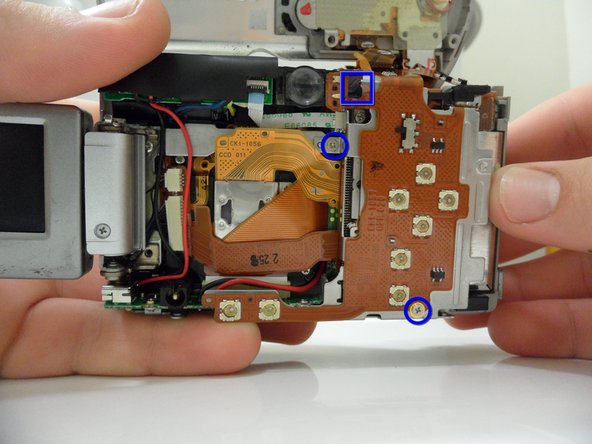

Add Note Edit Step 8 — Internal Battery  ¶
  • Unscrew the top 3.9mm, middle 2.7 mm, and bottom 2.9mm screws that hold the metal foundation covering the internal battery.
  • See next photo for zoomed image of the boxed screw.
