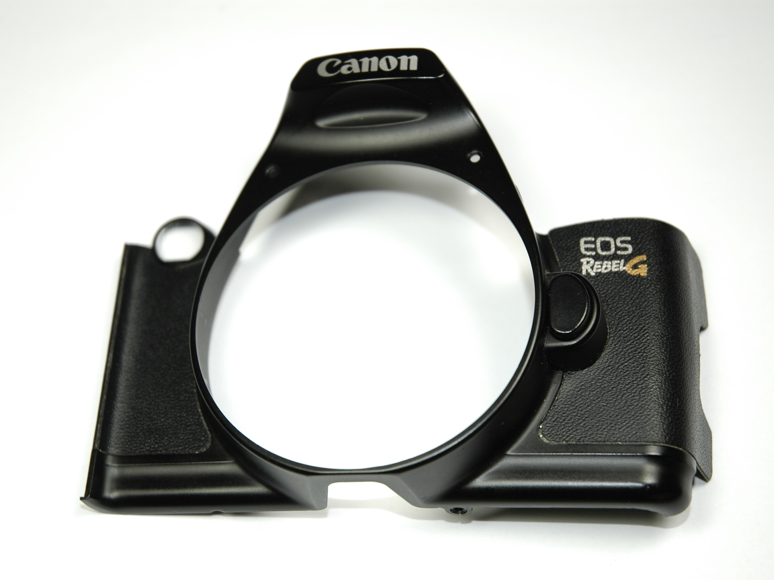

This guide shows you how to install the front panel of your camera.
Image #1
Add Note Edit Step 1 — Front Panel  ¶
  • Using a #00 Phillips screw driver, remove three 4.4 mm Phillips screws as indicated by the red circles.
Image #1 Image #2
Add Note Edit Step 2  ¶
  • Using your finger, peel back the textured grip so the components are separated.
Image #1 Image #2 Image #3
Add Note Edit Step 3  ¶
  • Using the flat end of a spudger, loosen the connection between the front panel and the device.
  • Remove the front panel using your hands.
