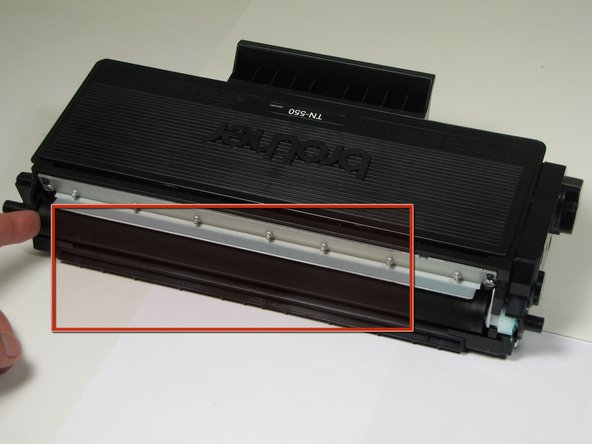

  • Separate the toner cartridge from the drum unit by pressing down on the blue tab and gently lifting the toner cartridge up by the lift on the handle.

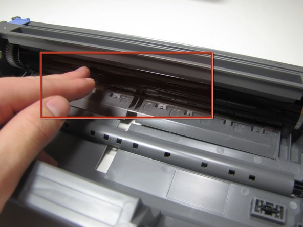

  • DO NOT TOUCH the roller bar on the toner cartridge, or the roller bar on the drum unit as illustrated in the pictures. This may cause a decrease in print quality.
Image #1 Image #2 Image #3

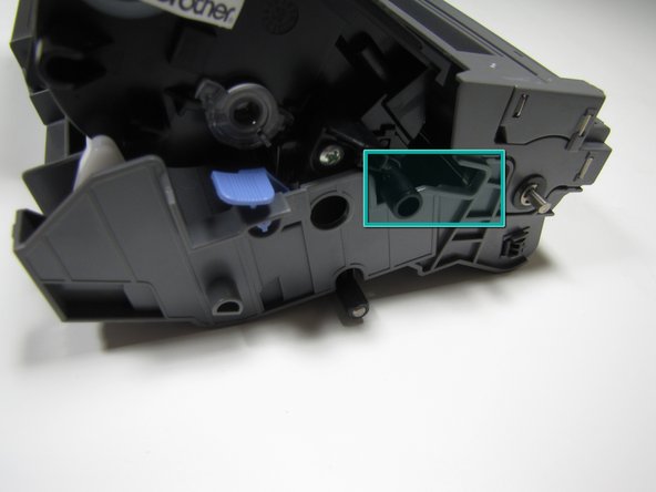

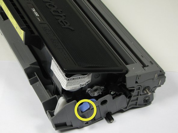

  • Insert the toner cartridge into the new drum break by firmly sliding the cartridge into the drum unit. If installed correctly, the blue lever will be locked in a lifted position.
  • Be sure that the black nob located on the back of the toner cartridge is places inside the track located on the drum unit.
  • The third picture illustrates an incorrectly installed drum unit and toner cartridge, notice how the blue lever is down.
