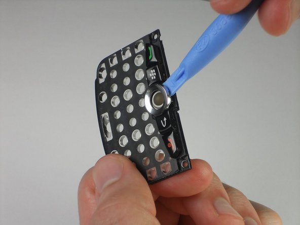

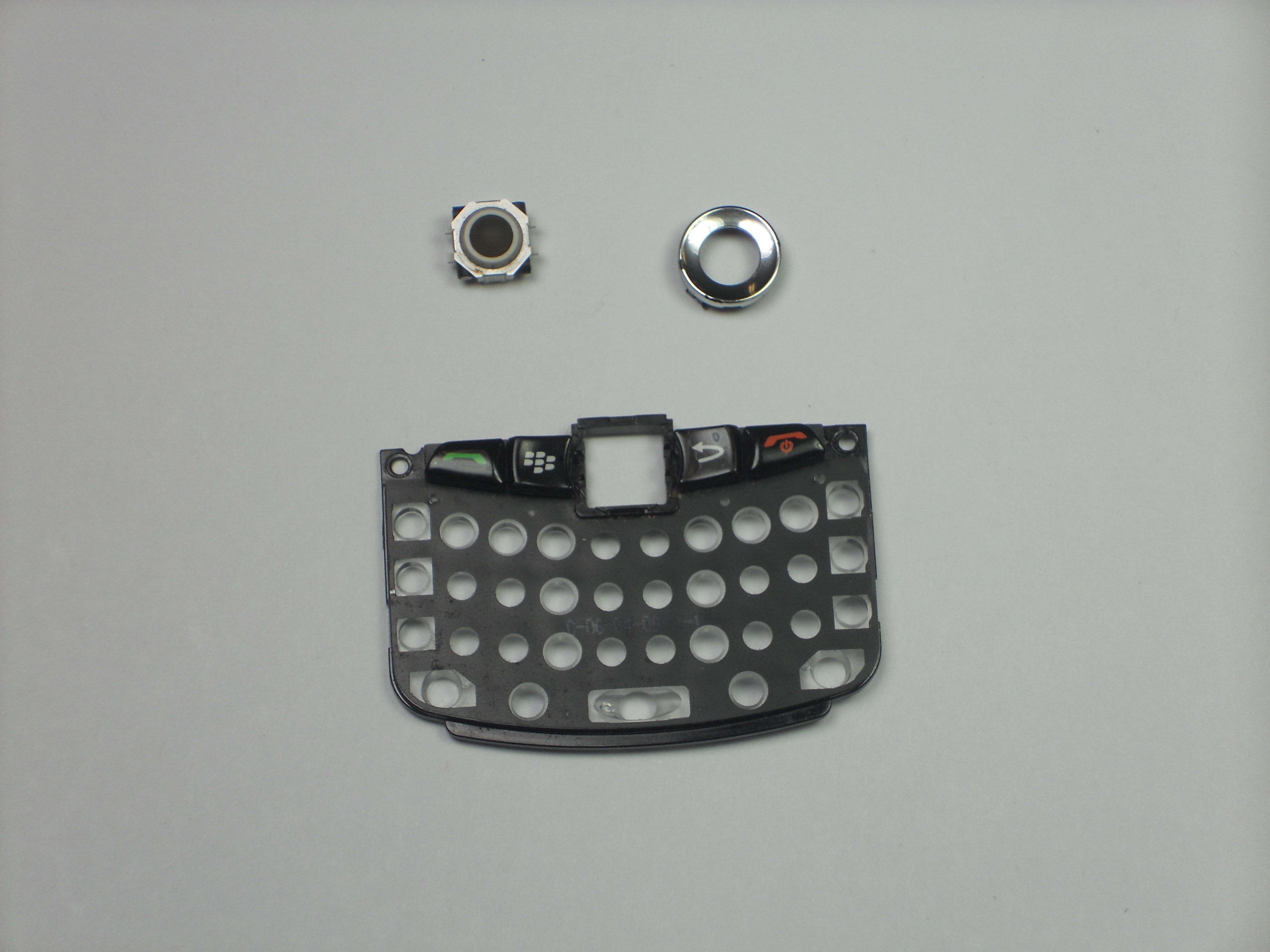

This guide demonstrates how to remove the trackball from the Blackberry Curve 8330

Step 5
Use a plastic opening tool to pry between the front and back cover.
Start prying from wherever it is easiest to separate the silver and black plastic of the covers.
There are 5 securing clips on the front panel to disconnect.
Pry gently to prevent breaking the plastic clips when removing the front panel.
Once all the clips have been freed, the front cover will lift away from the phone.
