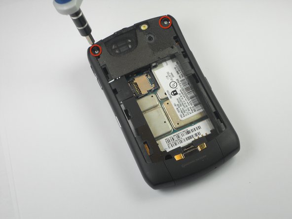

Add Note Edit Step 3 — Keyboard  ¶
  • Remove the two top screws using a T5 Torx screwdriver.
Image #1 Image #2

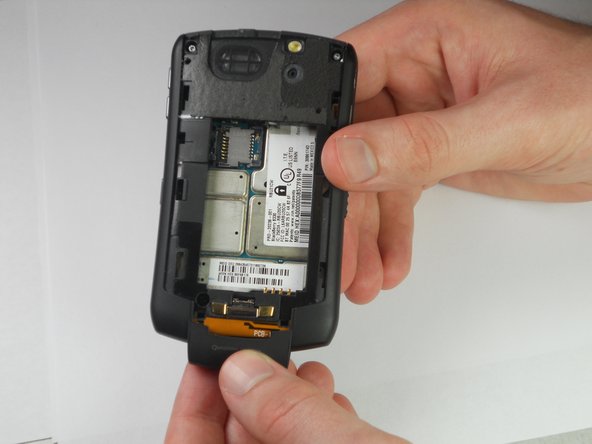

Add Note Edit Step 4  ¶
  • Use a plastic opening tool to pry the edges of the bottom cover until it snaps loose.
  • The cover will now pull off easily.
Image #1 Image #2

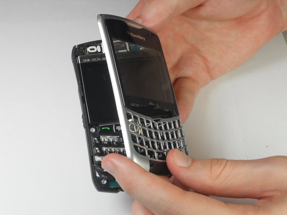

Add Note Edit Step 5  ¶
  • Use a plastic opening tool to pry between the front and back cover.
  • Start prying from wherever it is easiest to separate the silver and black plastic of the covers.
  • There are 5 securing clips on the front panel to disconnect.
  • Pry gently to prevent breaking the plastic clips when removing the front panel.
  • Once all the clips have been freed, the front cover will lift away from the phone.
Image #1

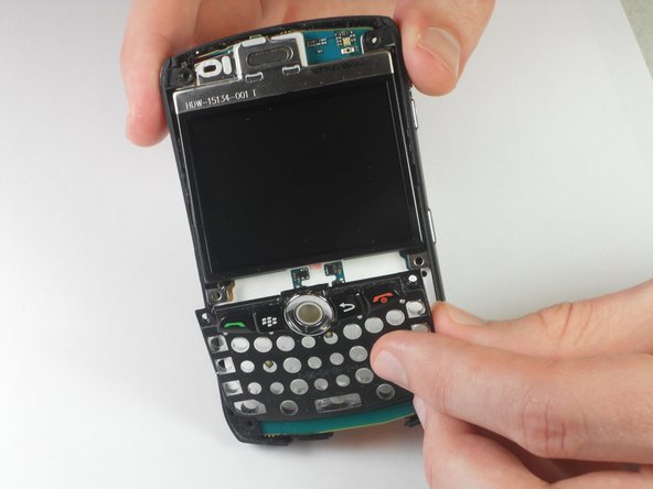

Add Note Edit Step 6  ¶
  • Lift the flexible keypad away from the device. It should come off easily.
Image #1 Image #2

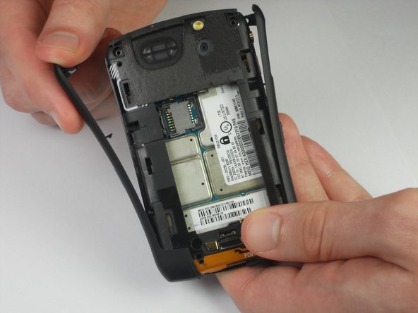

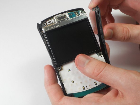

Add Note Edit Step 8 — LCD Panel  ¶
  • Detach each side casing by pulling them off gently from the phone.
