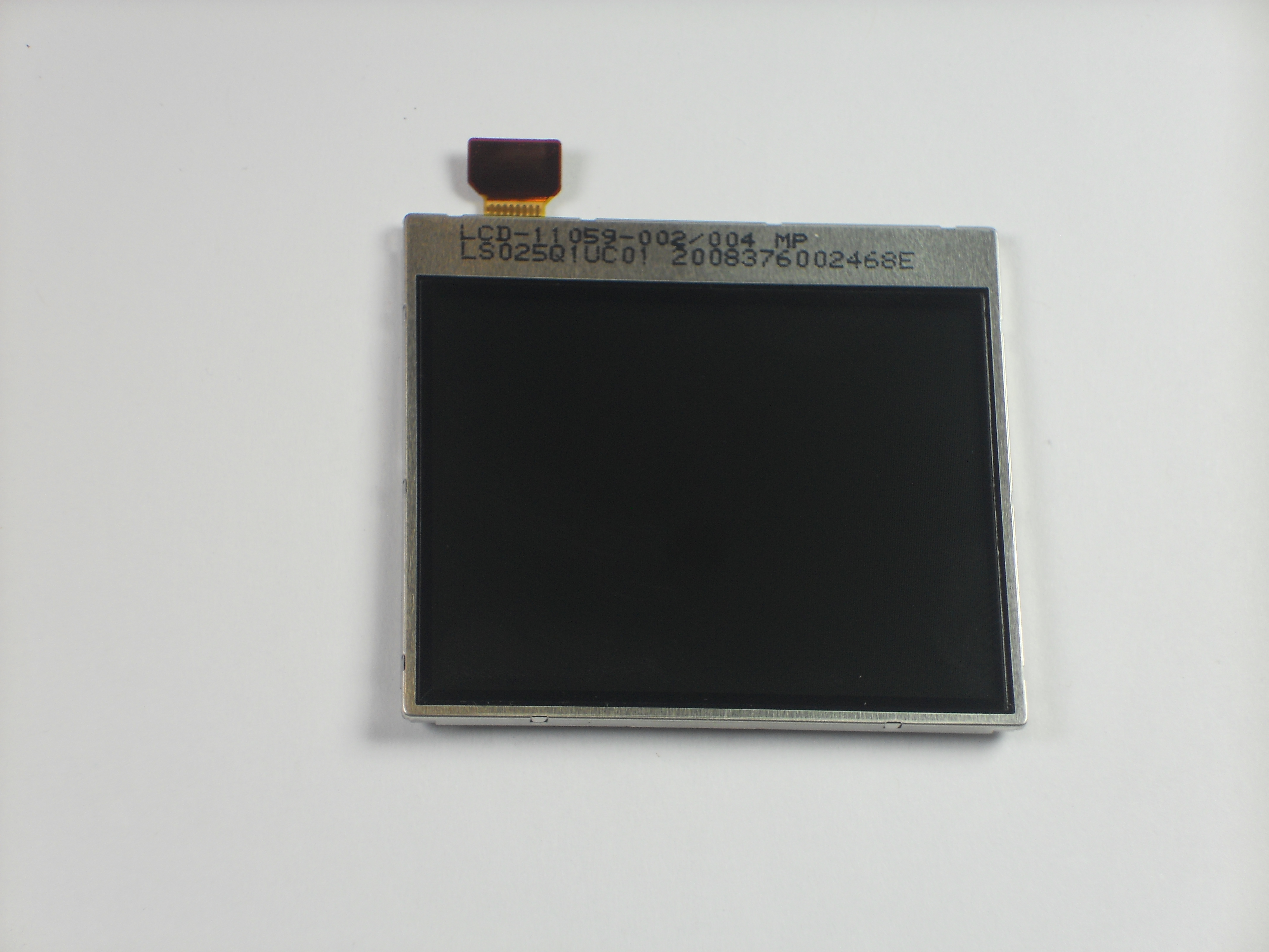

Replace a cracked or non-functional LCD panel.
  • Author: Joshua Ramos
  • Time required: 10 minutes
  • Difficulty: Easy
Sections
Image #1
Add Note Edit Step 1 — Remove Back Cover  ¶
  • We did not have an actual back cover or battery for the phone we were given. Therefore, the first couple of steps will be without pictures.
  • Hold the phone with the back side facing you.
  • Press down on the silver tab towards the bottom end of the phone.
  • Carefully lift up the back casing to reveal the battery.
Image #1
Add Note Edit Step 2 — Remove Battery  ¶
  • Put your finger on the top left corner of the battery and lift the battery up and out of its housing.
  • The phone should now look like this.
Image #1
Add Note Edit Step 3 — Keyboard  ¶
  • Remove the two top screws using a T5 Torx screwdriver.
Image #1 Image #2
Add Note Edit Step 4  ¶
  • Use a plastic opening tool to pry the edges of the bottom cover until it snaps loose.
  • The cover will now pull off easily.
Image #1 Image #2
Add Note Edit Step 5  ¶
  • Use a plastic opening tool to pry between the front and back cover.
  • Start prying from wherever it is easiest to separate the silver and black plastic of the covers.
  • There are 5 securing clips on the front panel to disconnect.
  • Pry gently to prevent breaking the plastic clips when removing the front panel.
  • Once all the clips have been freed, the front cover will lift away from the phone.
Image #1
Add Note Edit Step 6  ¶
  • Lift the flexible keypad away from the device. It should come off easily.
Image #1 Image #2
Add Note Edit Step 7  ¶
  • Use a T6 Torx Screwdriver to remove the four corner screws on the keyboard's housing.
  • Lift the keyboard frame away from the device.
  • There may be a small amount of adhesive at the bottom of the frame that needs to be pulled away.
Image #1 Image #2
Add Note Edit Step 8 — LCD Panel  ¶
  • Detach each side casing by pulling them off gently from the phone.
Next » « Previous
