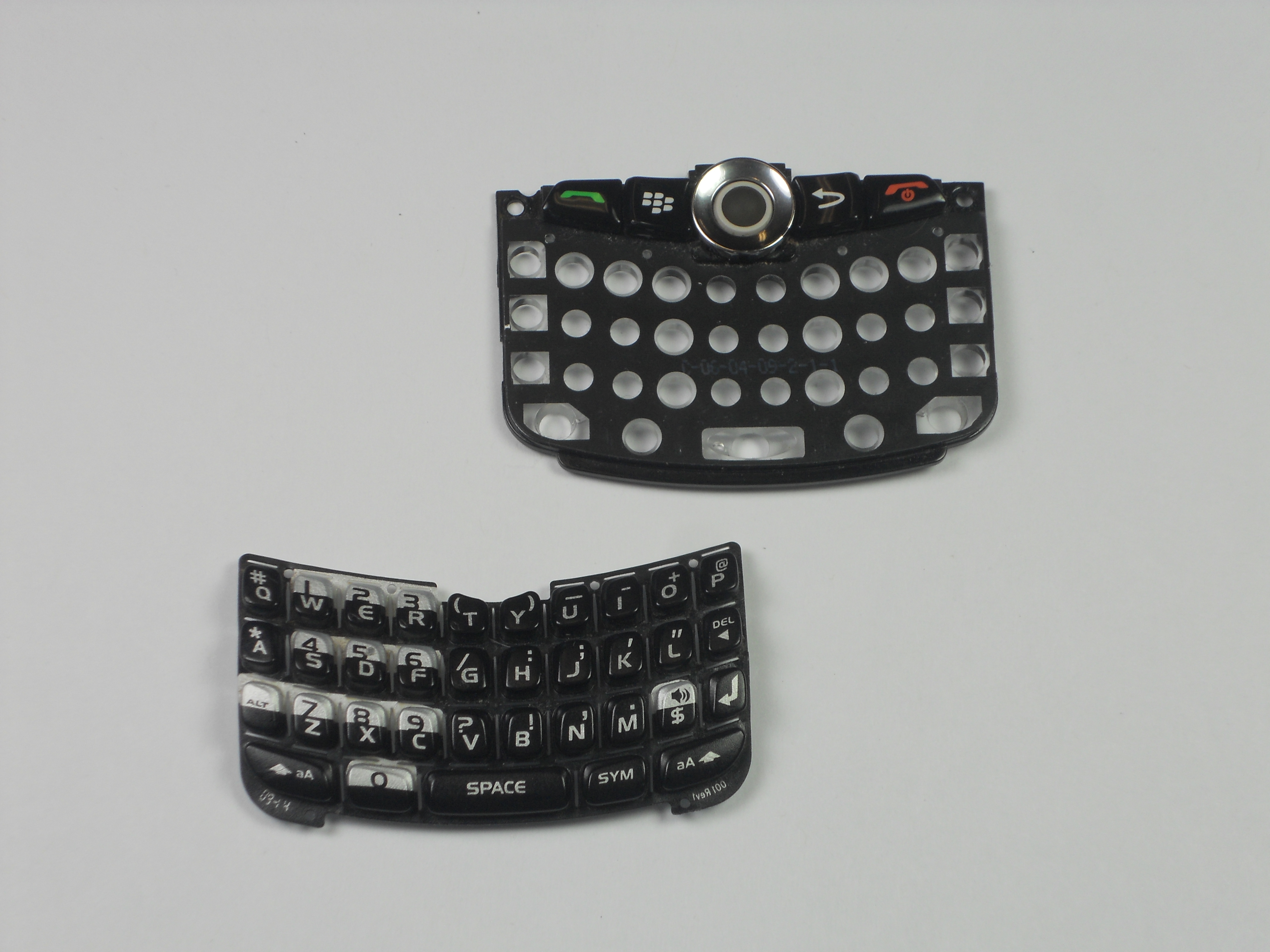

  • Lift the flexible keypad away from the device. It should come off easily.
Image #1 Image #2
Add Note Edit Step 7  ¶
  • Use a T6 Torx Screwdriver to remove the four corner screws on the keyboard's housing.
  • Lift the keyboard frame away from the device.
  • There may be a small amount of adhesive at the bottom of the frame that needs to be pulled away.
