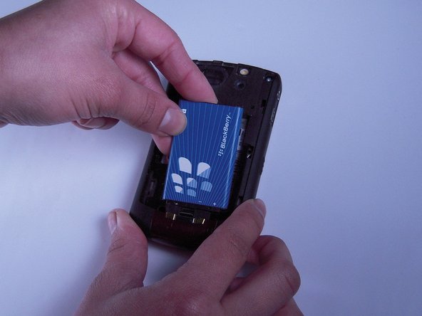

  • Pry from the top of the battery to pull it out.

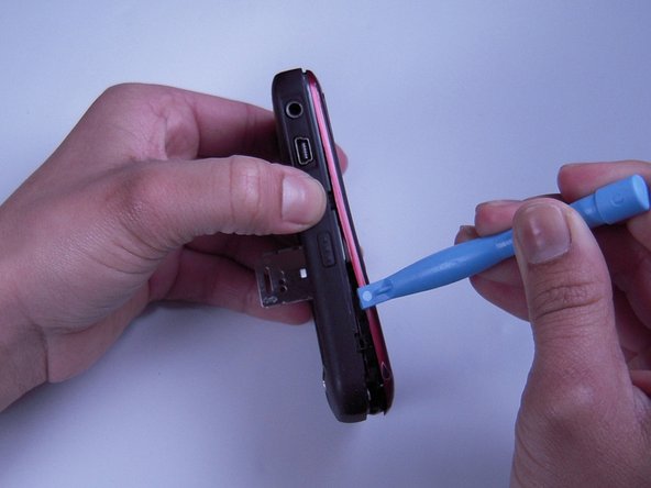

  • Remove the red cover at the bottom of the phone.
  • You may have to work a spudger underneath to release the plastic clips.

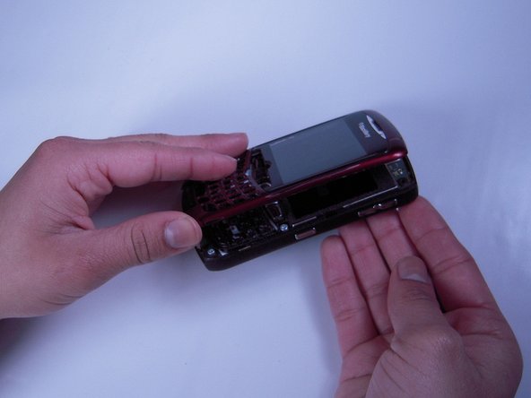

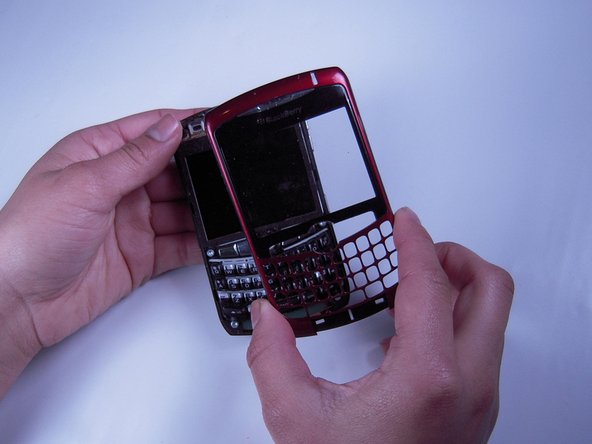

  • Be careful not to damage the front cover's plastic clips while trying to separate it from the phone.
  • Use a spudger to pry the front cover away from the side panels.
  • Work the spudger around the entire phone until the front cover is free.

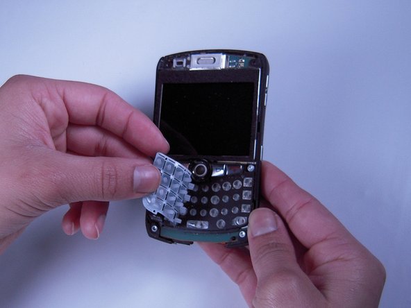

Add Note Edit Step 7 — Keyboard  ¶
  • Remove the keyboard.

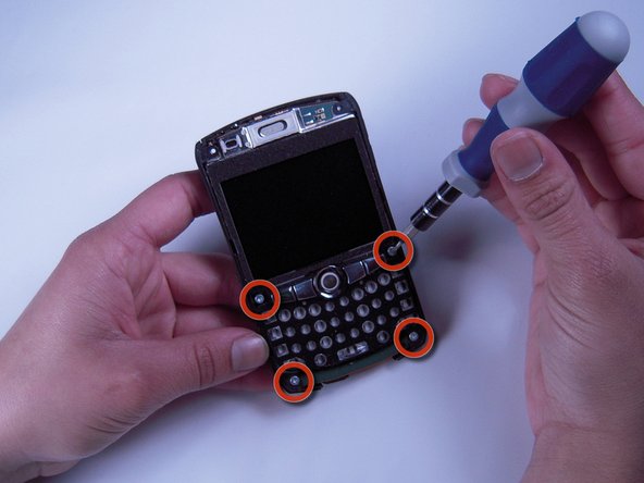

  • Remove the four T6 Torx screws located on the corners of the keyboard frame.
