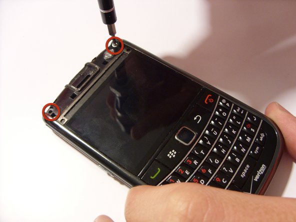

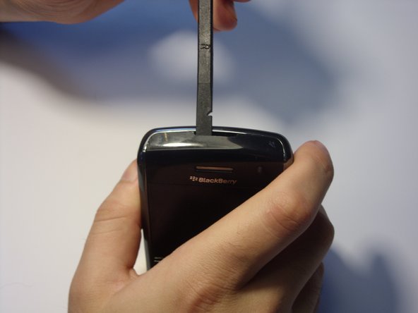

  • Turn the phone over. Using a pry tool, remove the ear piece cover.
Image #1
Add Note Edit Step 7  ¶
  • Remove the two torx srews.
Image #1

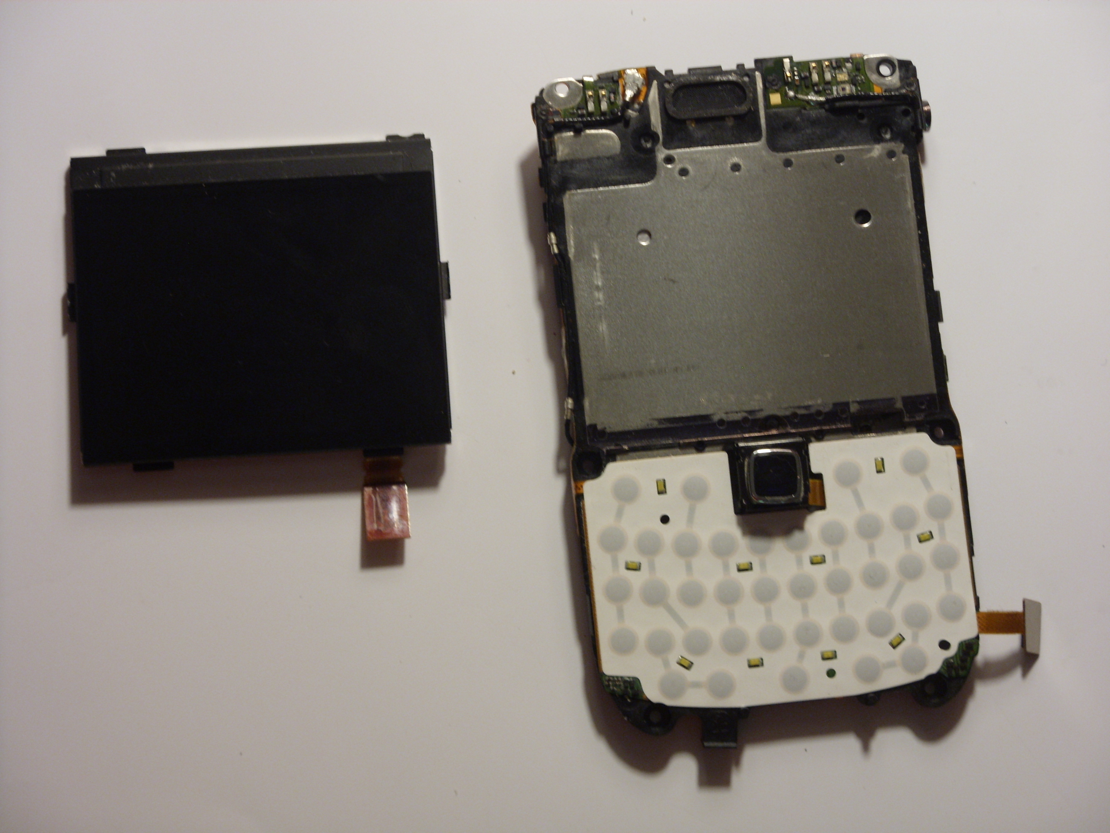

  • Remove the rear chassis by wiggling it back and forth.
  • Be careful around the headphone jack as it can break if pulled too forcefully.
