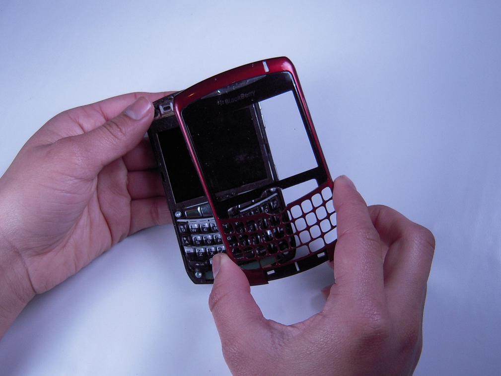

Add Note Edit Step 6  ¶
  • Be careful not to damage the front cover's plastic clips while trying to separate it from the phone.
  • Use a spudger to pry the front cover away from the side panels.
  • Work the spudger around the entire phone until the front cover is free.
