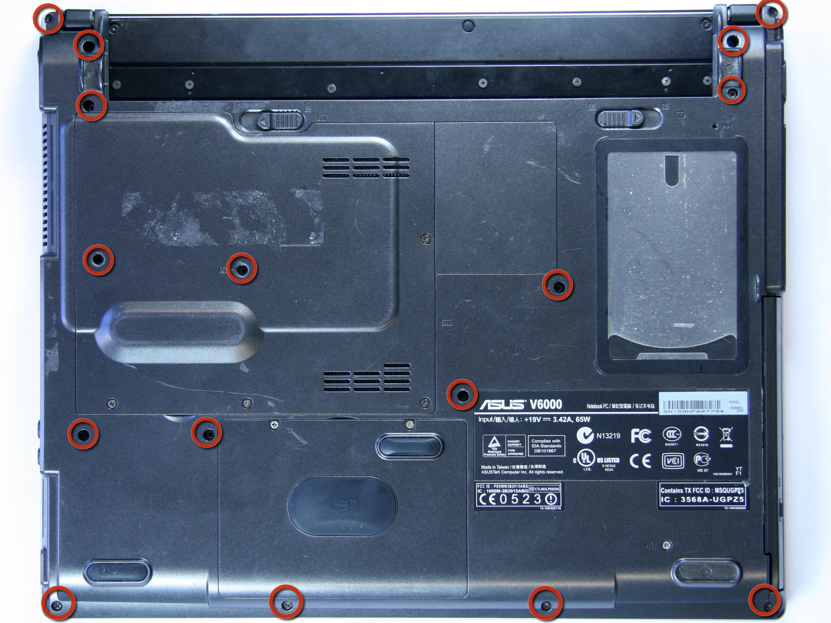

Add Note Edit Step 5 — Case and Motherboard  ¶
  • The screws on the bottom of the chassis need to be removed to remove the top panel. This will allow for the removal of the display from the rest of the computer.
Image #1
