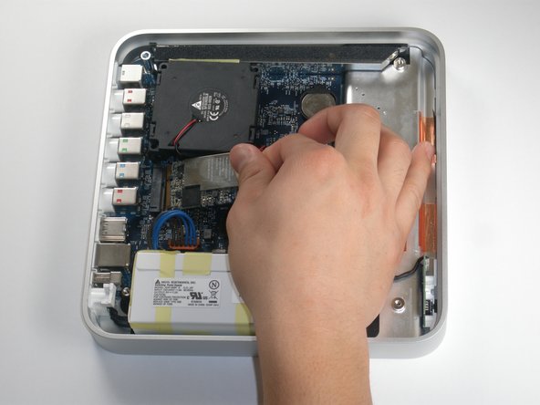

Add Note Edit Step 4  ¶
  • Carefully pull the hard drive data cable straight up from its socket on the logic board.
  • During reassembly, make sure the hard drive data cable is firmly seated in its socket on the logic board. Otherwise, during boot-up you will see a flashing question mark "?".

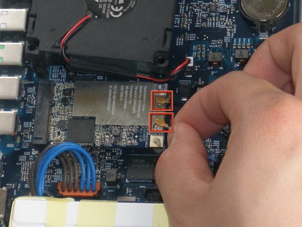

Add Note Edit Step 5 — AirPort Card  ¶
  • Pry the AirPort antenna cables straight up from their sockets on the logic board.
first image

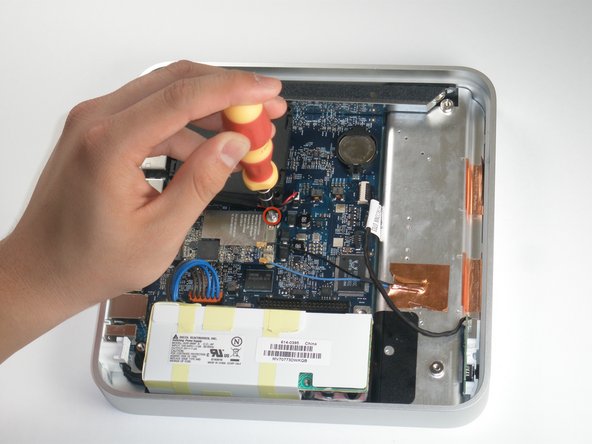

Add Note Edit Step 6  ¶
  • Remove the single T8 Torx screw securing the AirPort card to the logic board.
first image
Add Note Edit Step 7  ¶
  • Cautiously lift the AirPort card and pull it straight away slide from its socket on the logic board.
first image

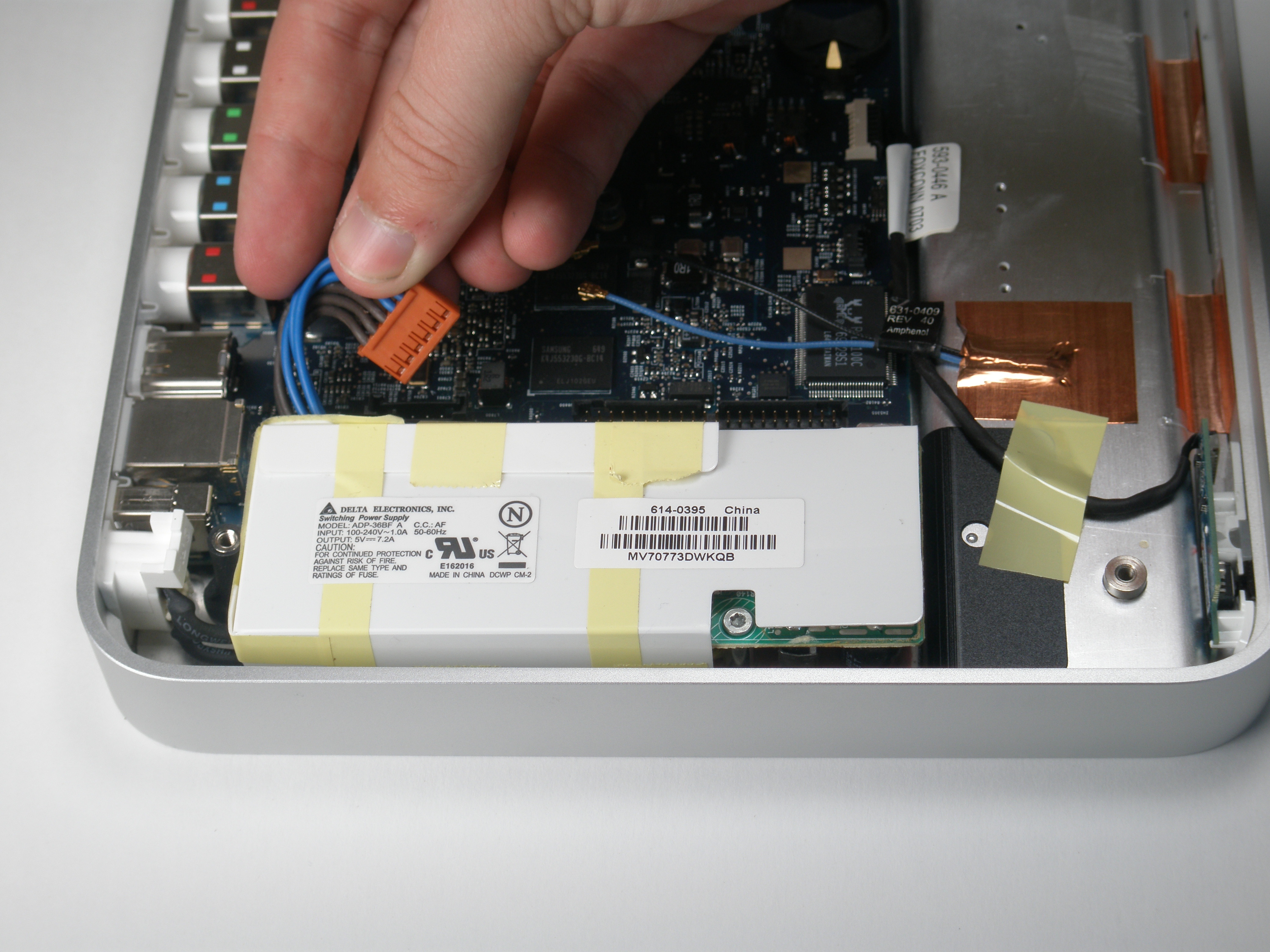

Add Note Edit Step 8 — Power Supply  ¶
  • Disconnect the power cable straight up from its socket on the logic board.
  • There is a release tab that must be pushed inwards in conjunction to release the power cable
  • Make sure to pull the connector straight up from its socket and not toward the face of the logic board.
first image
