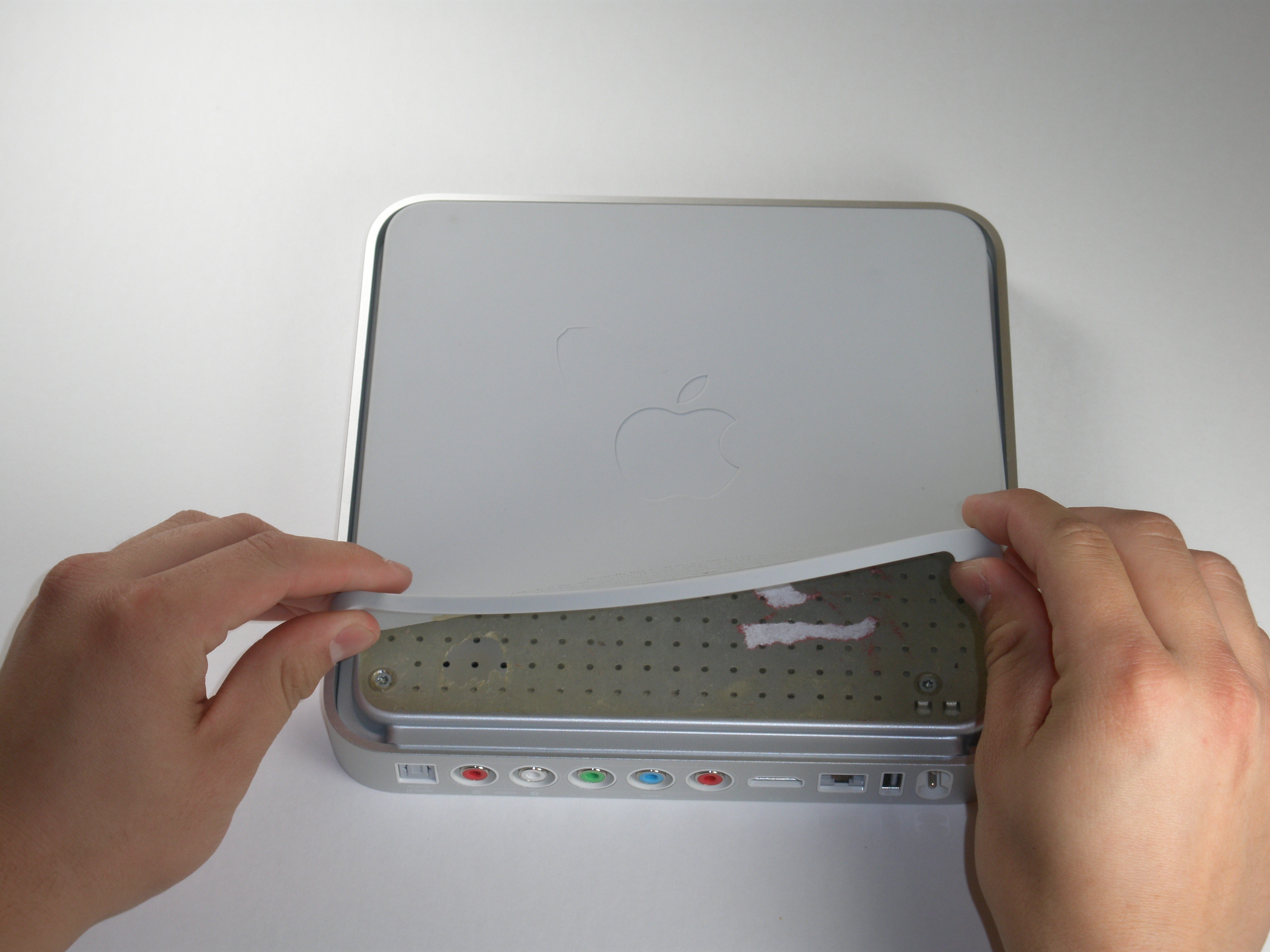

  • Flip the Apple TV over so that the bottom of the unit is facing up.
  • You need to remove the rubber base to get access to the screws.
  • Starting at one side of the device, use a hairdryer or a heat gun to soften the adhesive holding the rubber base in place.
  • The rubber base will be hot after heating, take extreme while proceeding.
  • While the adhesive is still warm, peel the bottom of the rubber base upwards to detach it from the metal plate.
  • Repeat the procedure described above until the rubber base has been completely removed.
