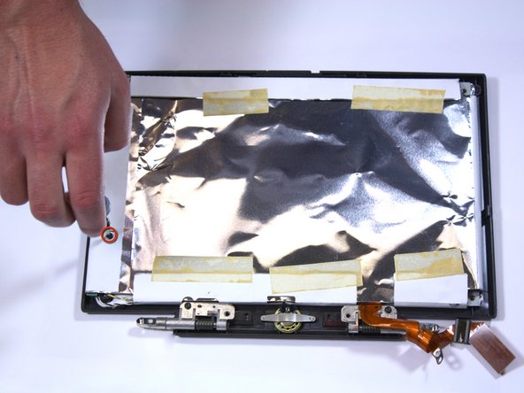

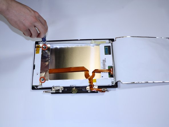

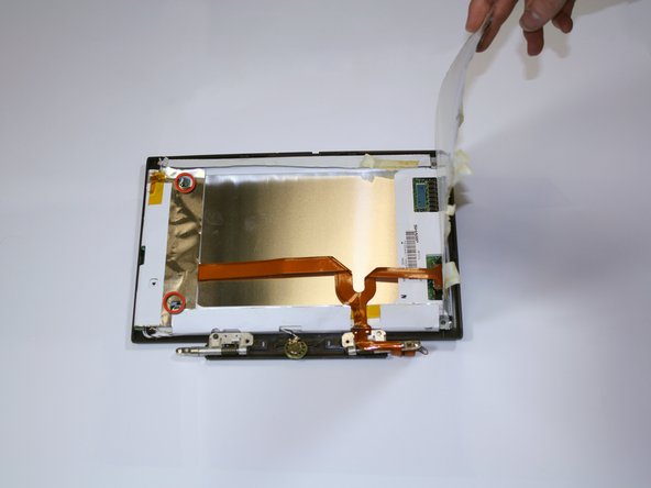

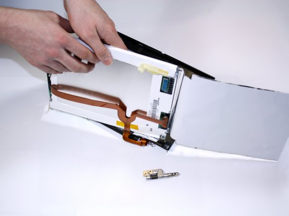

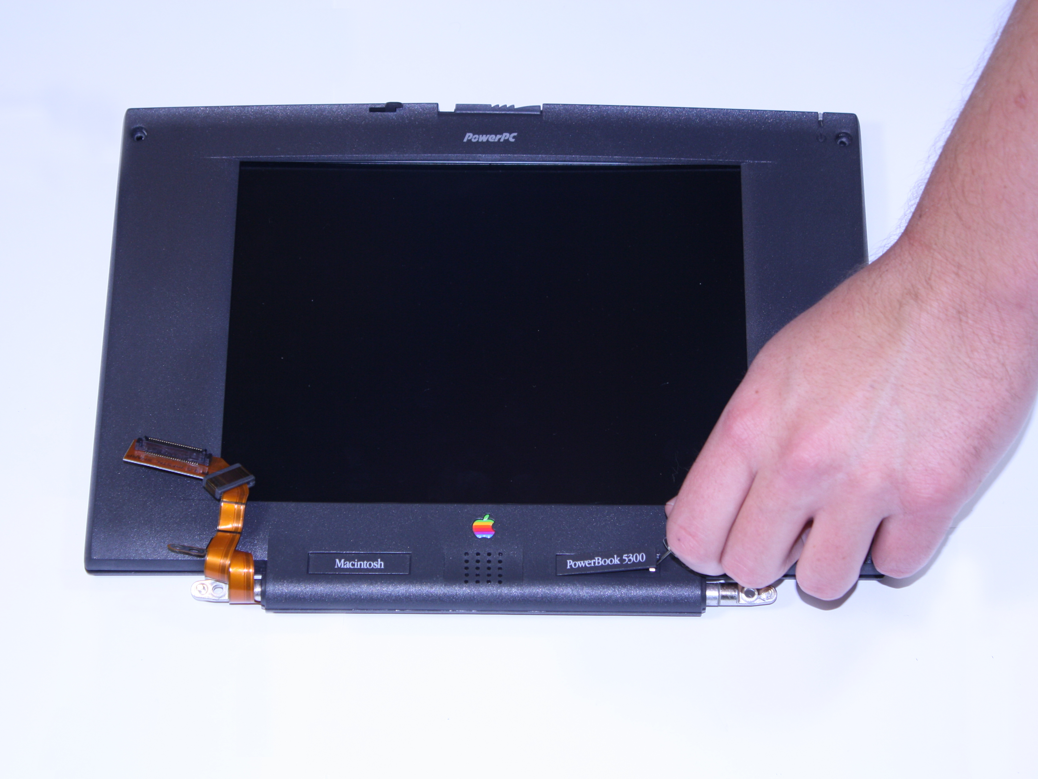

  • Unscrew the three torx #8 screws both above and below the white paper backing. You will need to remove the tape to peel back the paper backing and access the screws below it.
Image #1 Image #2 Image #3
Add Note Edit Step 10  ¶

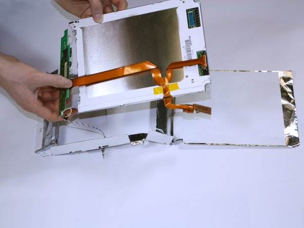

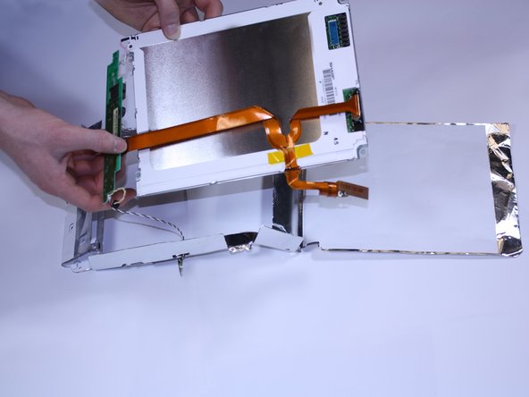

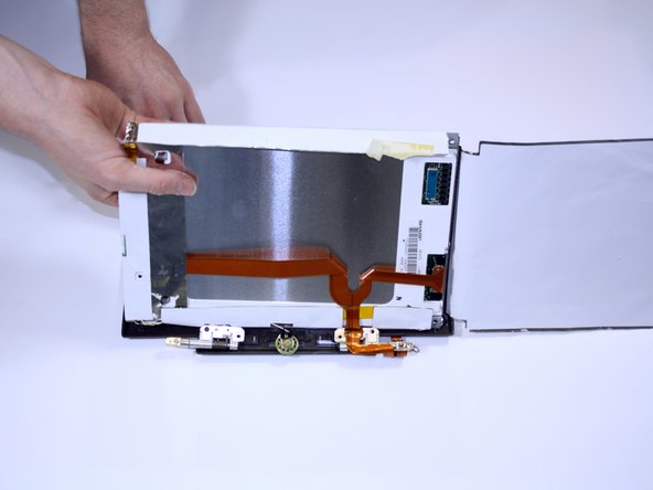

  • Lift the entire paper and monitor assembly out of its casing. Then lift the actual monitor out of its paper shell. Be careful not to rip the paper, and watch out for any other wires that might get caught. Especially watch out for the speaker cable which is connected to a speaker in the front of the monitor casing.
Image #1
Add Note Edit Step 11  ¶
  • All monitor components should now be visible. The transformer board is pictured on the left. The speaker is connected to this board and runs down through the paper housing.
