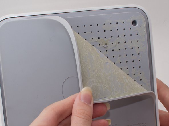

Add Note Edit Step 1 — Outer Case  ¶
  • First start by peeling off the outer rubbery covering on the bottom of the device.
  • CAUTION: This part is very fragile, so it is recommended that a blow dryer is used on the covering to heat it up. Simply blow dry the covering while slowly peeling it away, and the covering will not tear.

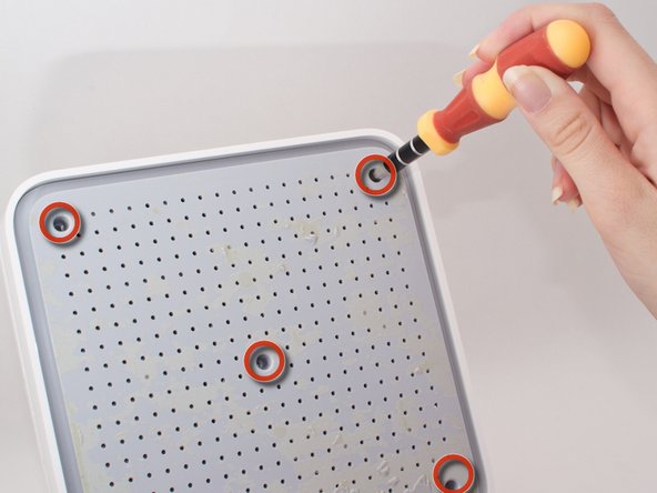

  • After removing the rubber covering, unscrew the five 4.9mm Phillips screws in the holes of the plastic casing.

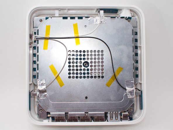

Add Note Edit Step 3  ¶
  • After unscrewing all five screws, remove the plastic casing. The back should now look like the picture shown.

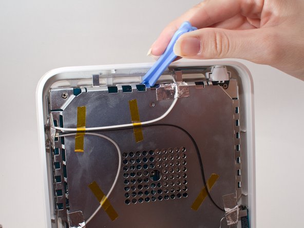

Add Note Edit Step 4  ¶

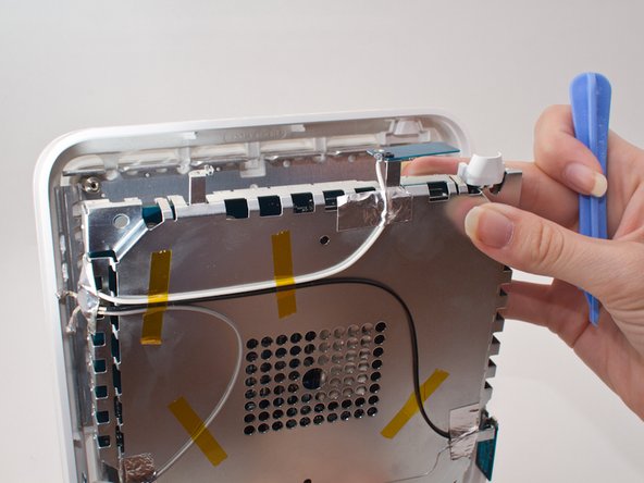

  • The inner metal casing is latched inside the outer white plastic shell, so insert a pry tool underneath the metal casing and pry it apart from the shell.
  • It should make a click when it comes apart.

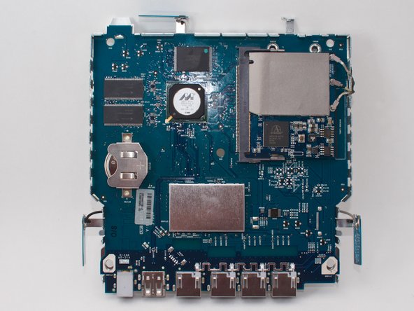

  • Remove the outer casing.
  • The exposed logic board should look like this.

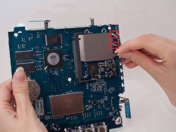

  • Wires come from the three antennas and connect on the outer edge of the WiFi card.
  • Carefully pull up on the end of one of the wires to disconnect it from the motherboard.
  • Do this for the remaining two wires.

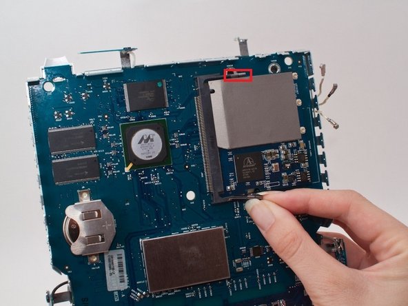

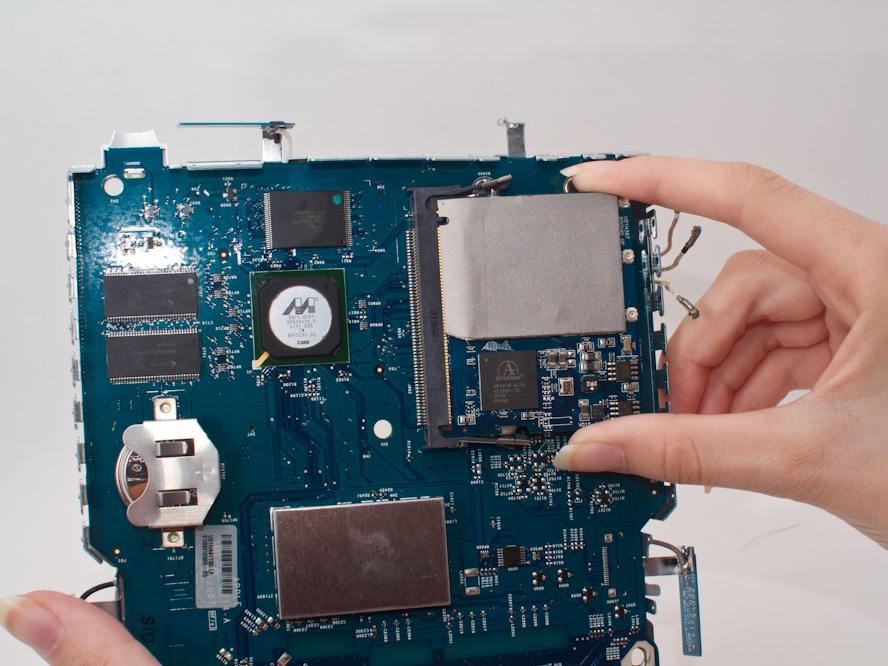

  • There are two clips attached to the upper and lower ends of the WiFi card
  • CAUTION: For the following step, do not pull the clip after you have detached it. The clip is fragile and too much force may cause the clip to break.
  • Grab the end of one of the clips and pull away from the WiFi card. This should make the clip visibly detached from the WiFi card.
  • Do the same for the other clip.
