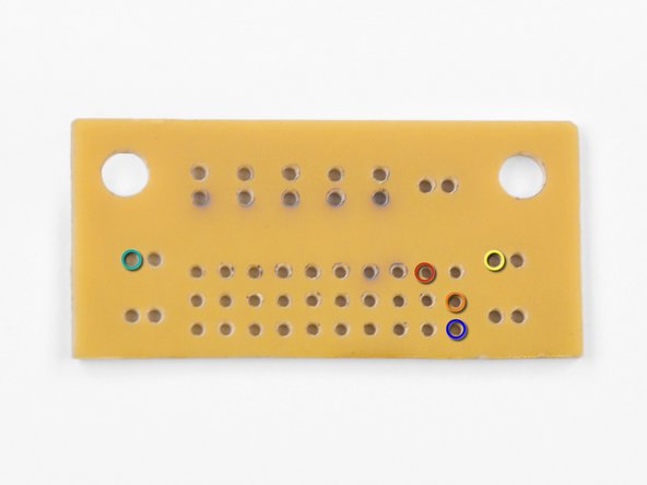

  7. Apple AirPort Express Base Station Power Supply Kit: step 7, image 1 of 1
    • The following are the suggested hole locations for components, though they can be placed in any hole along the proper traces.
    • .1 µF Capacitor
    • 1 µF Capacitor
    • 240 Ω Resistor
    • 390 Ω Resistor
    • Voltage Regulator Pin 1
    • Voltage Regulator Pin 2
    • Voltage Regulator Pin 3
  8. Apple AirPort Express Base Station Power Supply Kit: step 8, image 1 of 1
    • The power inlet and outlet wires are recommended to be soldered in the following locations, though again they can be soldered to any through-hole you desire along the proper trace.
    • Power Supply +
    • Power Supply -
    • 5 V Out
    • 3.3 V Out
    • Ground Out

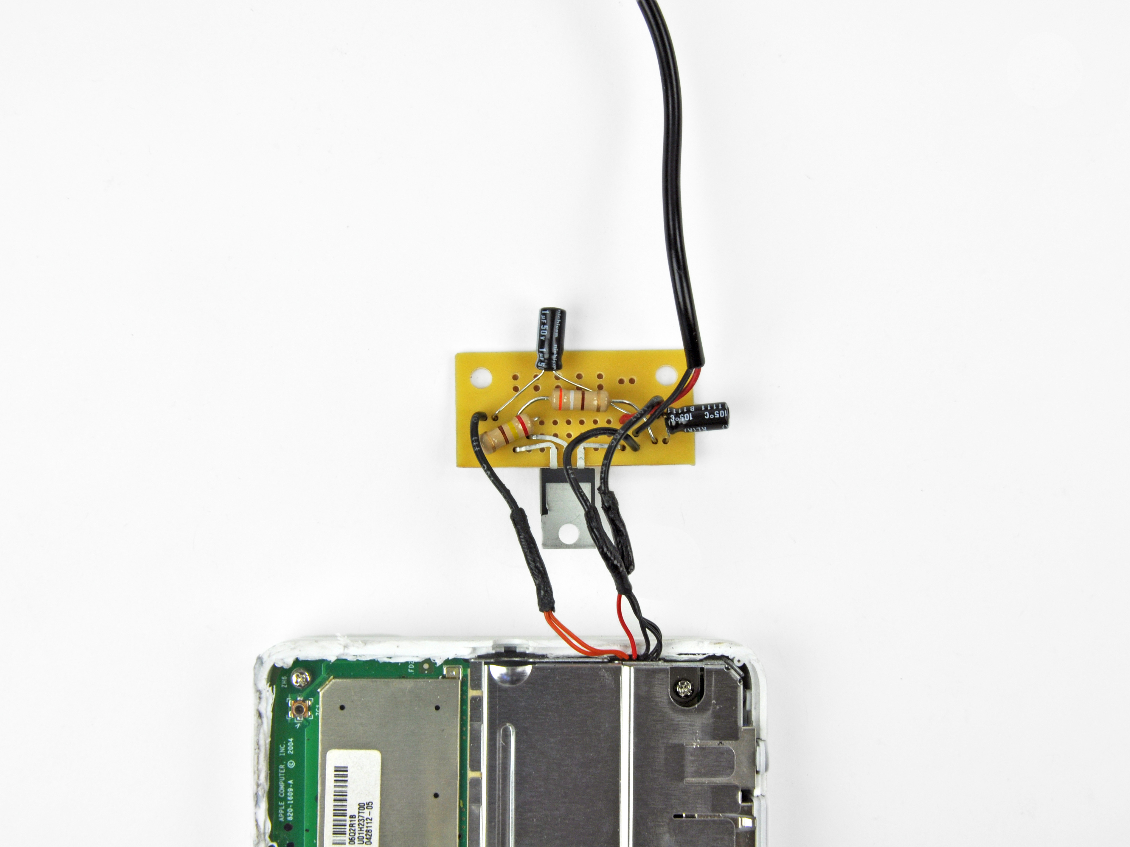

  29. Apple AirPort Express Base Station Power Supply Kit: step 29, image 1 of 1
    • Insert and solder the wires from the AirPort board into the appropriate holes of the PCB.
    • The red-wired lead goes to the 5 V out hole from step 8.
    • The orange-wired lead goes to the 3.3 V out hole from step 8.
    • The black-wired lead goes to the ground out hole from step 8.
    • After soldering these wires is the perfect time to give your new power supply a quick test. Plug in the power supply and see if the LED on the lower case half turns on. If it does, your power supply is working. If it doesn't, quickly unplug the power supply and recheck all your connections.
    • You can test output using a multimeter and checking the voltage at the red (5 V) and orange (3.3 V) wire solder joints and using the black wire solder joint as ground. Variations of no more than .3 V is acceptable.
