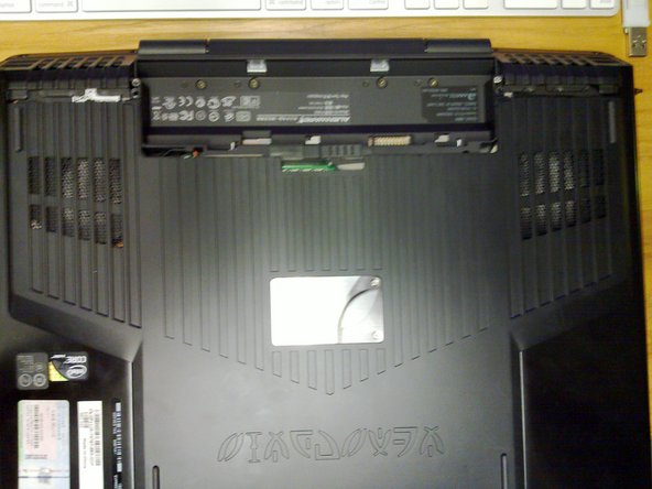

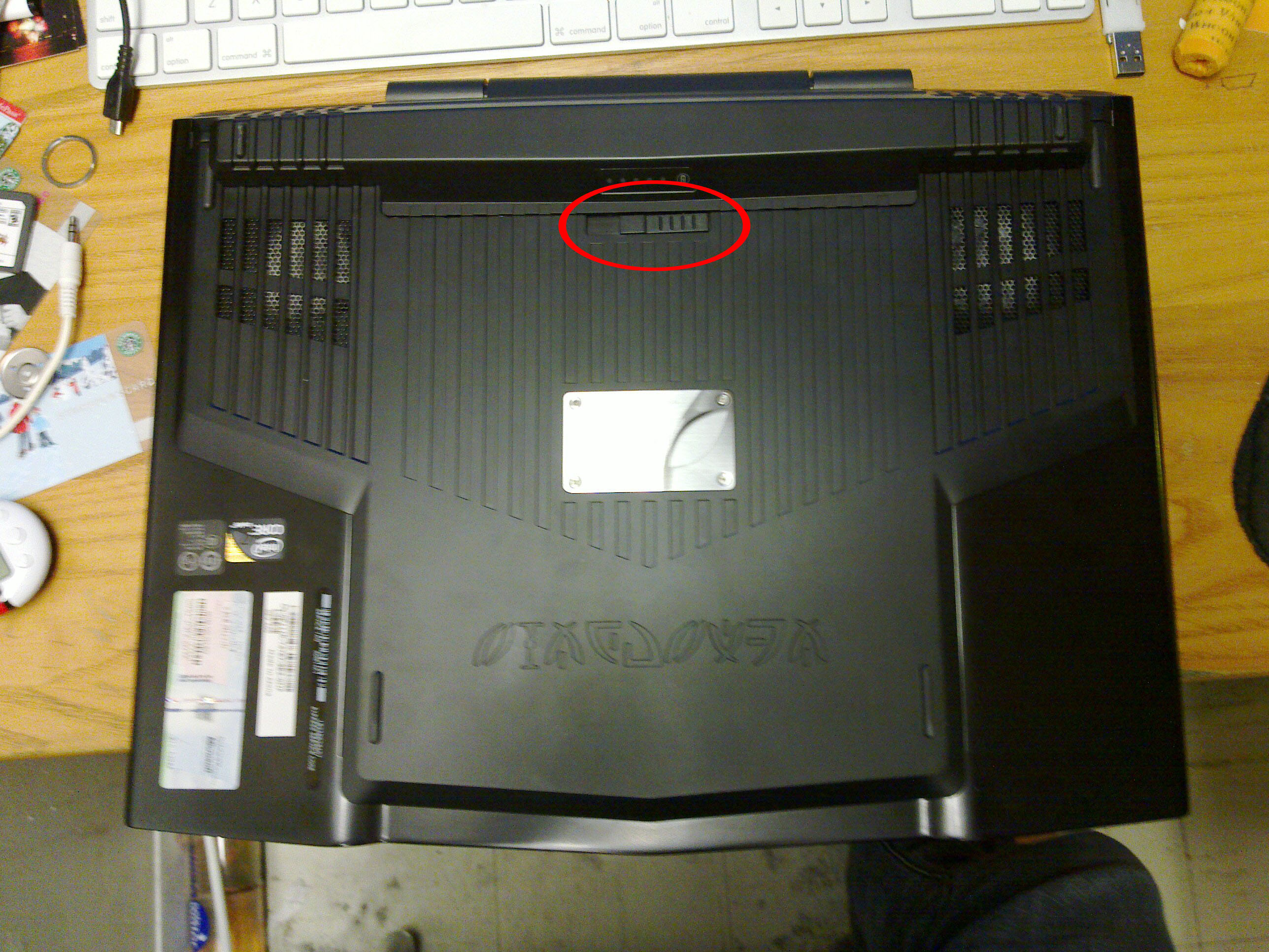

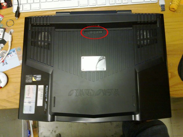

  • First, take off the battery by moving the latch to the left and pulling it up.
Image #1 Image #2 Image #3

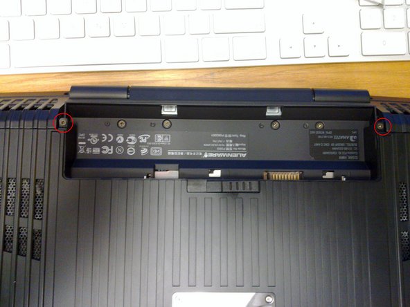

  • Then unscrew the two Phillips screws.
  • Pull the cover down, then up, revealing the internals
Image #1 Image #2

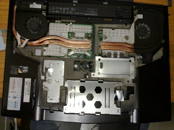

  • Unscrew the four screws indicated
  • Pull on the tab that says "Pull" and remove the Hard Drive
Image #1 Image #2

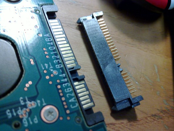

  • With even pressure on both sides, take off the SATA converter and then connect it to the drive you would like to replace it with.
