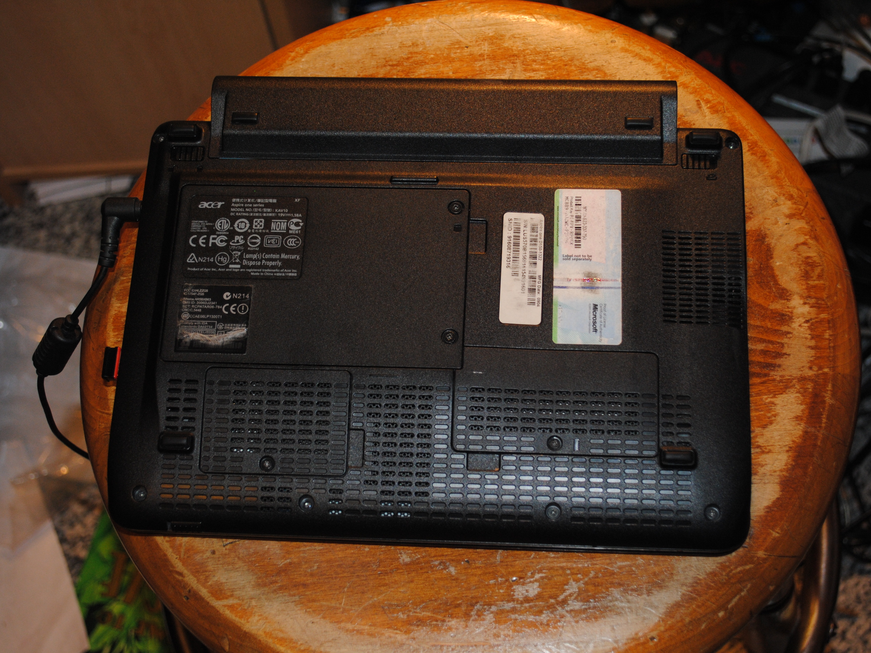

Image #1
Add Note Edit Step 1 — Memory Upgrade  ¶

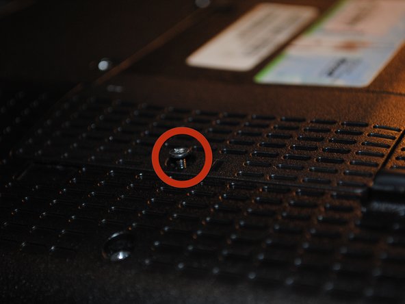

  • Be sure computer is unplugged, turned off, and battery is removed.
  • Then, locate memory door and remove screw with #0 Phillips screw driver.
Image #1
Add Note Edit Step 2  ¶

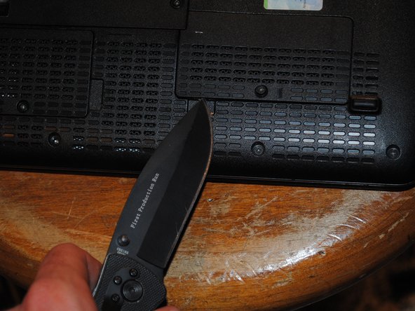

  • If needed, pry open door using knife or flat screw driver.
Image #1 Image #2 Image #3
Add Note Edit Step 3  ¶

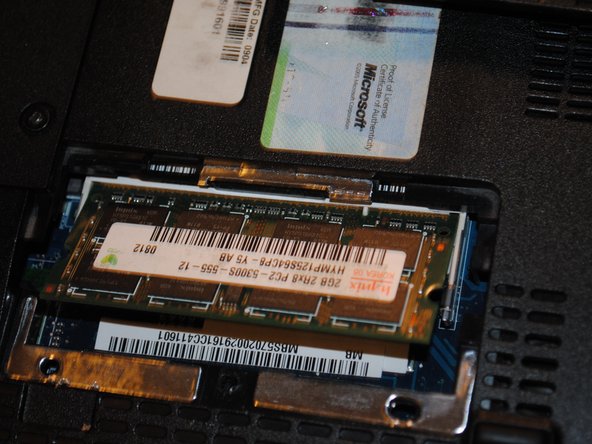

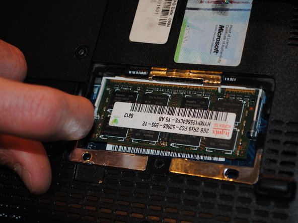

  • Remove plastic door to expose lone memory DIMM.

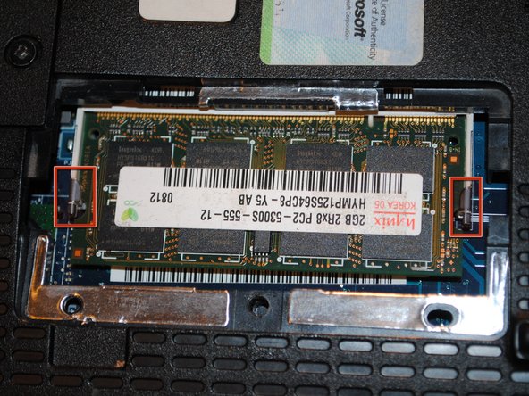

  • Press two metal clasps on both sides of the DIMM apart to allow memory module to pop up.
Image #1
Add Note Edit Step 4  ¶

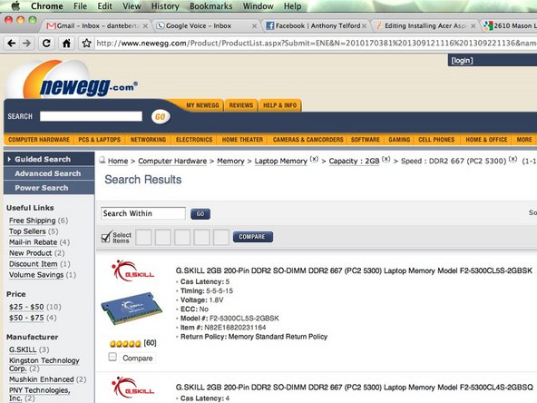

  • Head over to Newegg and buy yourself a 2gb DDR2, 667mhz laptop memory to install in your Aspire One.
