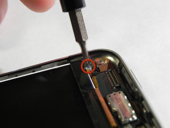

  • Remove the Phillips screw in the top left corner attaching the metal tray to the rear panel.
Image #1 Image #2

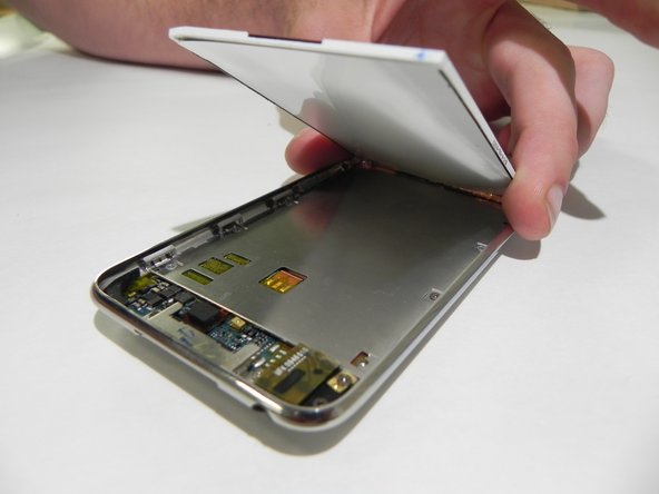

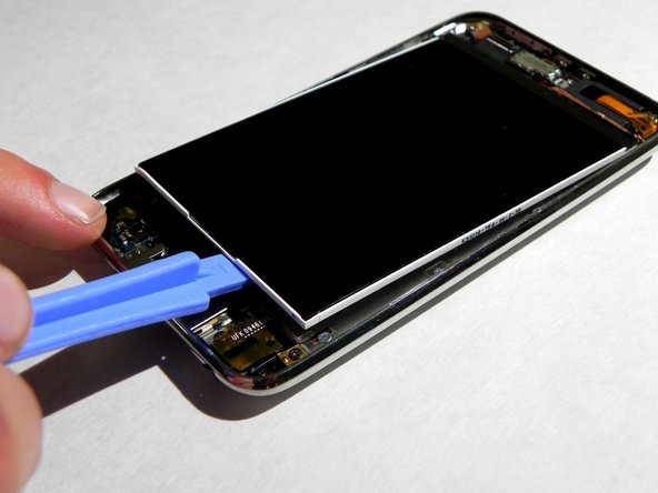

  • Insert a PX 3688 plastic opening tool with the edge angled up toward the underside of the display between the white plastic backlight and the metal beneath it.
  • Pry the lower edge of the display up until it's at about a 45 degree angle with the rest of the iPod.
  • Hold the display in this position with one hand for the next step to avoid damaging the display ribbon cable.

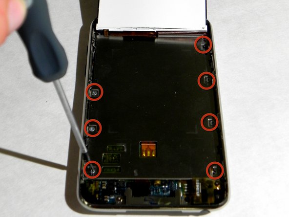

  • Remove the seven Phillips screws securing the metal display tray to the rear panel with a Phillips 00 screwdriver.
  • Keep track of them for reassembly. The two darker screws belong in the holes in the tray nearest the bottom edge.

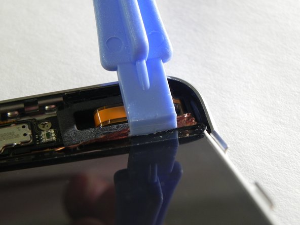

  • Use a PX 3688 plastic opening tool to peel the copper tape off the top edge of the display.
  • Don’t peel off the copper tape that’s attached to the metal display tray.
