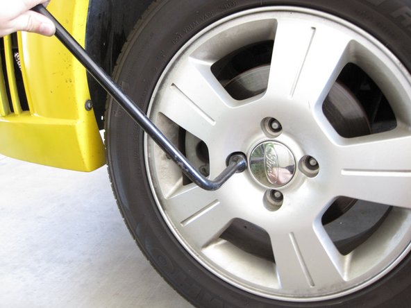

Add Note Edit Step 2  ¶
  • Use a 19 mm lug wrench to loosen each lug nut a half turn.
Image #1 Image #2

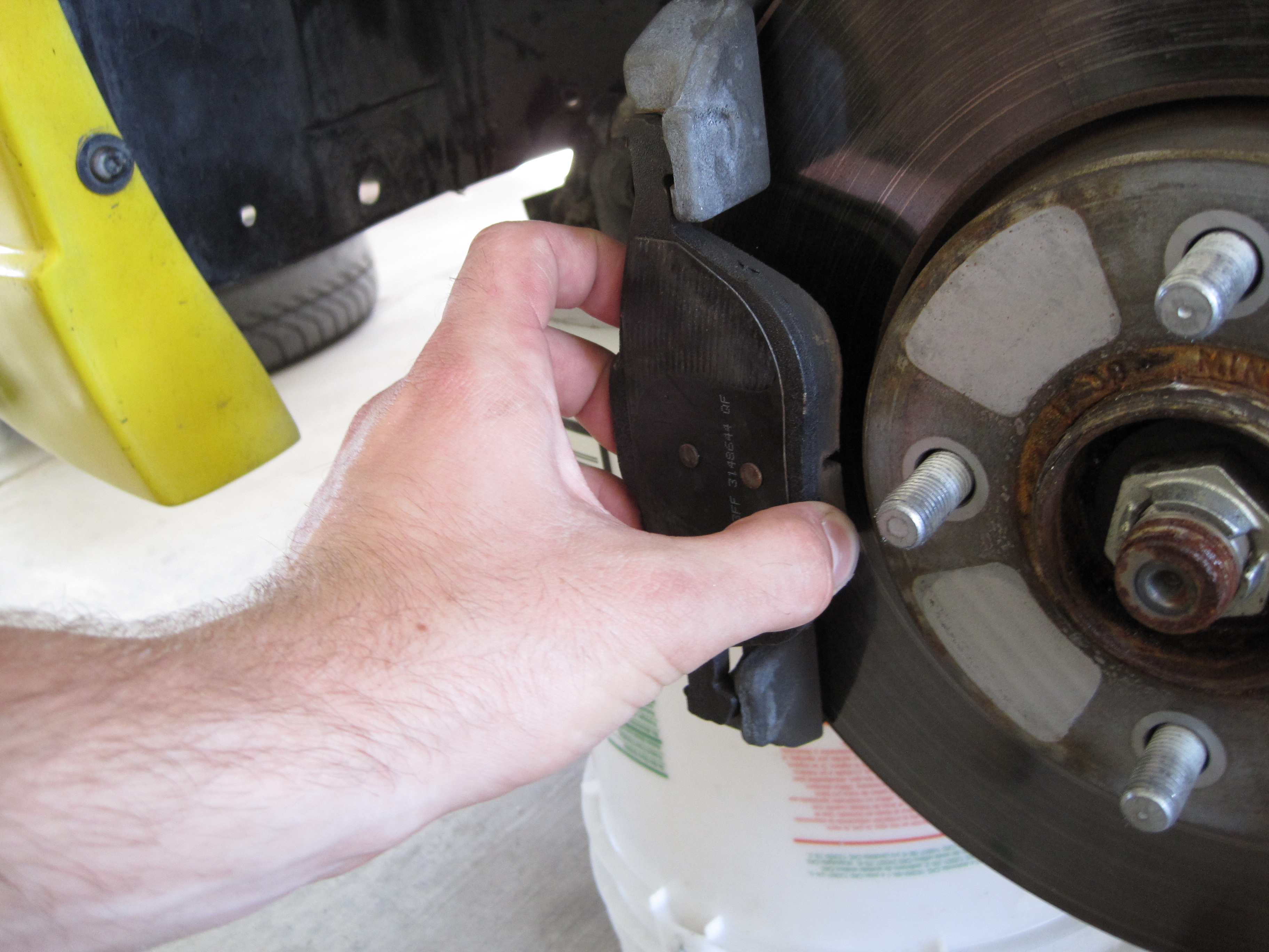

Add Note Edit Step 8  ¶
  • Use a flat head screwdriver or brake spoon to remove the outer pad retaining clip.
  • The clip has a lot of spring energy. Hold onto it with a pair of pliers when removing it to keep it from flying off and injuring someone.
