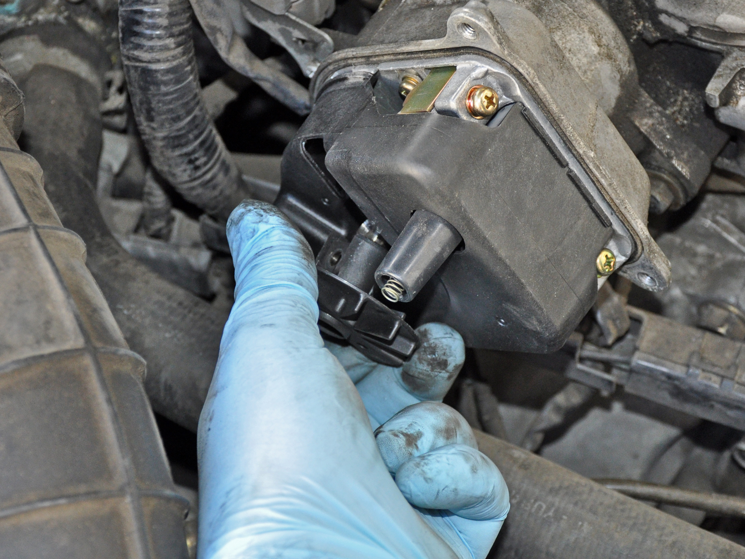

Add Note Edit Step 1 — Distributor Cap  ¶
  • Before disconnecting the spark plug wires, be sure to trace their orientation from the individual cylinders back to the distributor cap.
  • The cylinders are ordered from left to right when viewing the engine from the front of the car, with cylinder #1 being closest to the passenger side of the vehicle.
  • Mark the order of the spark plug wires on the new distributor cap with a silver sharpie marker -- it will make reinstallation much easier.
Image #1
Add Note Edit Step 2  ¶
  • Disconnect the four spark plug wires from the distributor cap by pulling their connectors straight away from the sockets on the distributor cap.
  • It may be helpful to slightly twist the wires as you pull them.
Image #1 Image #2
Add Note Edit Step 3  ¶
  • Use a 1/4" drive, 8 mm deep socket to remove the three hex bolts securing the distributor cap to the engine.
  • The position of the third bolt is not visible in the second picture.
Image #1
Add Note Edit Step 4  ¶
  • Pull the distributor cap away from the engine and set it aside.
Image #1 Image #2
Add Note Edit Step 5  ¶
  • Use a dental pick or a small screwdriver to gently remove the D-shaped o-ring around the distributor cap flange.
  • Install a new o-ring in the seal recess, making sure that it is sitting flush against the flange.
Image #1 Image #2
