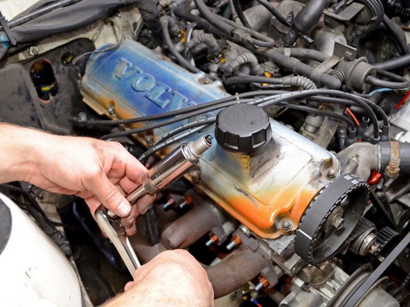

  • Before removing the spark plug, used compressed air to clear the area around the plug of any dirt or debris.
    • It's important to keep debris out of the cylinders, as it could cause serious engine damage.

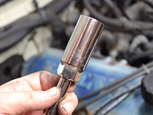

  • Place a 13/16" spark plug socket over the spark plug and make sure the spark plug is securely seated in the socket.
    • Spark plug sockets have a rubber seat that protects the brittle spark plug when it's being removed from the engine.
  • Gently loosen the spark plug by slowly turning the wrench counterclockwise. Once the spark plug is free, remove it and set it aside.
    • Never use air tools to remove spark plugs, as the large amount of torque will break the spark plugs while they are still in the engine.

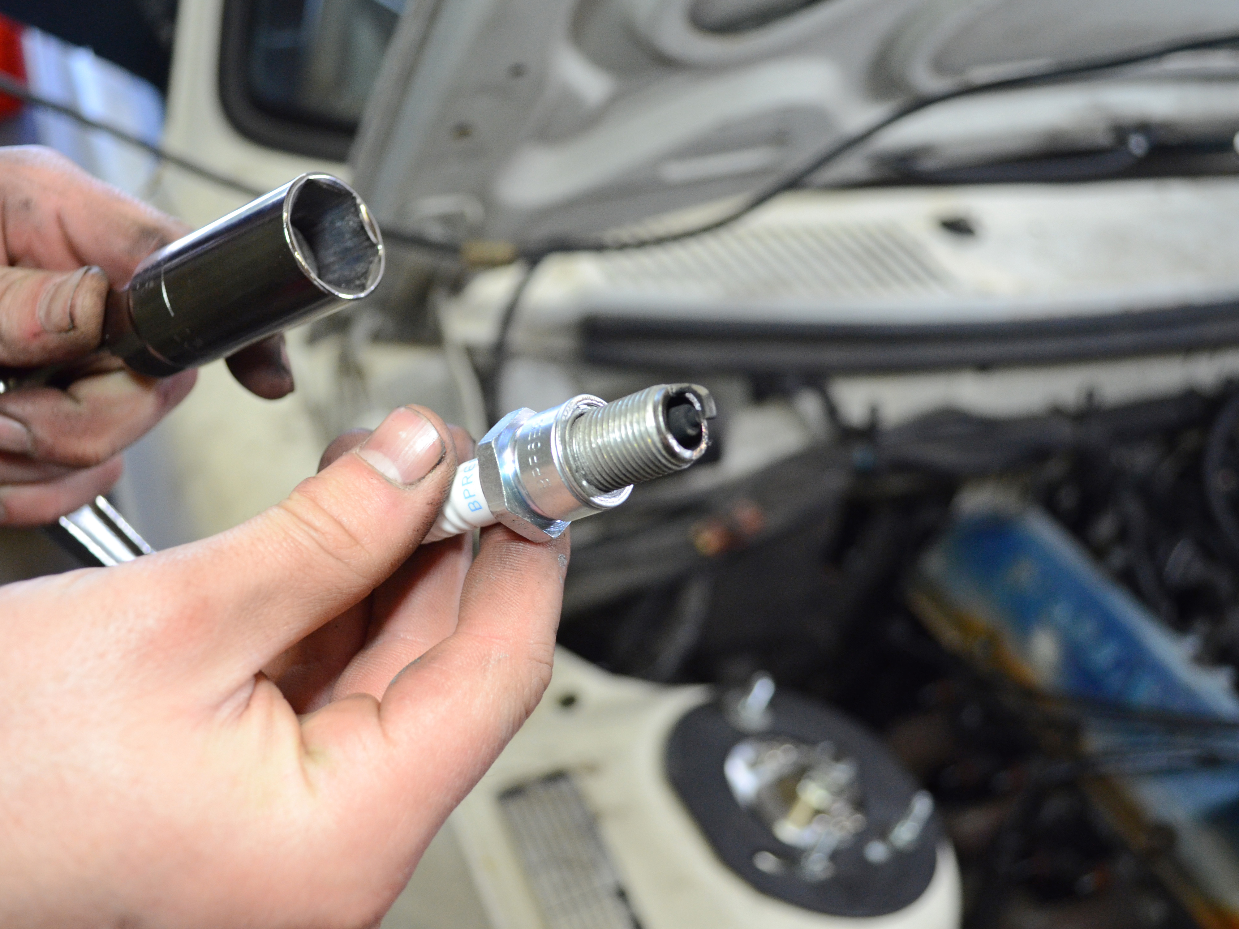

  • In order to fire correctly, the gap between the two electrodes on the new spark plug must be properly set. Use a gap tool to adjust the side electrode (the one that hovers over the center electrode) until the gap is between 0.028" and 0.032".
  • Before installing the spark plug, cover the threads with a thin layer of anti-seize compound. This will ensure that the spark plugs come out easily at the next change.
    • Be sure not to get any anti-seize compound on the electrodes, as this could inhibit firing.
  • Place the spark plug into the spark plug socket until it is firmly seated and reinstall it into the engine. Work slowly to avoid cross-threading. Tighten the plug until it is finger-tight and then provide an additional 1/2 turn with the wrench (about 20 ft-lbs).
