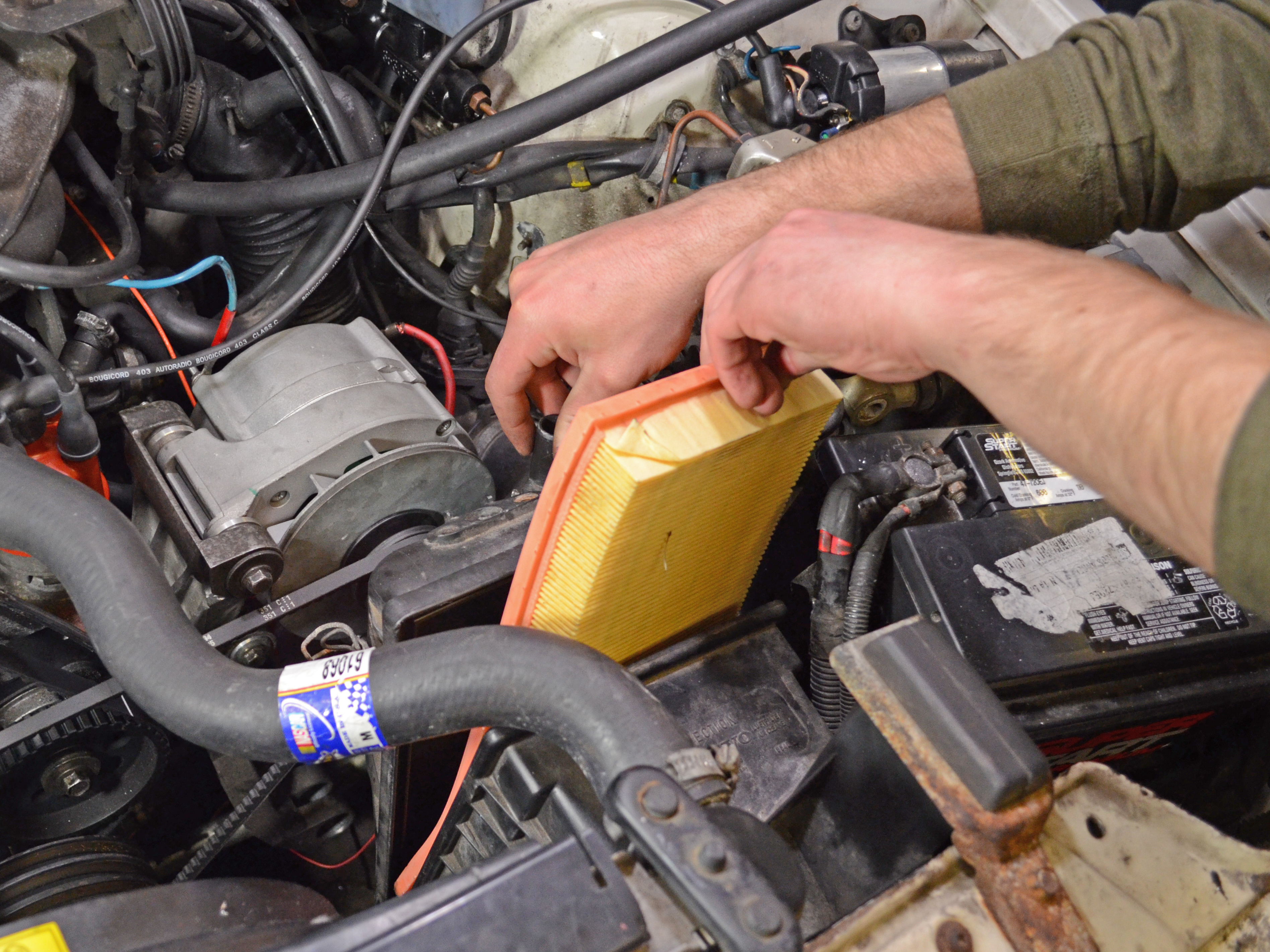

Image #1
Add Note Edit Step 1 — Engine Air Filter  ¶
  • The engine air filter housing is located at the front of the engine bay, between the engine and the radiator.
  • Open the lid of the filter housing by releasing the metal clips along the edge of the lid.

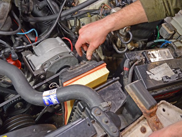

Image #1 Image #2
Add Note Edit Step 2  ¶
  • Once the clips are released, pull the lid away from the air filter housing.
  • Grab the air filter and remove it from the filter housing.
  • Be sure to install the new air filter in the same orientation as the old one.
