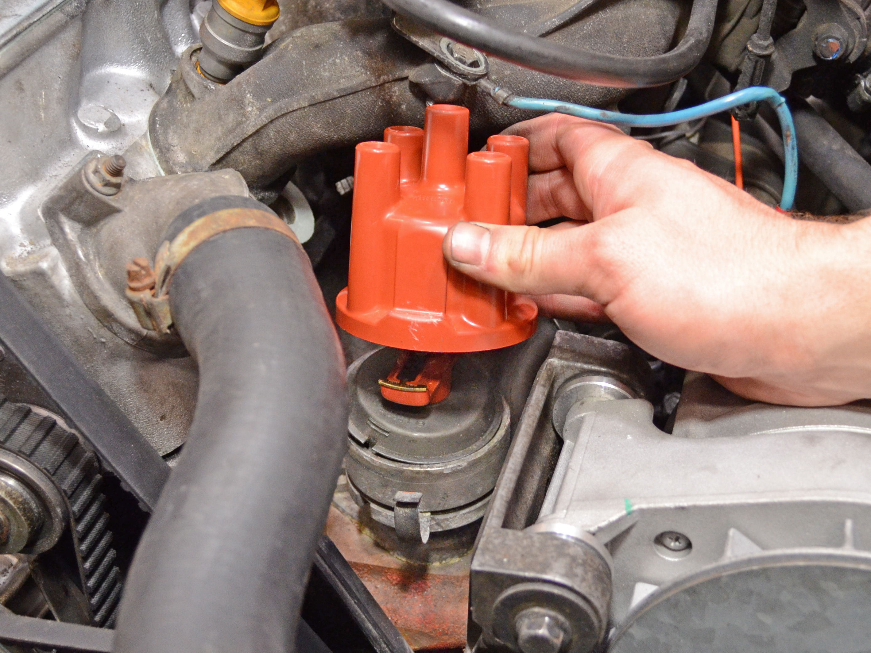

  • The distributor cap is located next to the engine and has all of the spark plug wires connecting to it.
  • Pull straight up on the ignition coil wire in the center of the distributor cap to disconnect it.
Image #1 Image #2 Image #3
Add Note Edit Step 2  ¶
  • Connect the spark plug wires to the new distributor cap one at a time. Mixing up the order will result in the engine not firing properly or at all.
  • Pull straight up on the boot of the first spark plug wire to disconnect it from the distributor cap.
    • Be sure to pull on the boot and not the wire itself. Spark plug wires are quite fragile and may break easily.
Add Note Edit Step 3  ¶
  • Install the spark plug wire onto the new distributor cap and make sure it is seated properly.
  • Continue to transfer each spark plug wire to the new distributor cap, maintaining the same arrangement of wires on the cap.
  • Once all of the spark plug wires have been installed on the new distributor cap, set the cap aside.
Image #1 Image #2
Add Note Edit Step 4  ¶
  • Use a flathead screwdriver to release the clip securing the distributor cap.
    • Only one side of the distributor cap has a spot for the clip to rest. The new cap must be installed in the same orientation.
  • Remove the old distributor cap.
  • When installing the new distributor cap, don't forget to reconnect the center ignition coil wire.
