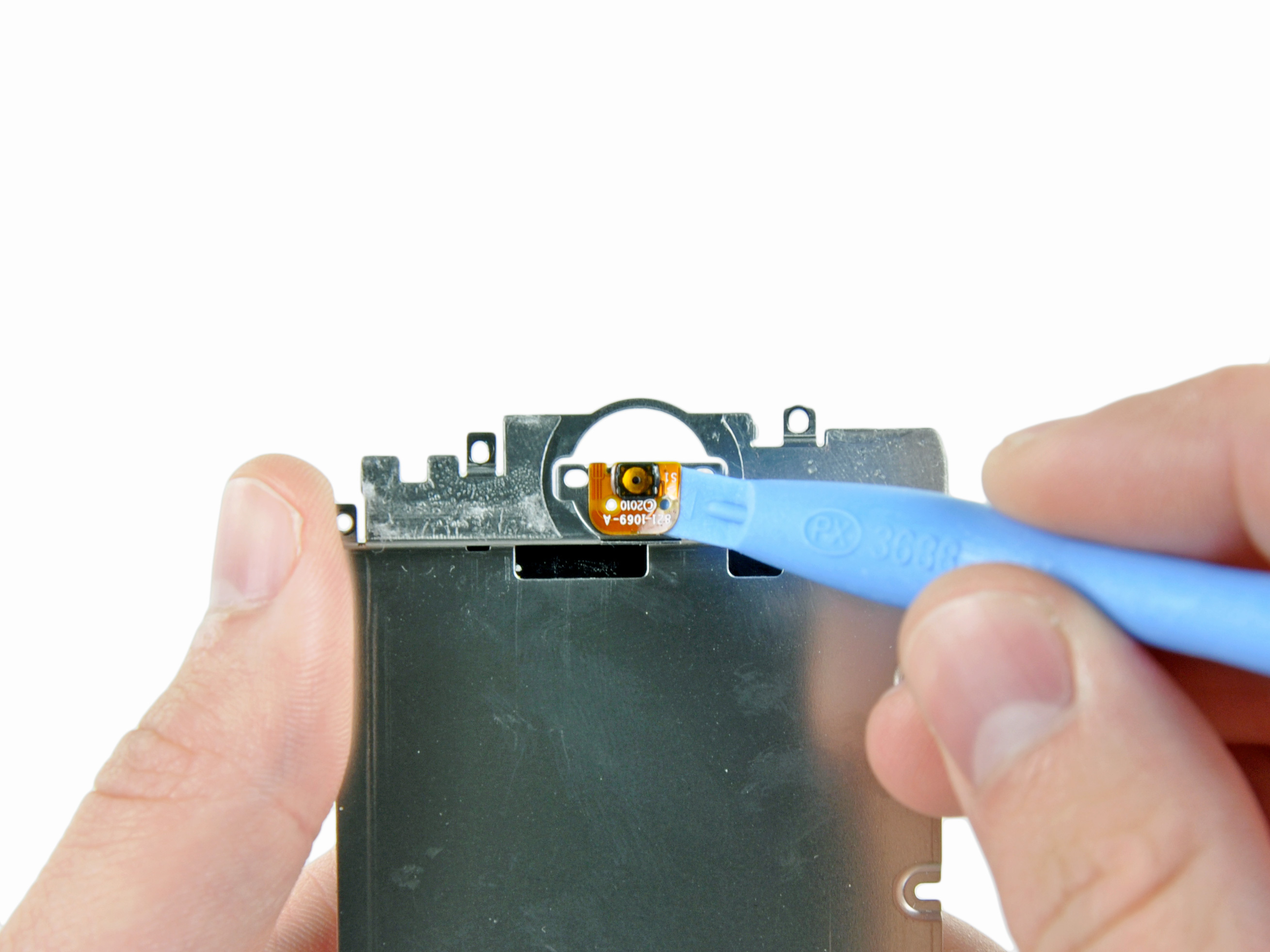

  9. iPod Touch 4th Generation Home Button Ribbon Cable Replacement, Home Button Ribbon Cable: step 9, image 1 of 2 iPod Touch 4th Generation Home Button Ribbon Cable Replacement, Home Button Ribbon Cable: step 9, image 2 of 2
    • Peel the home button ribbon cable off the front side of the steel mid plane using a plastic opening tool.
    • In the same manner, peel the home button ribbon cable from the back side of the steel mid plane.
    • Remove the home button ribbon cable from the steel mid plane assembly.
